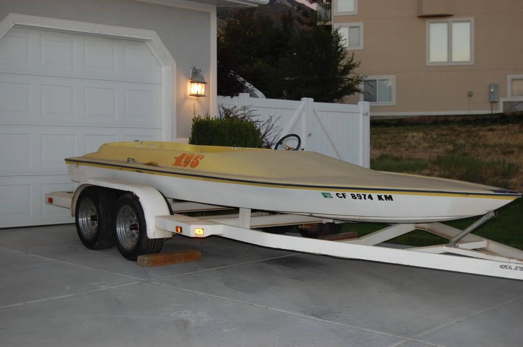

Here's my project to show you how durable Gel Coat is.
I started with a boat that was painted, stripped it down to to the Gel Coat, wet sanded, and polished.
Wow, that was a nice before and after!! When you say Pledge are you referring to the paste floor wax? Or?? I only ask because a local detailer here uses the Zep high traffic floor wax on anything thats oxidized. I've removed and corrected a recent boat he did. He mentioned he also uses Pledge paste wax for oxidized RV'S boats etc. I'm sure Cobia has been corrected but if you look for gel coat chips it will give you a good idea on thickness of gel coat.
