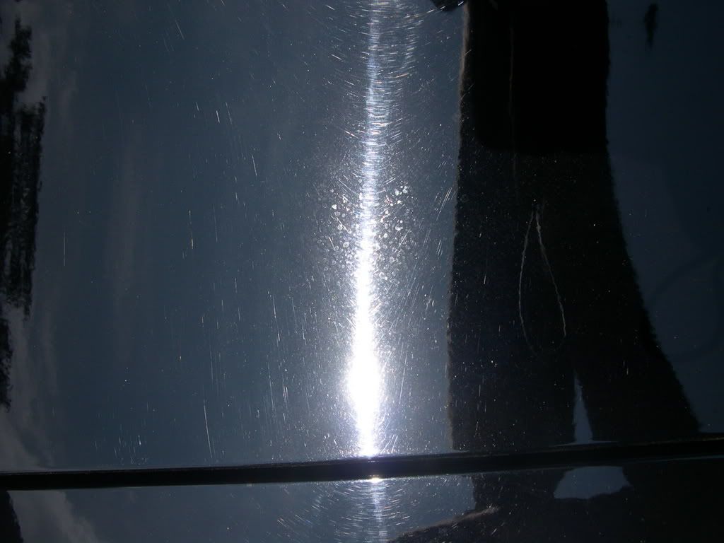

Im still alive! :D sorry for not getting back to you guys. Im still getting a PC setup, might take a week or two now due to I want to get what i need in one order and do it right. and this stuff costs $$$$ :D
Should a PC with a pretty good operator and good pad/polish combo be able to take these out almost completely?
