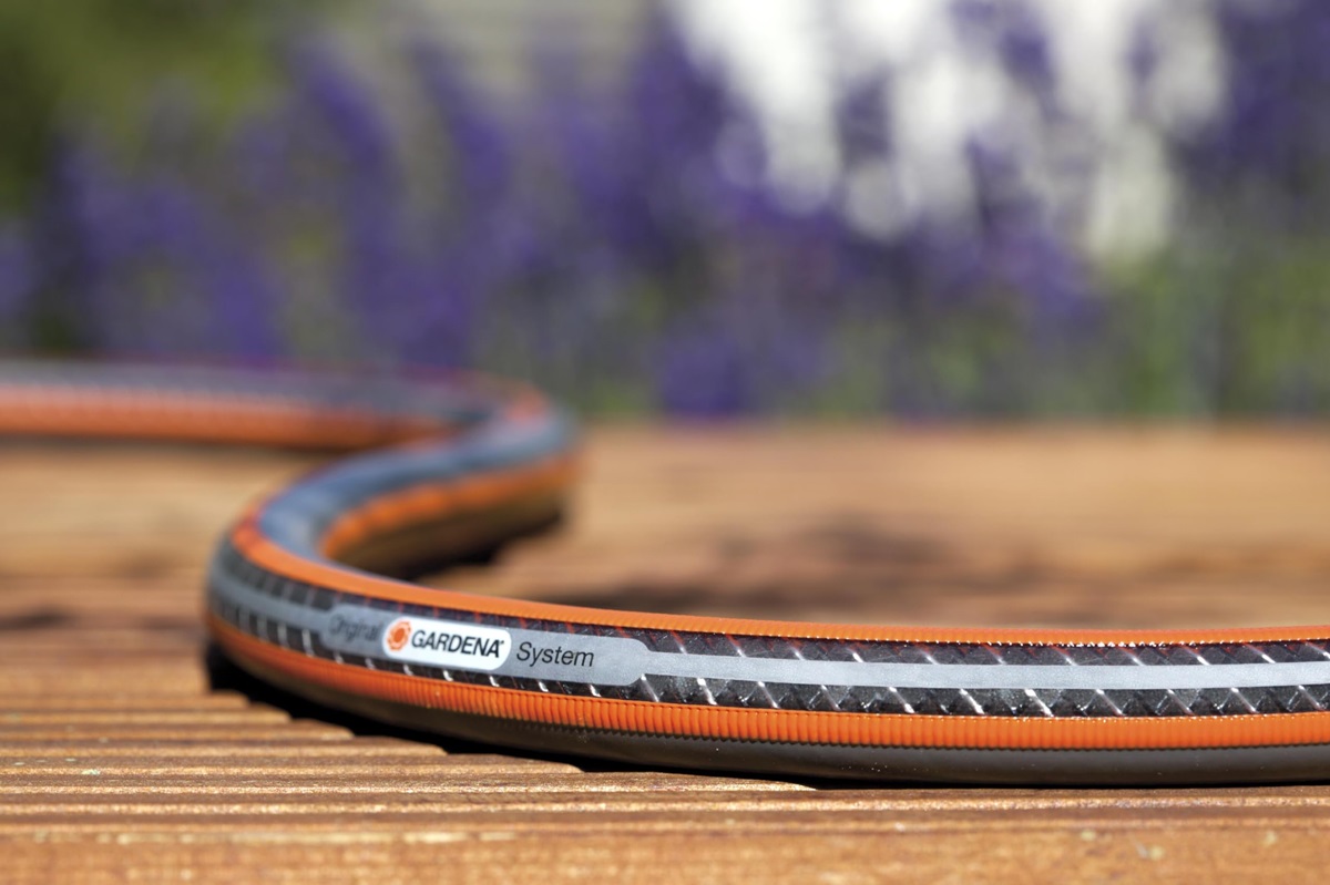

Again, the best ones come from Gardena, and they are plastic. Sounds like a backward step, but trust me, they work the best, and I've tried them all.
So there you go, I told you I was a hose freak.

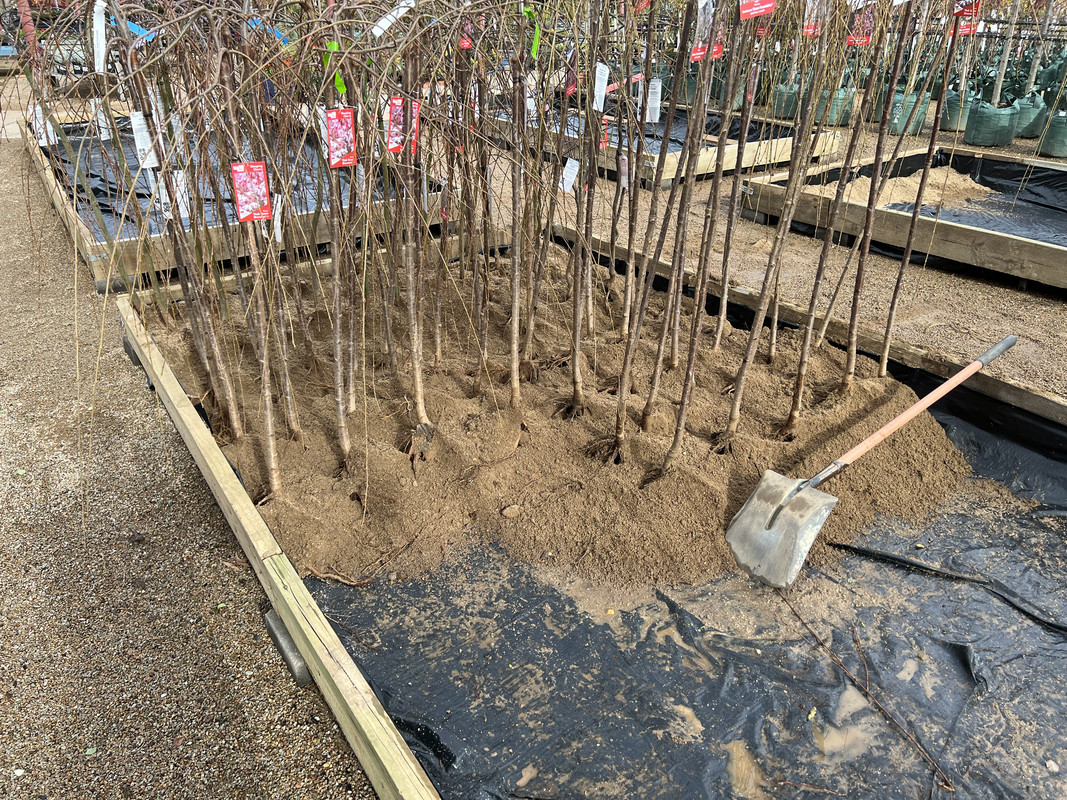

Here's a pic of a tree I got this year. Probably grown in a liner for way too long, then put into a #1 and root bound already.....and upsized again in a #3 but it started with poor root developement. More than a few circulars, 2 areas where they hit each other and fused together and created that gnarly knob.
If I buy a smaller plant, it's easy to get the roots growing correctly since it's a younger plant. For all plant media I get, I will bare root wash and do a massive root correction before planting. Depending on how much I lop off, I may put them back into a very large planter to hold for a season to recover, and actually do another a second round of root correction after it has *recovered* from the prior year and then plant it.
Pic #2. It's a HTG cultivar
I actually killed a large one I had so this pic was its replacement. I did not want to touch anything since I killed the 1st one
I left it alone for 2 seasons, dug it out, with the goal to do a root correction. Planted too deep from the grower those secondary roots just grew too advantageously . I ended doing a 1st pass correction and cutting those off, going to let it recover for a season, then cut the dieback back to the leader. Still haven't done any root correction below the flare since I lopped off 4-5 large roots as such
