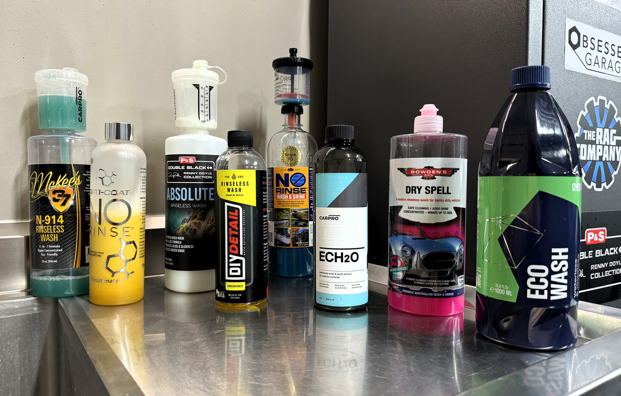

So how would a basic, cheap and very safe product like a rinse-less wash perform as a glass cleaner? After all, most of them on the market suggest glass cleaning as a potential use. That’s what I aim to find out.
The Test -
The following test was spread across a few weeks, multiple cars and multiple ambient temperatures. Some rinse-less products provide suggested dilution ratios for glass, others don’t so I had to pick an appropriate number. I also did not buy any specific product for this test, rather I used what was already on hand. Some of these products are surfactant based, some polymer based, some with Si02. Each was mixed using distilled water for consistency, and each used with my preferred TRC Dry Me A River glass towels. The control product was my go-to, never-fail…………..Stoner’s Invisible Glass in liquid form (there is an aerosol version as well. At the end, I calculated a per 500ml cost, which includes the product mixed with demineralized water purchased at $5.49 per 5-litre bottle.
Here are my findings –

Cost Considerations -
Probably the most notable aspect of this test was the cost equation. I knew these products would be cheaper than a traditional glass cleaner, I just didn’t expect the gap to be as pronounced as it turned out to be. The following numbers are an average across the 10 products tested, which includes demineralized water -
Average Product Used – 3.18 ml
Average Product Cost Per Bottle Of Concentrate – $0.11c per ml
Average Product Cost Per Dilution - $0.17c per ml
Average Water Used – 496 ml
Average Water Cost Per ml - $0.0011c
Average Water Cost Per Dilution – $0.55c per ml
Total Average Cost - $0.67c per 500ml

The Standouts -
Carpro ECH20 –
As mentioned earlier, I had expected this to struggle on glass, but I came away very impressed. At the usual water-less/quick detailer rate, it may well have streaked. But at 100:1, ECH20 was nothing but delightful. As on paint, you are left with a lovely slick surface.
Gyeon Eco Wash – In reality, what I said about ECH20 applies here too. However, I feel like this product is worth highlighting as it appears to be slept on. It's way slicker than most products mentioned here, be that on paint or glass. It’s super easy to work with and smells lovely too. While many products listed here I wouldn’t buy again, Eco Wash has earnt my respect for repeat purchases.
DIY Detail – Considering how the traditional polymer and surfactant-based rinse-less products struggled on test, I wasn’t expecting much from DIY. And yet, it became the biggest surprise here. The question I now have is, does the performance of the newer v2 version match the original tested here?
The Winner -
Koch Chemie RRW –
This was my favourite on test. Actually, I think it performed better than the control product, Invisible Glass. I just love how easily it flashes away and the slick surface it creates. A surprise winner.
