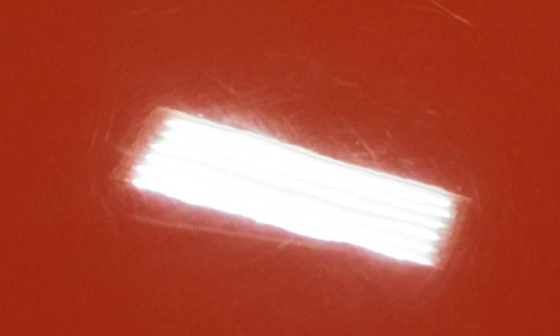

When I shine a light sideways on the paint the clear looks a little cloudy. I hit it with some blackfire one step on orange force pad which didn't help much. (Could be tinted clear, I am just not sure.)
Could this be build up of powerlock, beadmaker and onrww from the last 18 months or so?
Could be - tinted clears are a different kind of animal.
