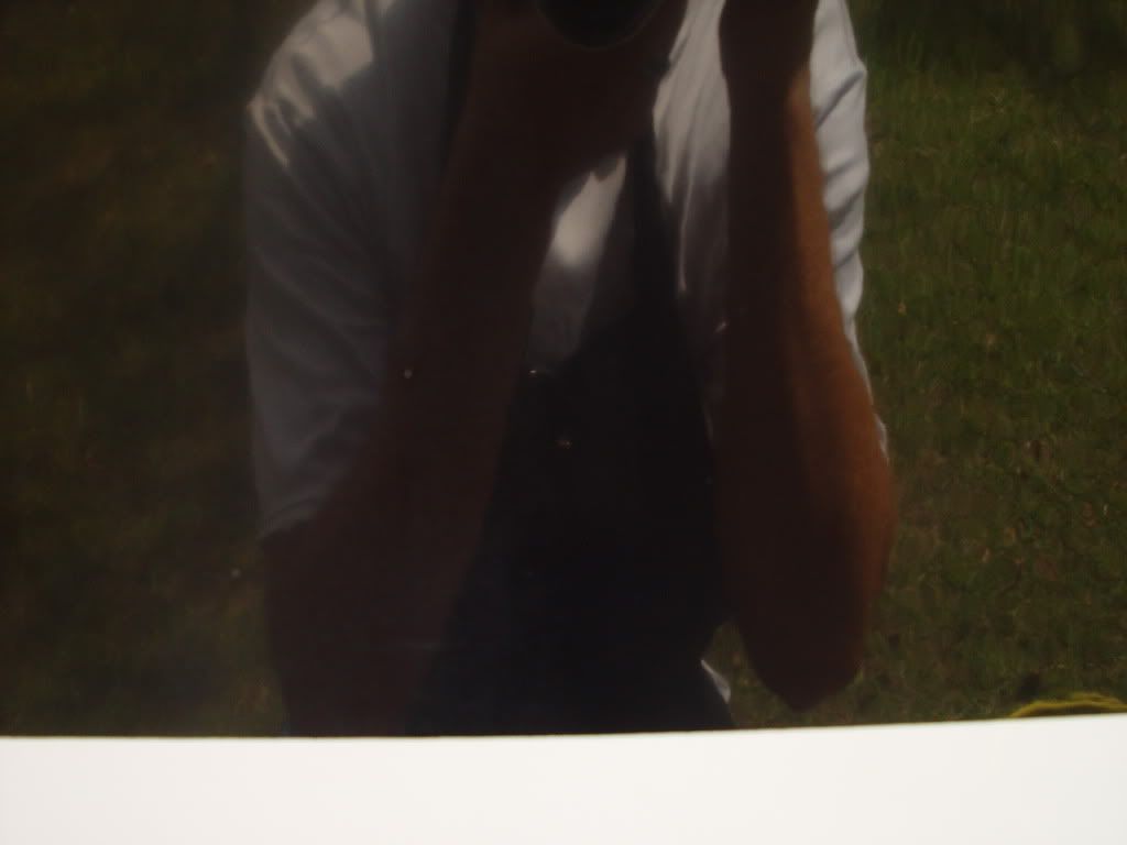

Heres a pic of the d/a system 50/50 no tape line but you should be able to look at my arms and see the difference in clarity

Hey Perfections, what products did you use on that boat? It looks really good.
On the black part of the sides I used Meg's 6" mf d/a cutting disc and compound, on the white part of the sides I used Meg's marine 1 step compound + rotary with a Meg's burgandy disc, on the hull used Meg's mf d/a cutting disc with Collinite #870 as a one step, LSP was Collinite #925 applied with Meg's mf d/a finishing disc, Im just trying the d/a system out on as many surfaces as I can, personally I felt it was a little slower then my normal approach with a rotary, but the end result was very nice and thats really what Im after :)
