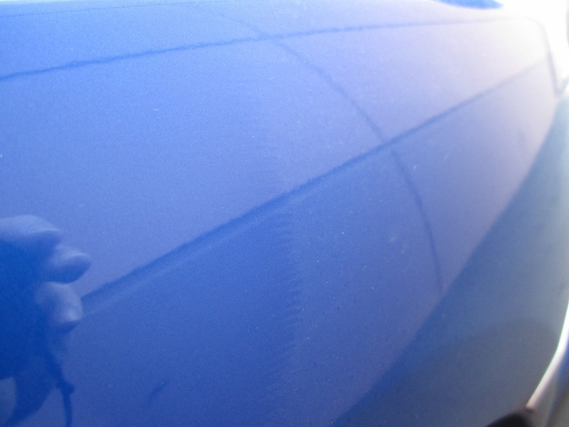

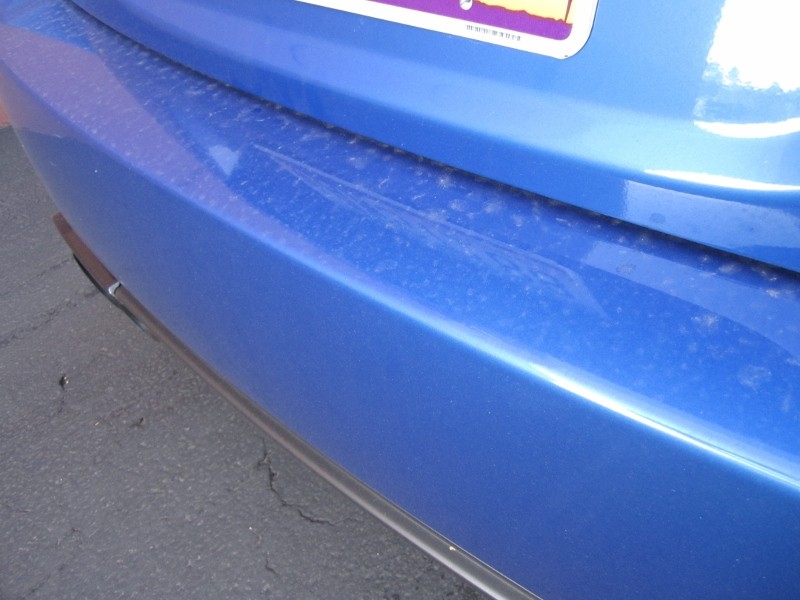

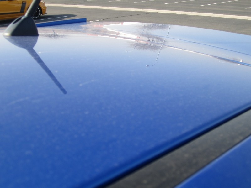

I can say I've been happy with the results from it. I can't remember where I had put these up before, but this was a junkyard bumper I cleaned up for an A4.
Before: View attachment 50208
After Complete Compound w/ Fast Finishing Pad: View attachment 50209
Followed by One Step Sealant on Orange Foam Pad: View attachment 50210
Wasn't perfect, but it was just a quick clean up so it matched the rest of the car. I've got some of the BOSS creams to try now, so I'm excited to see the difference. Complete Compound will still have a spot in the arsenal as a hand polish for tight areas since it sounds like the BOSS creams are more machine focused.
