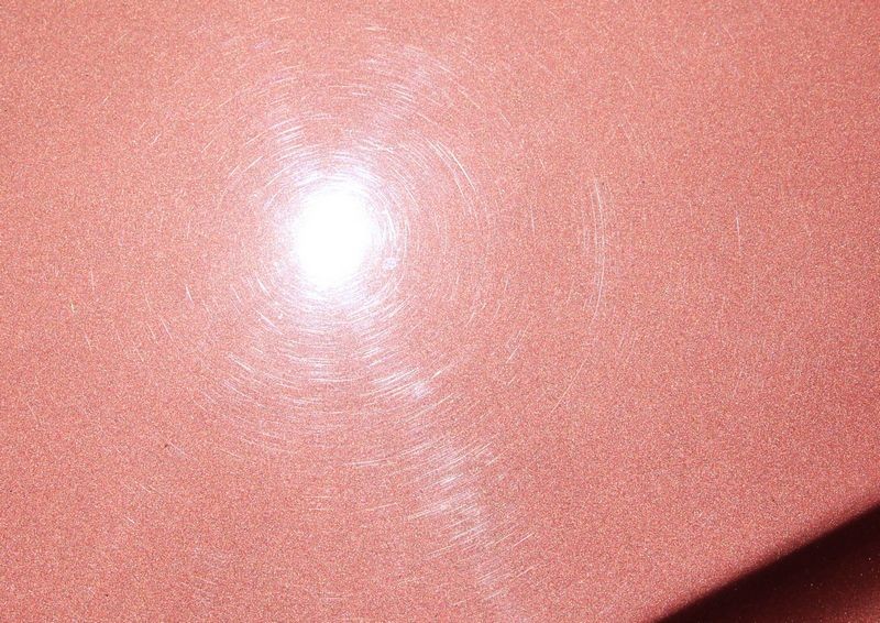

First - After washing and drying your car, look at the paint in bright overhead sun to inspect for swirls and scratches. If you see swirls and scratches, then you're going to need the orange pad. I'm pretty sure Griot's refers to this as a "polishing" pad.

If it were me and I was buffing out a 2015 Honda Civic with light swirls, for the first machine step I would want to have 6 pads minimum.
You can buff out sections so much faster with a clean dry pad than trying to limp along with a wet soggy pad.

this is the car as it stands now more or less. I live in a rural environment so I know any buffing etc is going to be a royal pain not getting contaminants on the surface. I probably will just the griots one step the first time then follow up with some type of protectant wax etc in a few months. Either way I wanted something capable of more correcting if I ever needed it.
