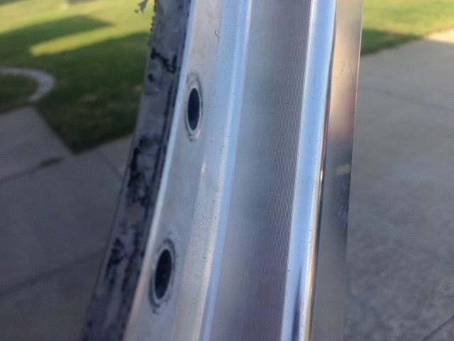

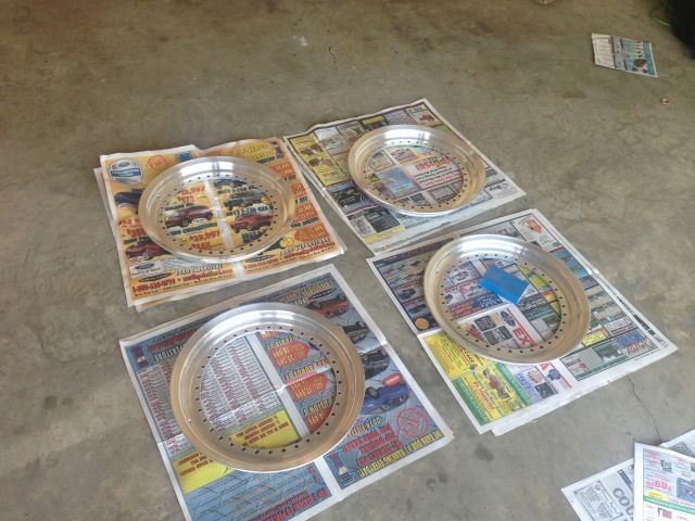

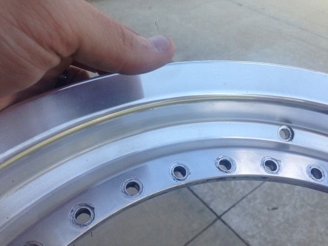

These are the Lips I am polishing now. They are Volk Racing and were cleared. So I had to strip them to get to the metal.
They have a machine finish to them, me and the customer hate that look. We much prefer the mirror finish.
What I am using to polish them.
Aircraft stripper
Misc paint brushes
600 grit
800 grit
1000 grit
1500 grit
2500 grit
Metal compound
Cloth polishing wheel
Mothers Aluminum polish
Then I'm going to attempt to use DP wheel coating and see if it will stick. I am doubtful, but it's worth a shot.
