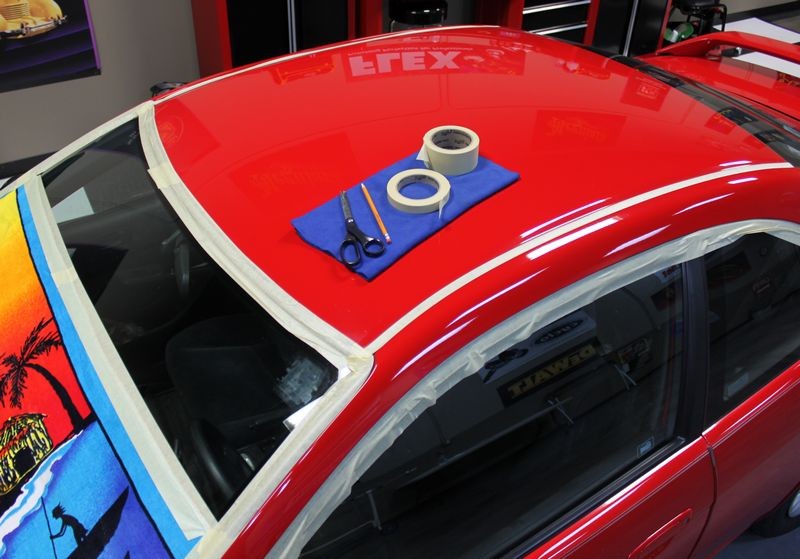

It's the same reason why you can remove sanding marks by hand next to raised body lines or edges but you certainly wouldn't want to remove all the sanding marks over an entire car by hand as it would tear up your arm.
Removing sanding marks can be thought of as the same type of thing you would do if you were removing water spots or normal swirls and scratches...
The Rule of Thumb
Here's a shot of removing sanding marks by hand. My hand is blurry in this picture because it's moving at the speed of light.
Removing Scratches By Hand
I induced straight line scratches by hand, then ran a tape line across the paint, then worked the scratches out by hand using Wolfgang Total Swirl Remover, (4 well worked applications), followed by Wolfgang Finishing Glaze, (2 gentle applications), then striped with 17% IPA
