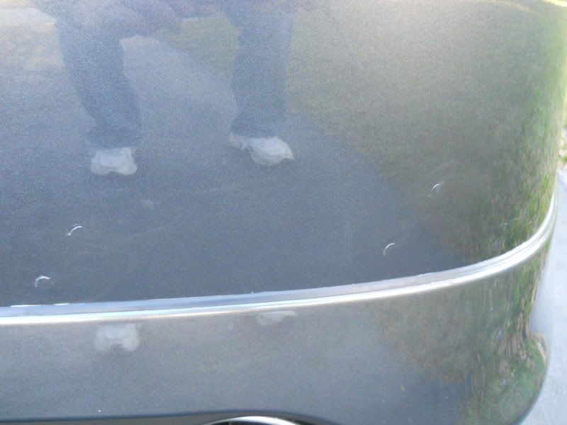

Here is a picture of the 4 screw marks in my bumper. Any Ideas on how to fix this would be appreciated !!

I live in Mass, yes my finger nail can go into the scratches, I tried a2000 grit wet sand and some 3m buffing compund with my porter cable 7424XP it improved a litte bit and this picture was taken after the wet sand and buff, I am thinking that I may have to go to a bumper scuff repair place.

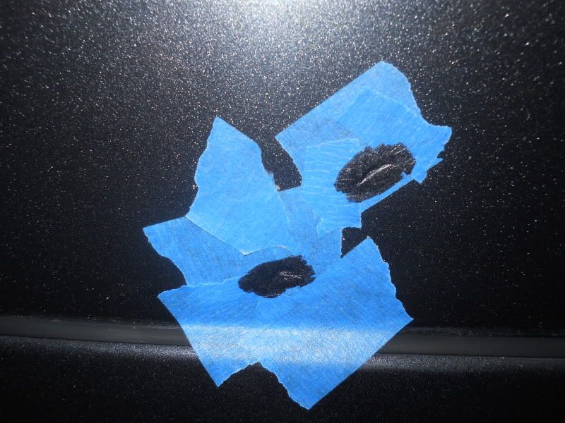

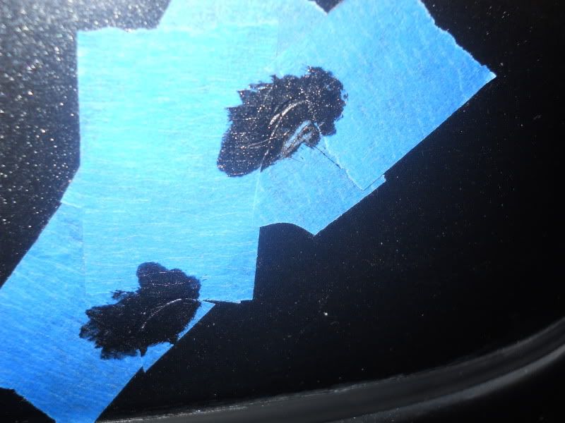

Here is the progress that I have made so far using rich's technique.
I cut painters tape to go around the scratches and fill the scratches with the paint, I have done several coats today and then I'll let them dry 24 hours and do a wetsand and buff..so far things look to be going well..thanks for everyones advice its been a great help. Any opinions/ coments welcome
Glenn
Why does the mark look white after using touch up paint and why are you taping around the scratch?
I also have a question for you Glenn:Why does the effected area with the four screw marks in this photo, {from an earlier post of yours}, look...."A Whiter Shade of Pale" ~ [Procul Harem (circa 1967)].....
.....Than these photos??

Rsurfer, that must be the reflection from the camera, I put tape around the scratches so the paint would not run and stay in the divit of the scratch and I be able to level it off by filling the divit with paint.
@Bob..the paint got pushed into the scratch/ divit , maybe because they use the flex agent in the paint, another words , when the person whos screws that hit my bumper left the indentations in the bumper , the paint did not come off but got pushed in also it must be the times of day that I took the pictures.
Glenn
