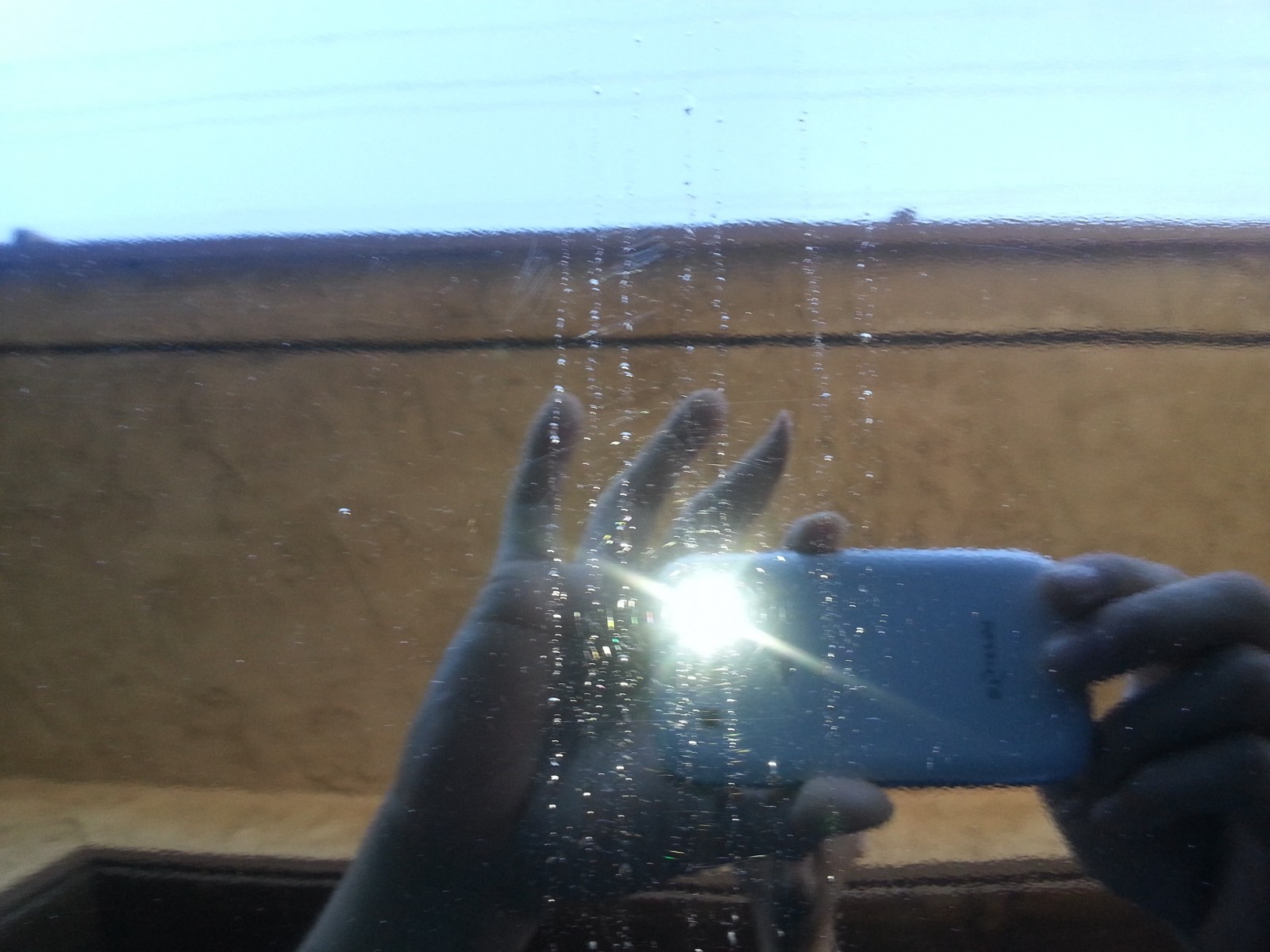

Thank You! Sorry if I confused you. The initial wash was consisted of foaming flowed by a 2 bucket wash and speed clay. The car was so oxidized and swirled that it still looked dirty . The picture of the side of the truck bed with water rolling down, no beading, was after the first wash and you can see it looked like I did nothing to the paint. The second picture with beading was after I finished the HD Speed process.
