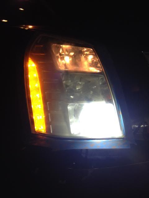

600, 400, 320, yes, have them all I say just in case. The last pair of headlights I tried fixing on a Caddy CTS a few weeks back, I began to believe I needed my Milwaukee Angle Grinder, that's how bad they were.
Plus, somebody coated one with something that was worse to remove than the damage. I was breaking my butt with the coarsest paper being 1000.

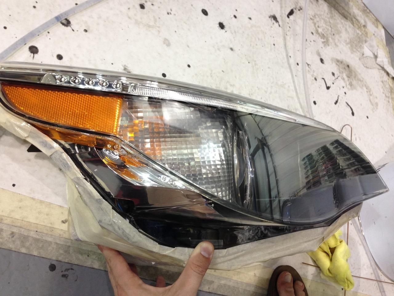

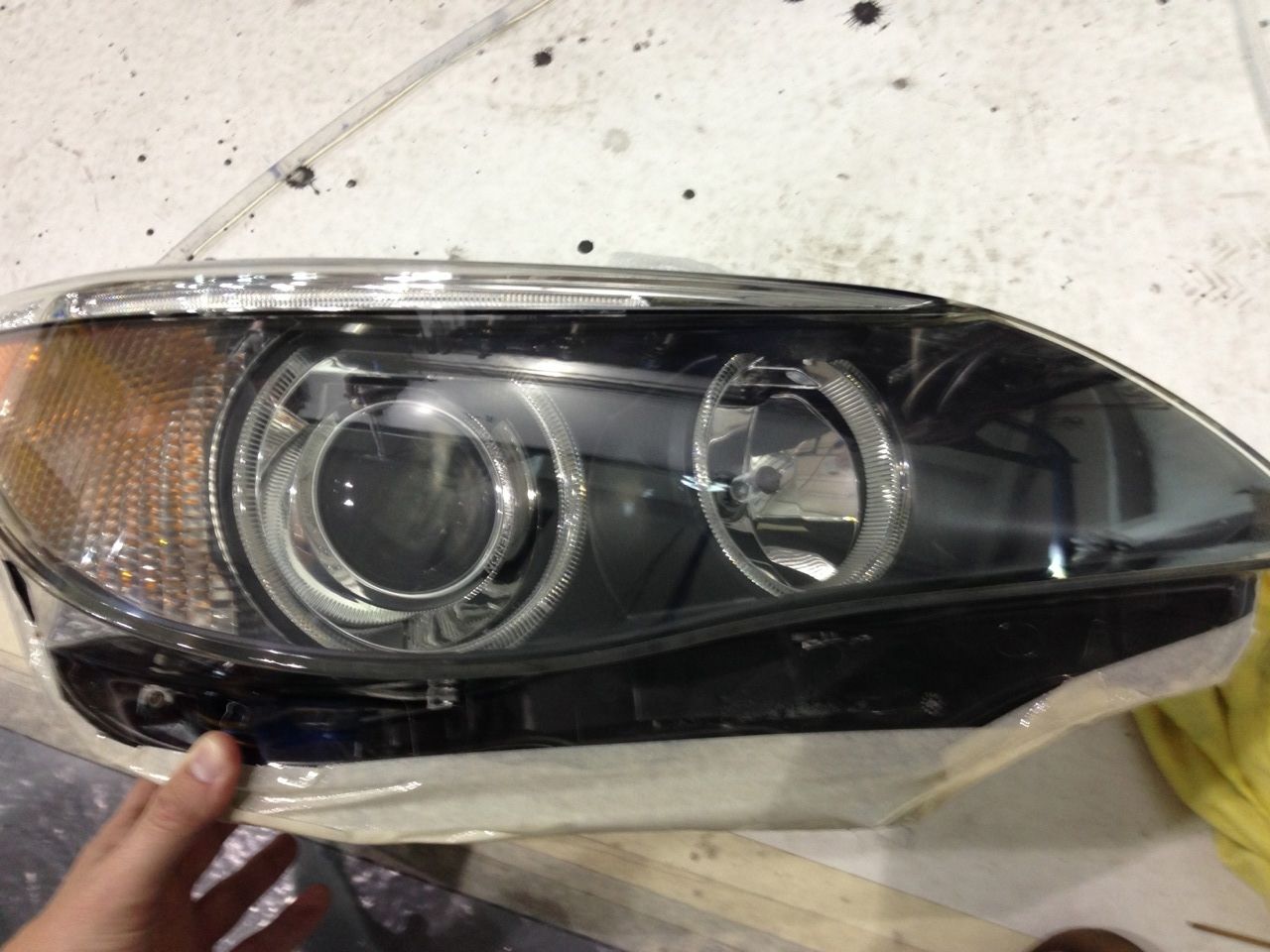

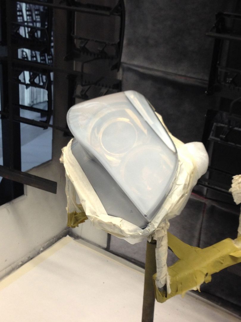

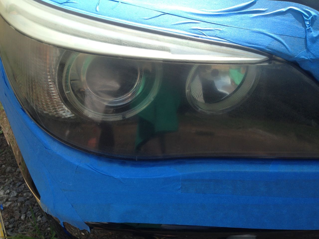

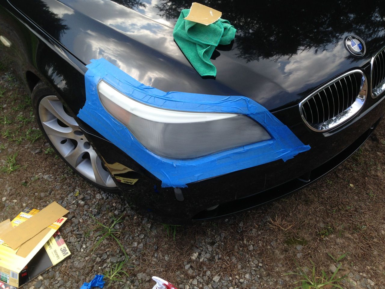

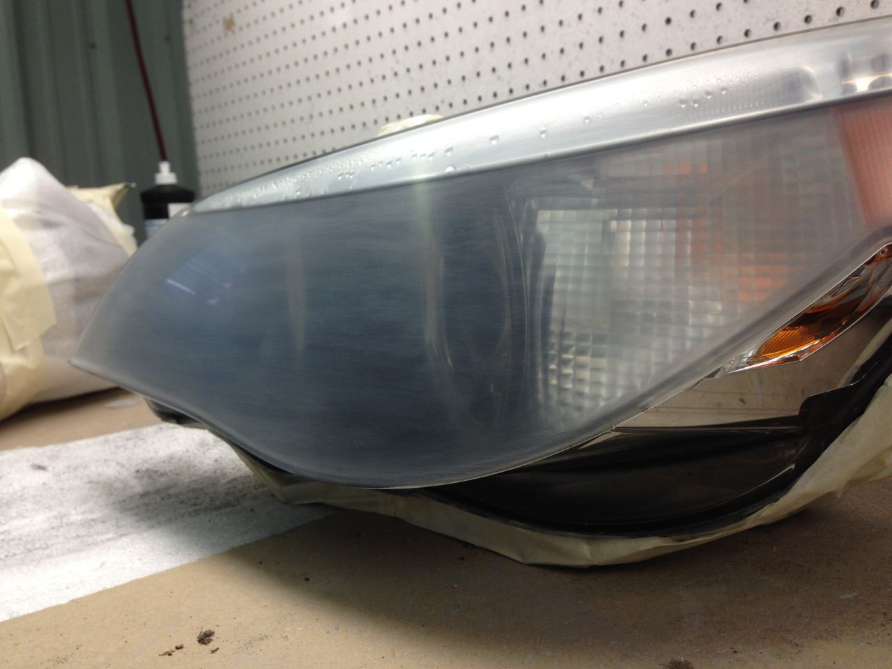

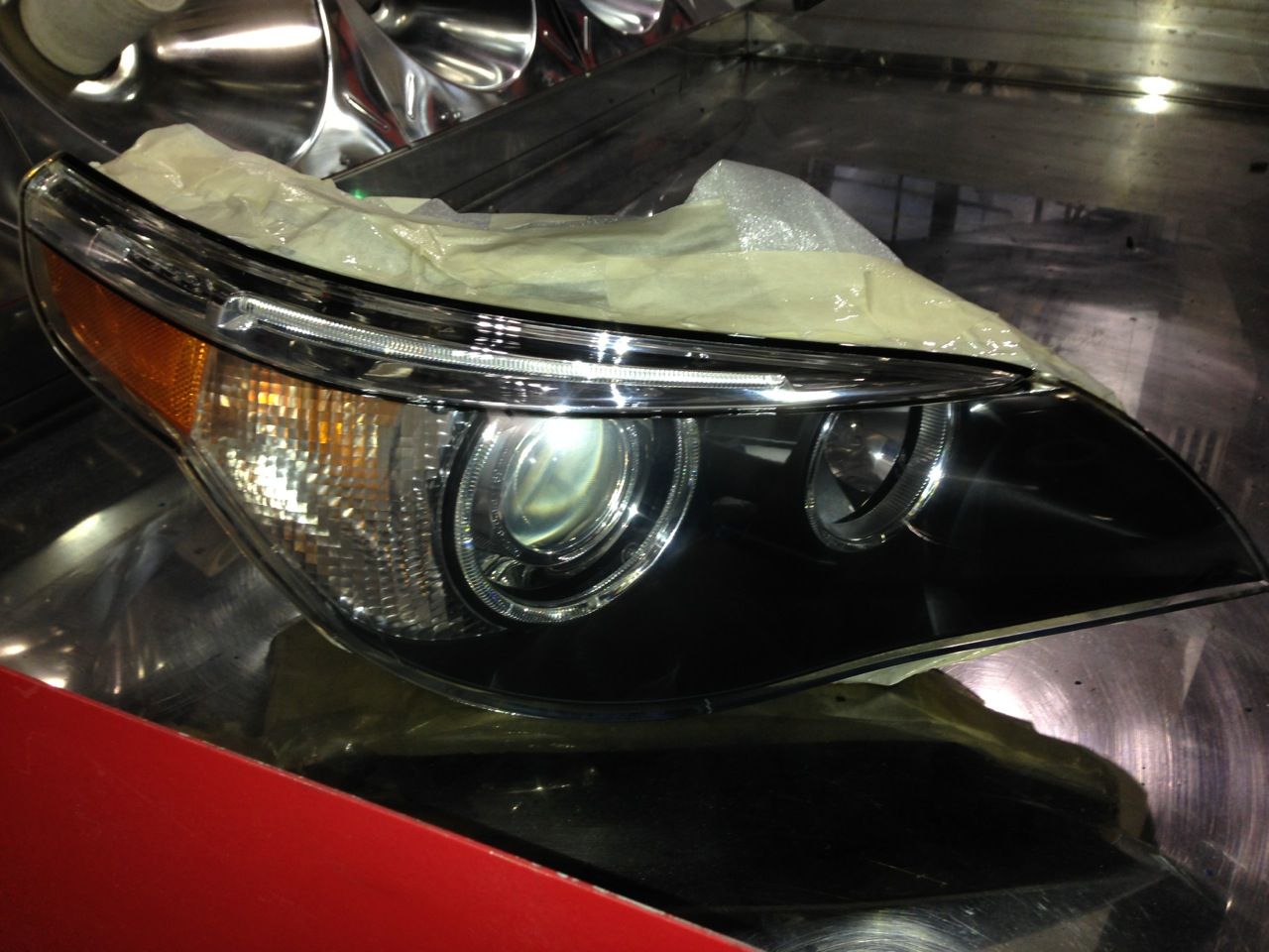

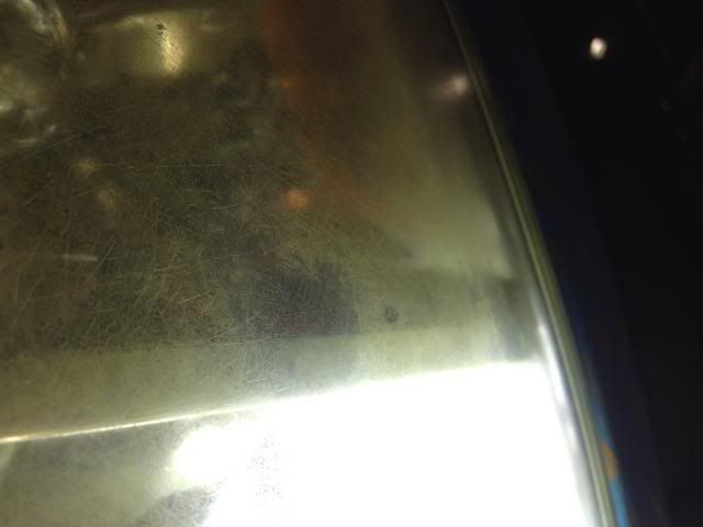

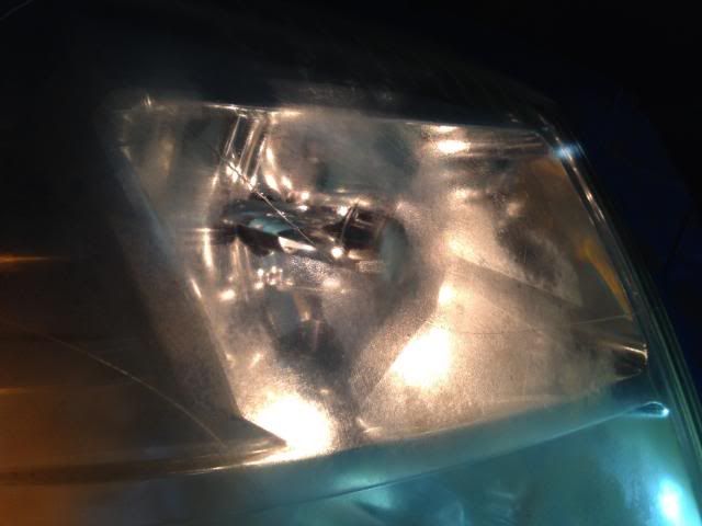

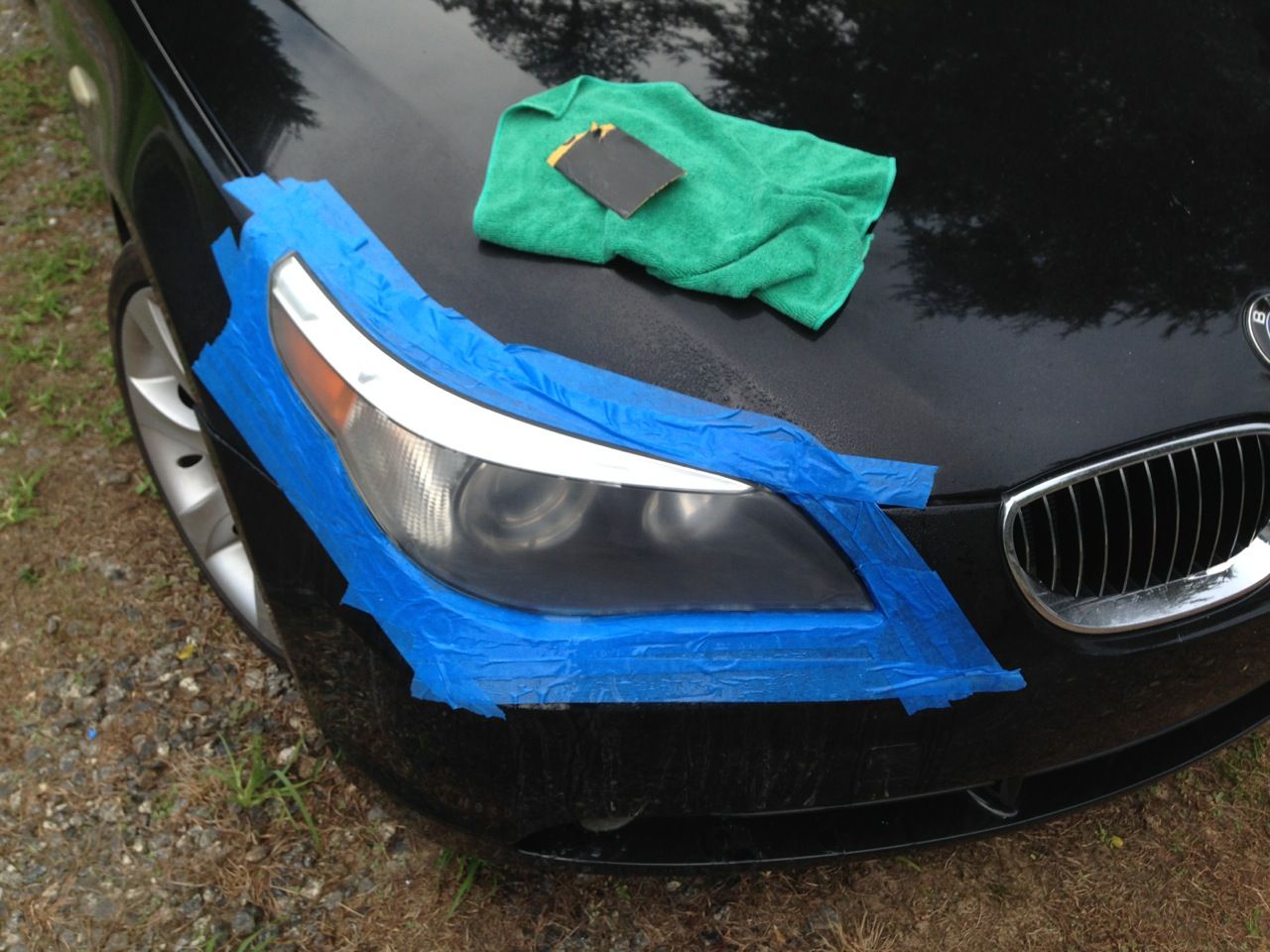

I've used a high quality exterior automotive clear coat for coating headlights in the past. So far both sets of headlights I've done this way (sanding starting at about 240 and going up to about 1000) then painting it with clear. You do NOT have to make them perfectly slick prior to painting them with clear. The clear will fill the scratches that are left and leave basically a perfect surface. Here are some pictures from the BMW ones I did:
Before:
After:
This was 200 grit:
This is as smooth as I got them before painting:
Just after paint was applied..
and, ta-da, after drying! They came out beautiful. I wet sanded a few dust specks and buffed them back to clear.. I've done this to two sets now and it has worked great. Corvette is up next!

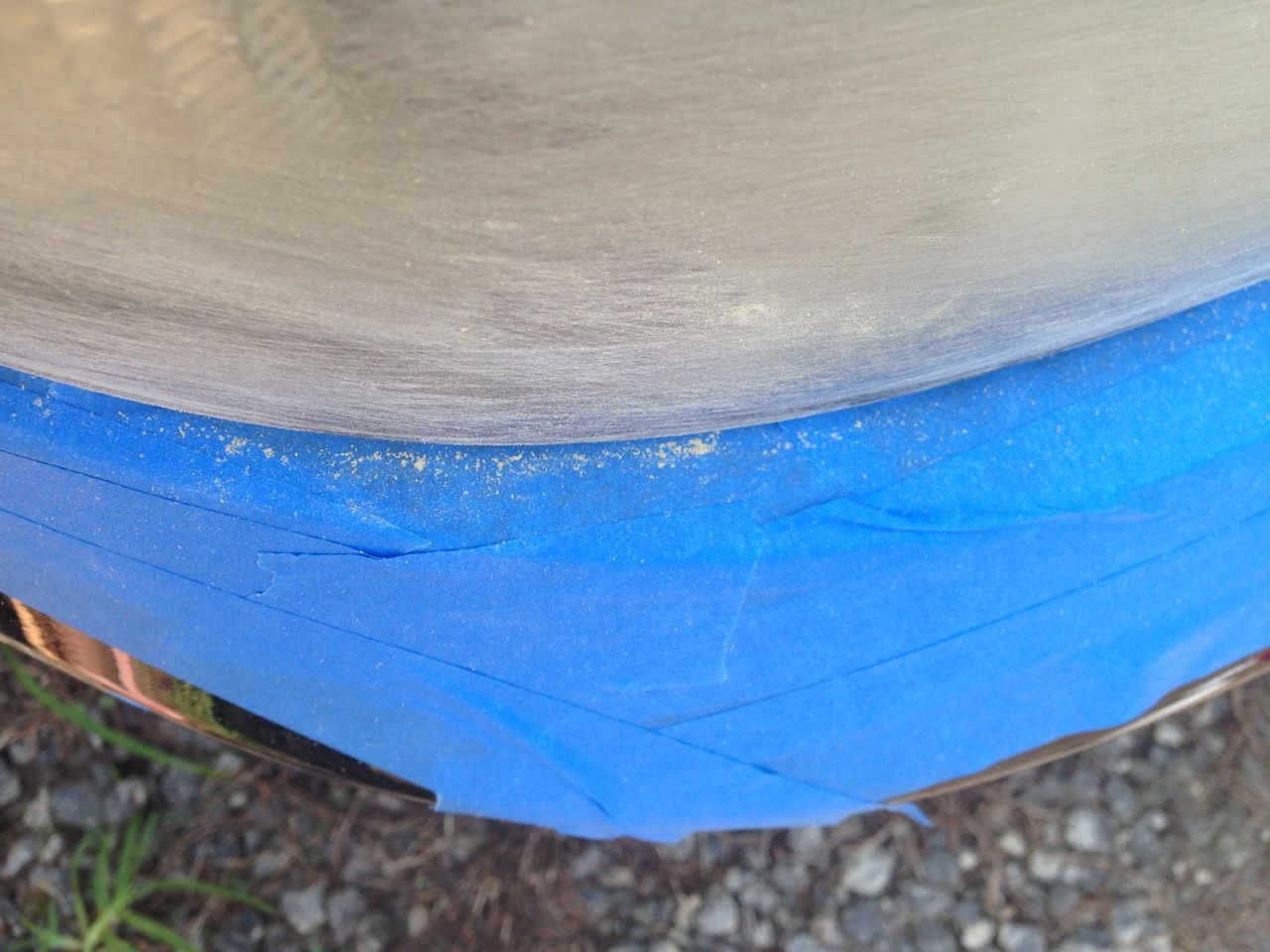

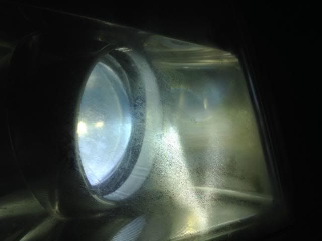

This is probably the worst set of headlights I've restored.
I had to start w/ 320 grit to get any sort of defect removal. Then 600, 800, 1500 and 3000. LC Tangerine hydro pad w/ D300/M105. Wipe down w/ CarPro Eraser then coated w/ CQuartz DLUX.
Personally I always damp sand using 3 inch Meg's Unigrit sandpaper w/ an interface pad on the PC. I've found using this combination gives very uniform sanding marks that are easier to remove than if you hand sand it.
