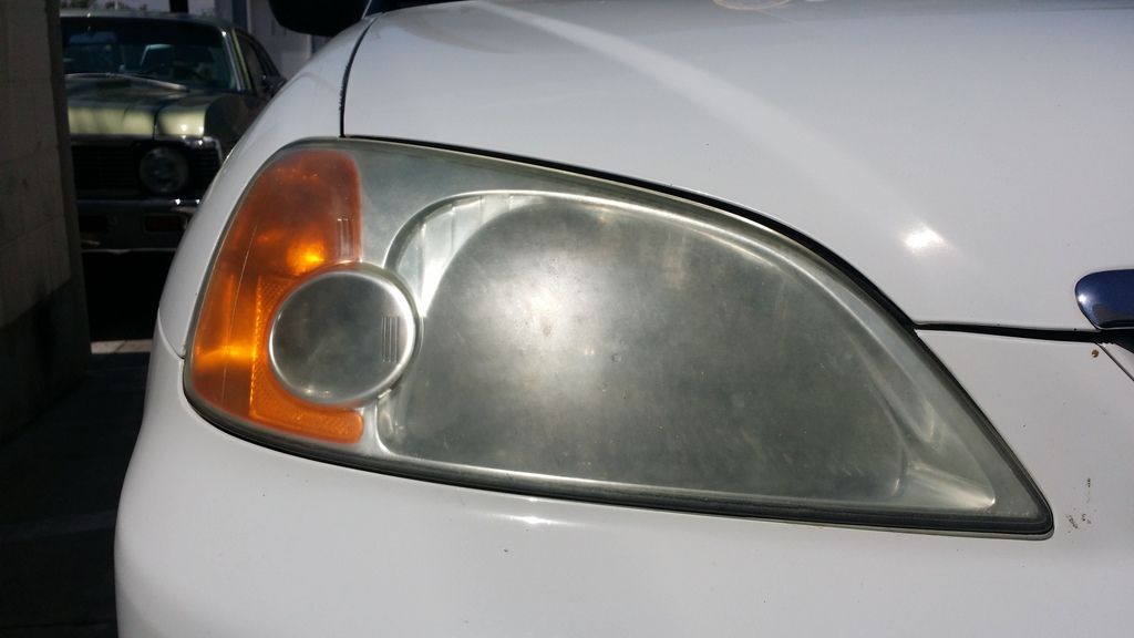

These were bad! And my first go and doing preety good i'd say myself.

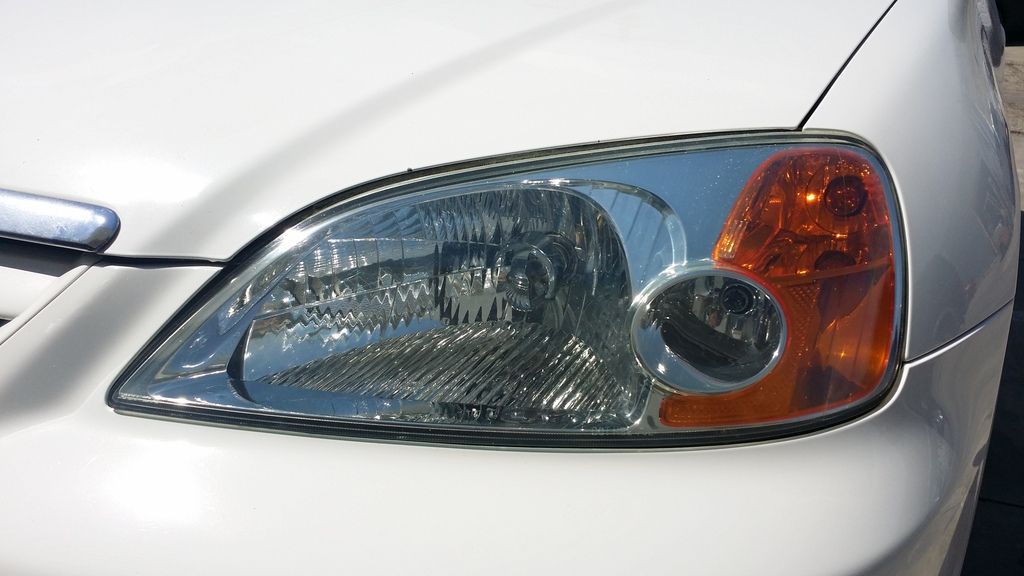

Process: Wetsand, 1500, 2000, 3000, and then compound 105 and machine polish 3m with rotary.
Any thoughts or comments to improve or to do would be appreciated.
Before:
After:

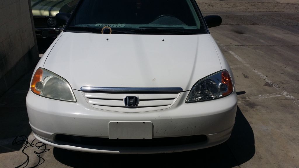

During:

The before picture is of the passenger side and the after is of the drivers side. Are you sure you didn't just install a new headlight on the drivers side? :joking:
Nice work!
Nice work!
Lol thanks, i forgot that when i was taking pictures lol next time i will get same side before/after haha.
Paint is one thing but you can't beat standing back and seeing one headlight trashed and one headlight transformed back to new!! Good job man
