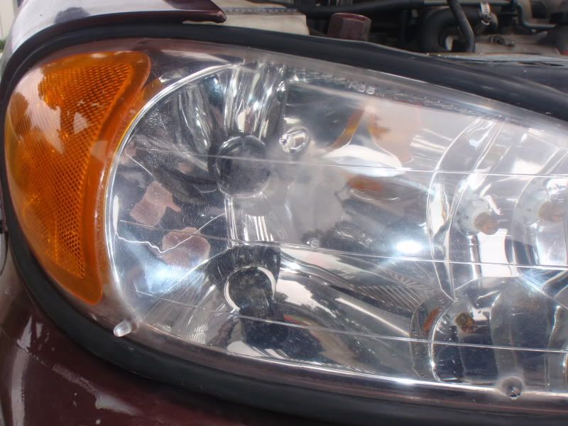

A client dropped off a '99 Pontiac AM with really bad headlights. So I go in to wet sand with a sanding block with, 1,000, 1,500, 2,000, 3,000. Then ultimate compound on a terry cloth, the plastic X on a fine polish wool with a corded drill. My DA is broken and waiting for UPS.

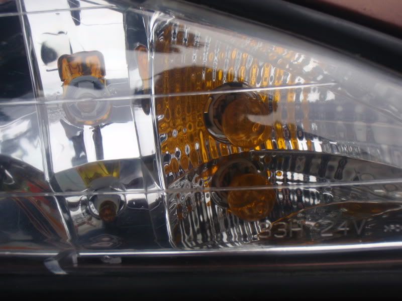

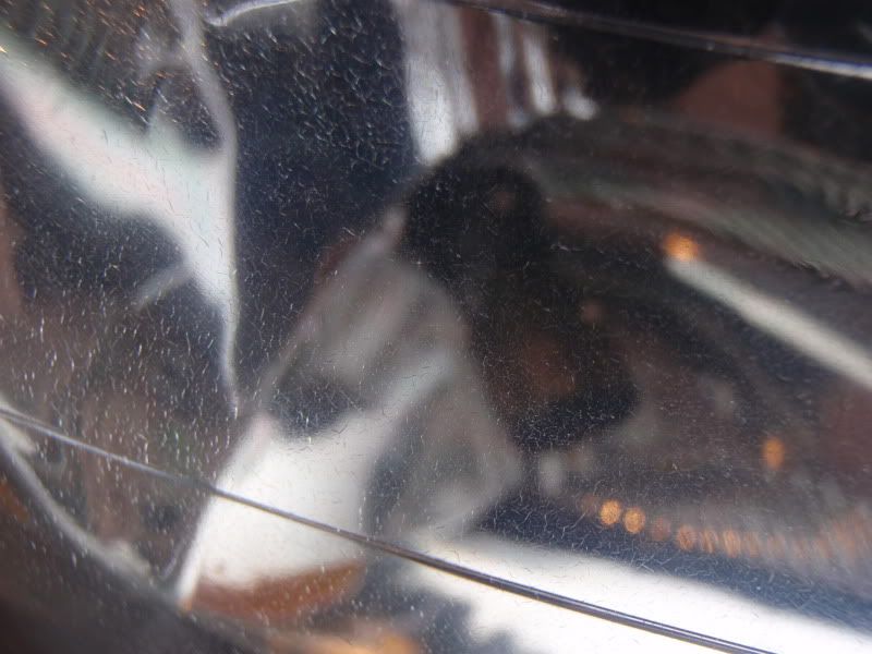

Question. there are these small cracks in the headlight lens. Can I remove these or are they to deep? I was thinking of trying 800, then 600, or maybe drop to 400 grit to try and get them out.
Any advice?

Looks like a cross between stress cracks/webbing and etching. If it is stress related then it is most likely on the inside.
You can actually start by using a 180 grit or a 320. I don't wet sand because it is too messy, but I do take a paper towel and simply dampen it to wipe the dust odd in between grits. I also use a polisher "Griot's 3" Orbital" and then sand by hand when you get close to the edges.
You can finish with a 3200 grit and then some fine polishing compound, don't forget to seal it with a UV inhitor.
