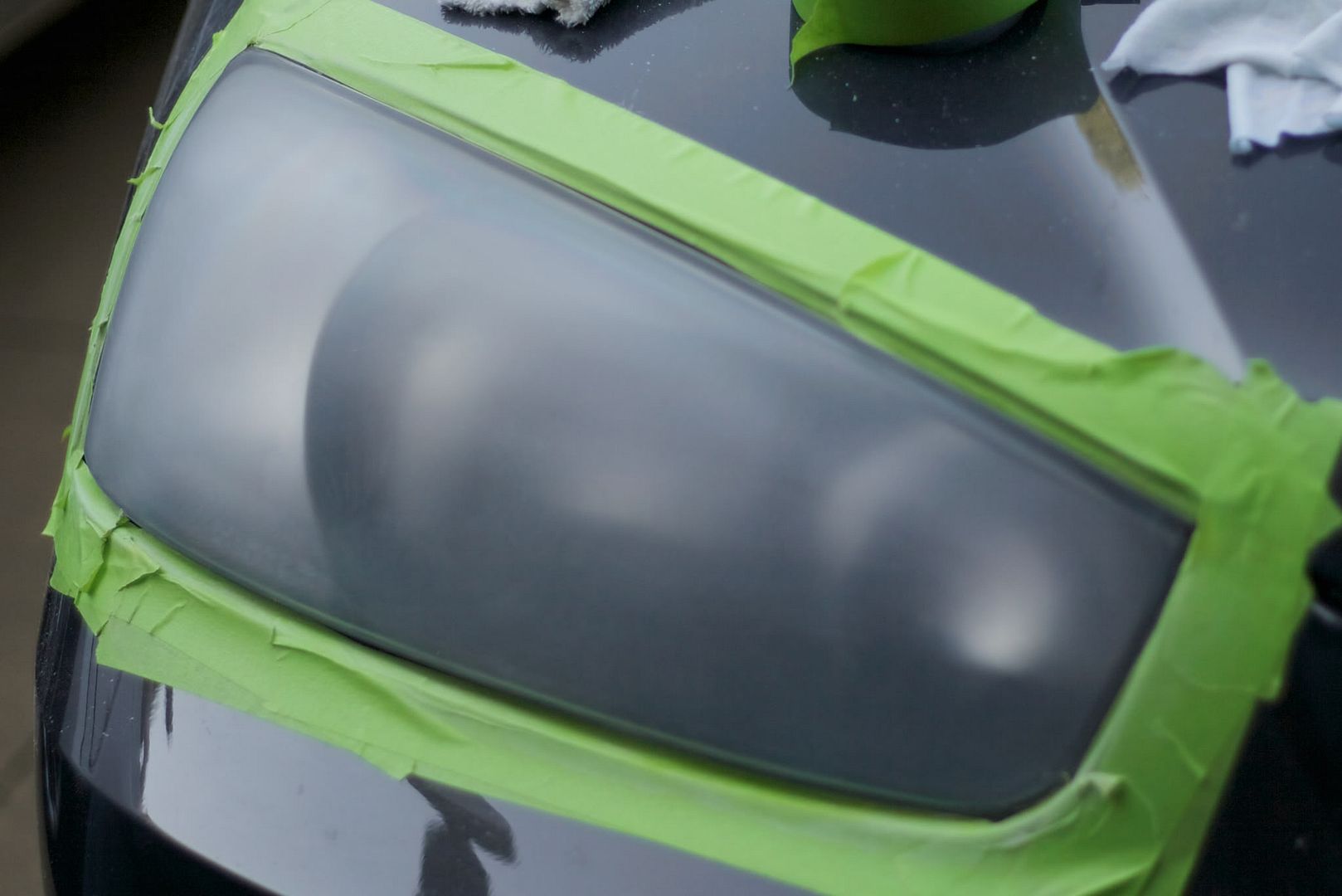

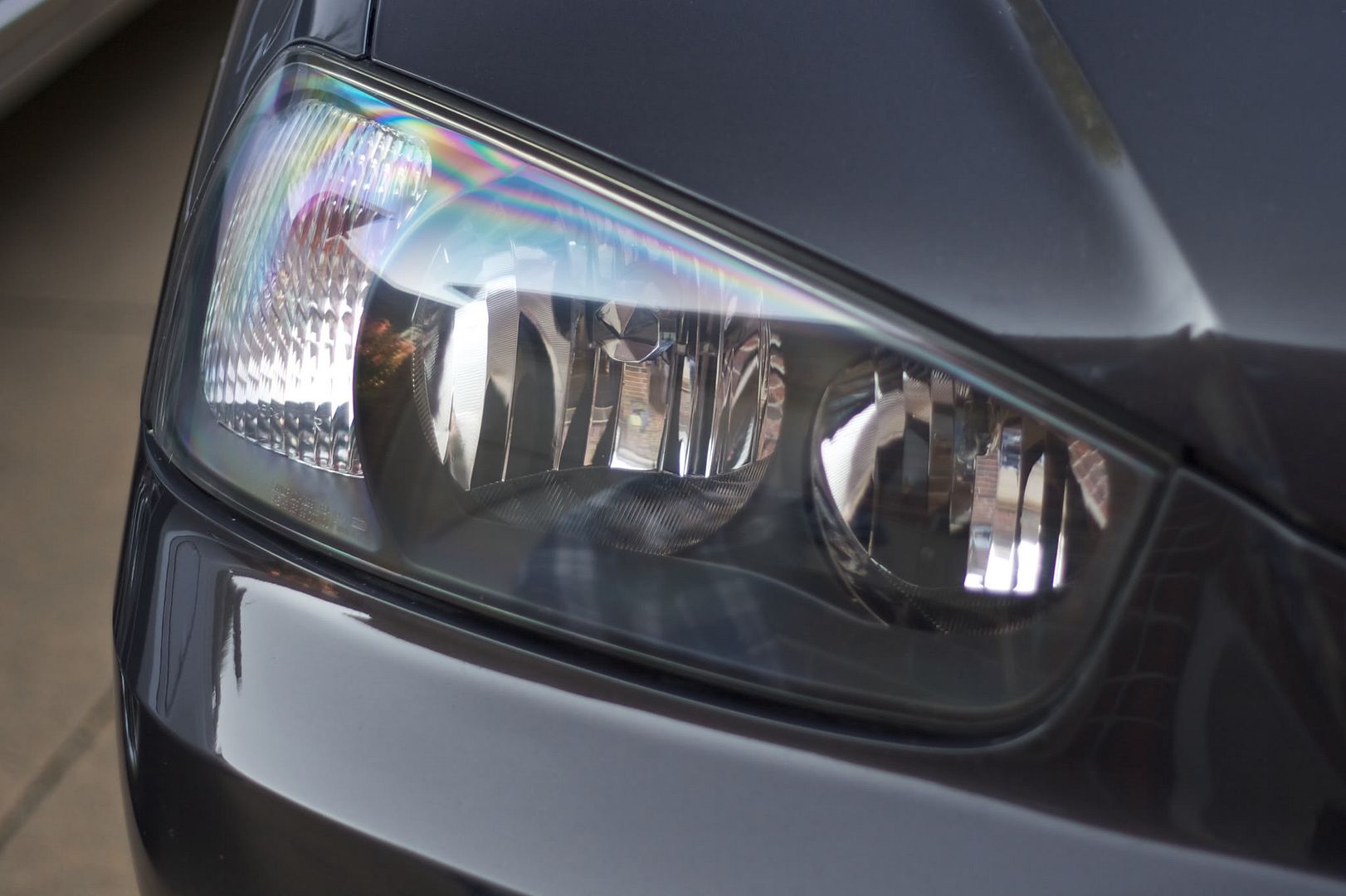

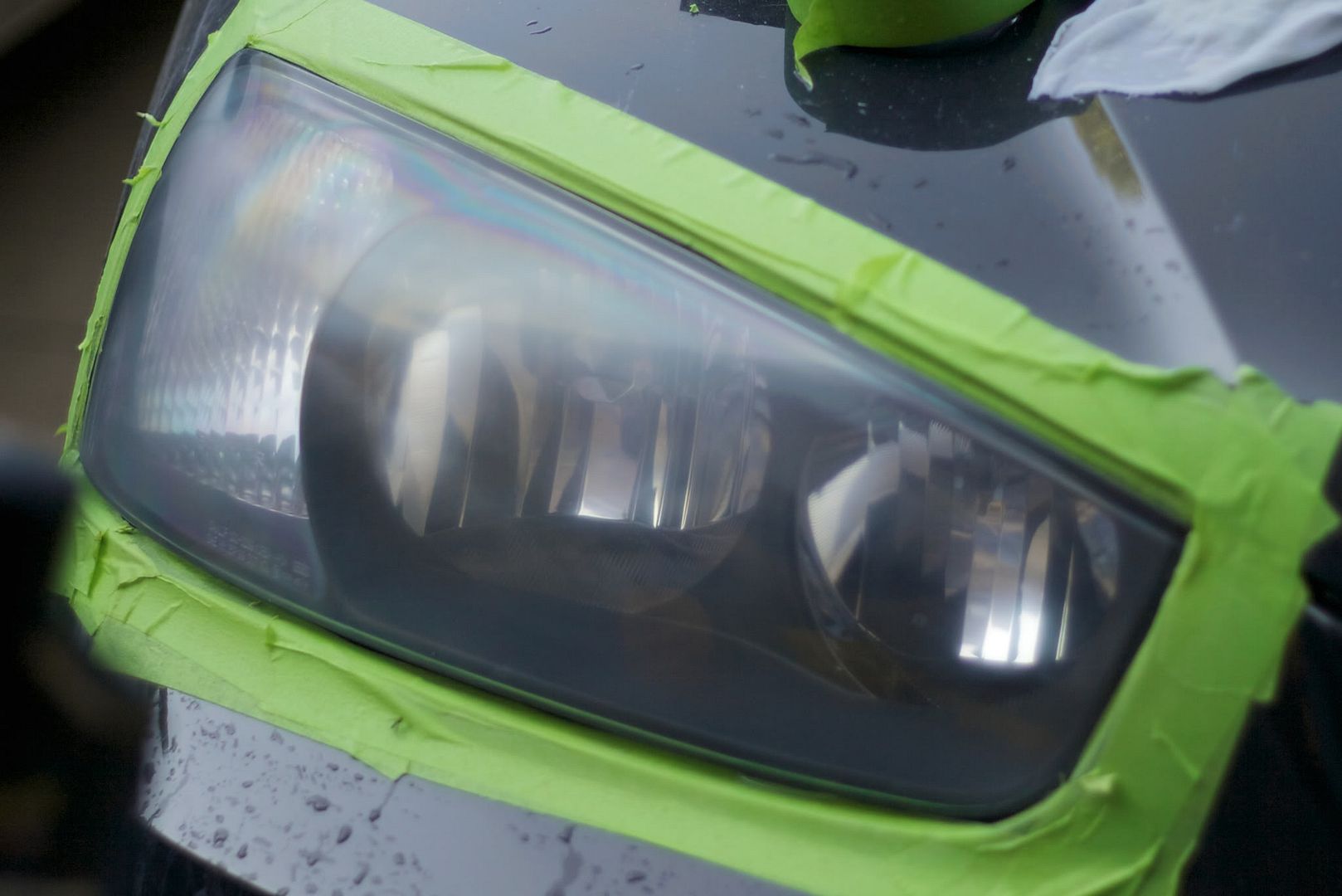

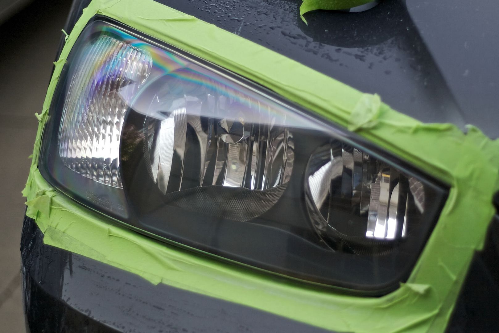

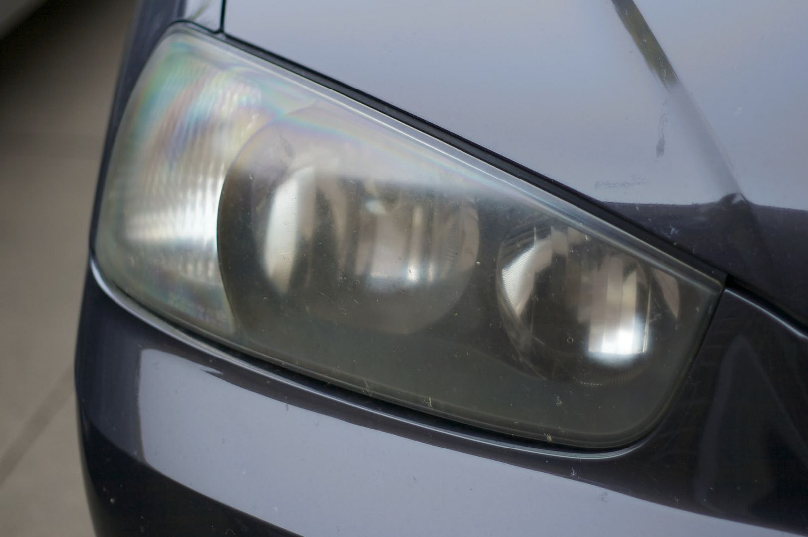

This is my friend's 2002 Hyundai Elantra he just bought. Passenger side light was in far worse condition than the driver's.
Used a mash up of products from a 3M restoration kit, Meg's Ultimate Polish and Scratchx (more to see what how they'd do on the plastic than anything), and finally 3M Rubbing Compound.

did you seal the headlights
Not strictly, no. I coated them with Meguiar's Headlight Protectant. Probably won't last long, but it'll be part of my little experiment I have going on between (now) 3 cars. I'm reapplying it every week to my wife's car's lights, every month on my MIL's car's lights, and now this new car will be the one time application. All cars are parked outside 100%.
