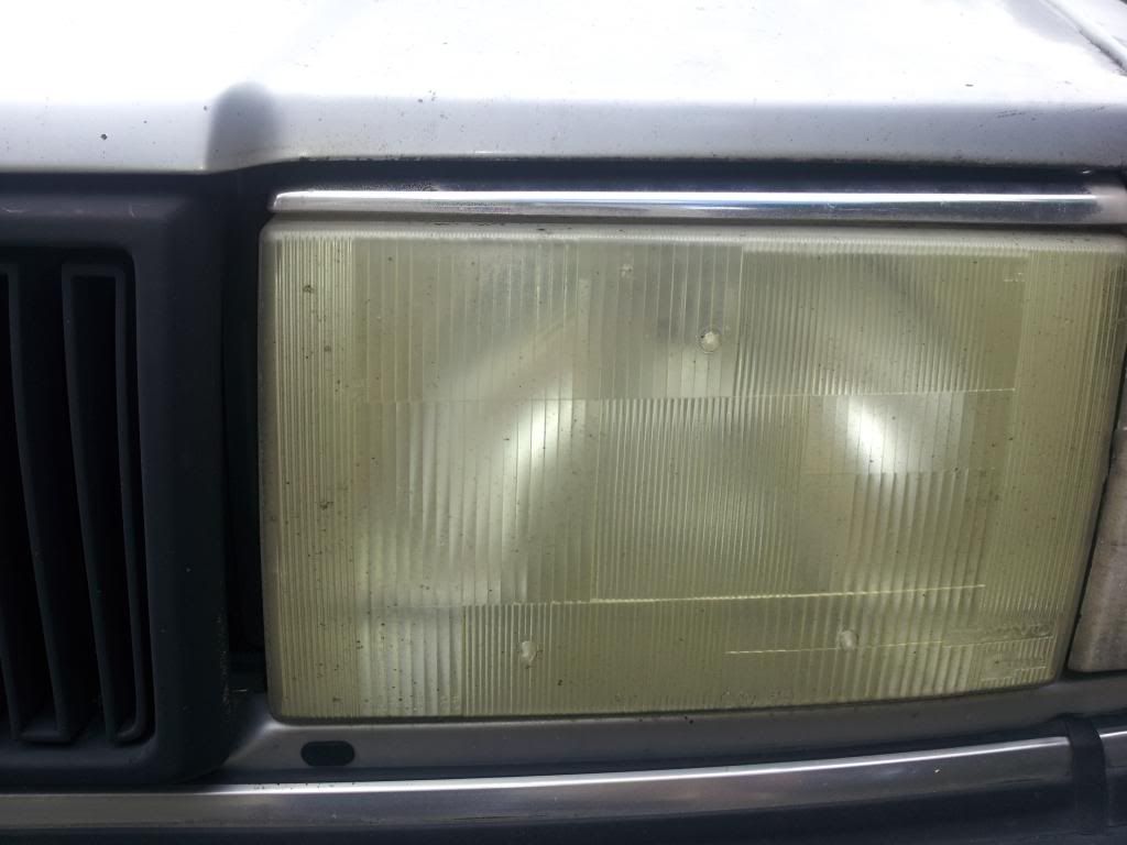

Hey guys Im using my car to sharpen my detailing skills. I need some advice Heres my headlights...
Driver
Passenger
Can these be cleared up? Or do I need to replace the lens? If they can be fixed how do I do it? I got the car with them looking like this in my defense lol

I believe those lenses are textured on the outside are they not? If so, I don't think a traditional headlight restoration will work.
yes they should be fixable i would start at 500 grit and then work my way up. but if you need to go down to 200 if 500 doesnt cut it enough
These are similiar to my 2000 Expedition where the texturing is on the inside. Proceed as if they are normal lenses.
Sandpaper? Nah, don't need to go there yet. Meguiars PlastX is great for restoring cloudy headlights. Inexpensive and found at any auto store. If you have a dual-action polisher (Porter Cable, Griots, Flex), use a 4" polishing pad and buff until clear.
Back in the day I would use toothpaste (1995 Dodge Neon) to clean up my headlights.
I am willing to bet plastX, as mentioned, will get the job done.

Sanding works best in my experiences. It removes the layer of plastic that is yellow. I have found compounds to work but the clarity wasnt as good as when I've sanded. Start with 500 grit and sand until its a frosted white. Work in straight lines to keep sanding marks uniform. Then proceed to 800 grit, then 1200 grit following same pattern as previous sanding. Finish with 2000 grit to achieve totally smooth surface. Using compound (m105 works great) rub the last bits of haziness out. Seal them up to prevent yellowing in the future. I also recommended changing headlight bulbs to sylvania hyper white. Much better visibility

I have tried it and it worked a bit, Should I go further and will it remove the oxidation ?
I doubt PlastX is going to 'cut' it with those. It'll lighten them up a bit sure, but correction is a different matter.
I stopped doing that whole drill and whirl away thing a long time ago though. Once I picked up the Meguiar's Spot Correction kit it just makes things soooooooo much easier. Whip out the small backing plate on the GG6 and go to town. :)
thanks guys. I got a meguiars heavy duty headlight resto kit. I will do it tomorrow since Im off.
That should fix most if not all of it. I use that for my family members cars and I get some really good results. Just remember to sand for as long as it takes to get a pretty uniform look from the sanding.
