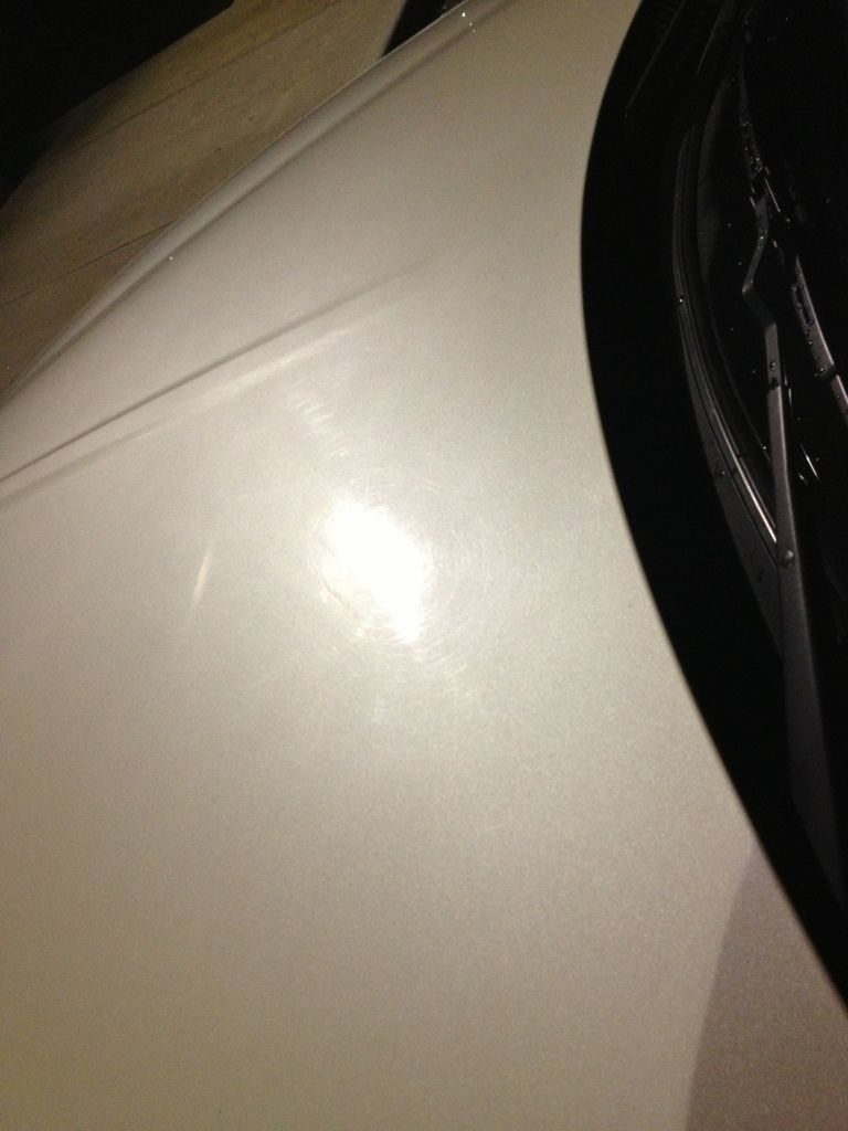

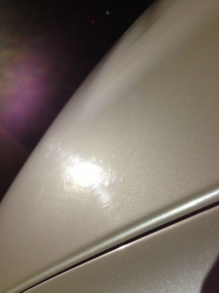

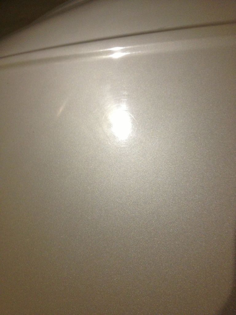

Here are a few photos of the swirls/etching. Went by the store for a second, had a good opportunity.

WiliamD--some of those swirls look pretty severe. The one Ford I've polished was a 97 Escort and the paint was as hard as nails. If that's the case with your car you'll be happy with your decision if you do go with the GG DA.
