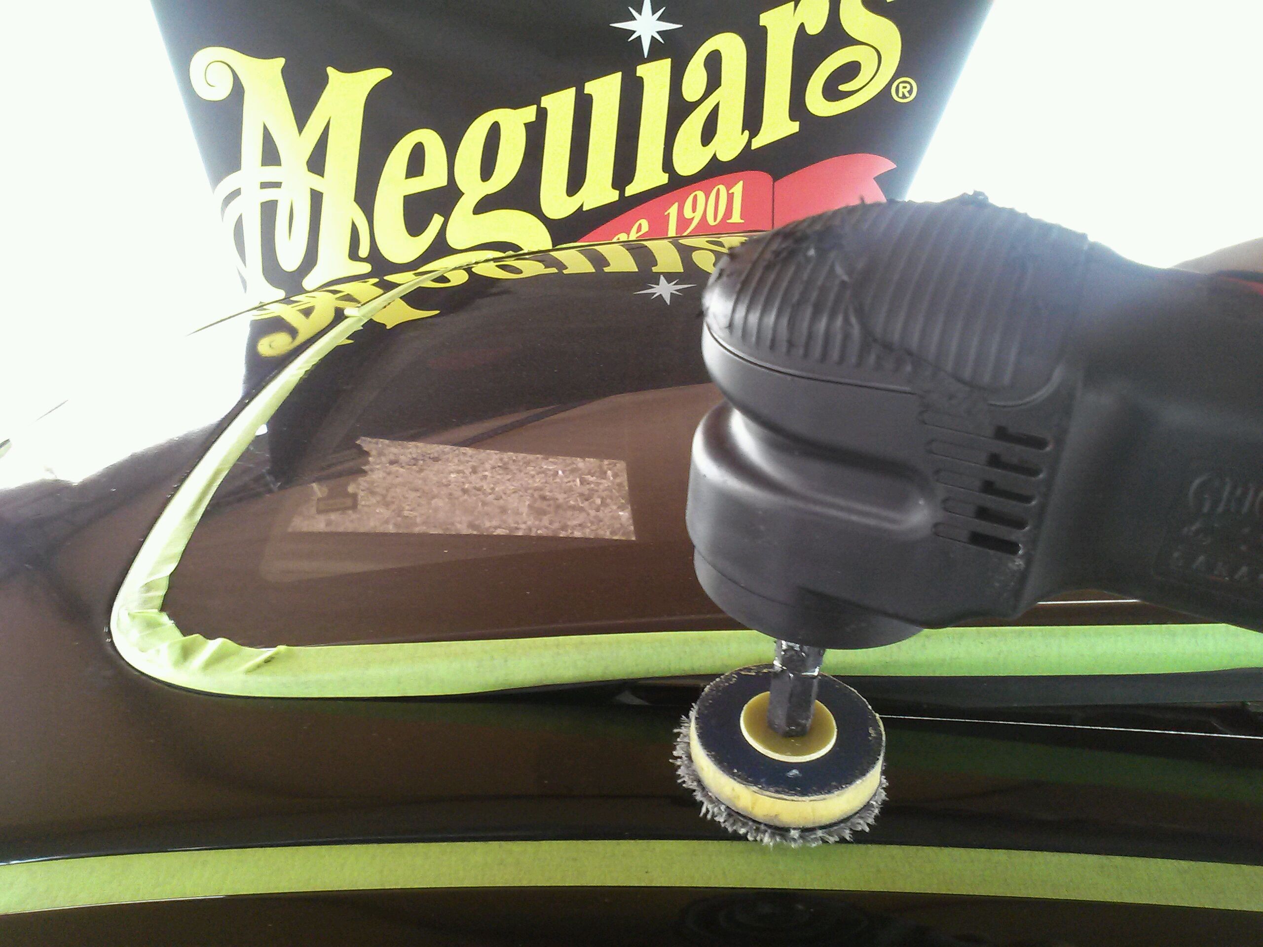

Nothing wrong with practicing on old tractors...
Pictures: 1947 John Deere Tractor - Show Tractor Makeover!
