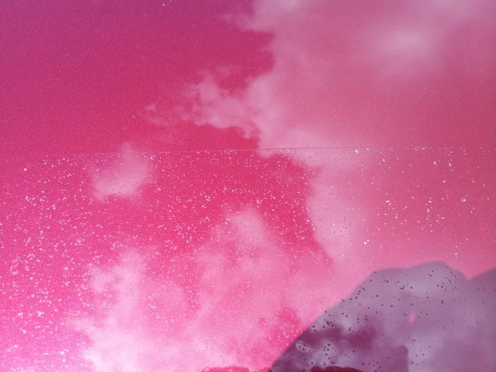

A few weeks ago I decided it was a great idea to use some was n wax bottle that was laying around garage(threw it away next day and forgot the name) because I was too lazy to go buy more meguiars gold class shampoo which is what i typically use. Anyway to make a long story short, next day i see these tiny white dots all around different parts of the car. My best guess was that the "wax" somehow didn't dissolve correctly in the water. If i use my fingernail i can scrub it off. Pictures to follow, a little hard to see. The car hasn't been washed in about a week and a half;

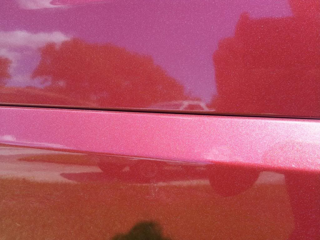

The third picture shows damage from what appeared to be some sort of bra that it had before I bought it. They are small chips in paint.
The Blackfire Gloss Enhancing Polish is non-abrasive, it's what's called a paint cleaner or pre-wax cleaner.
It will remove these white dots by hand or machine and leave the paint ready to seal with a wax.
Repaint for the above chips in the paint...
My concern is that the BF GEP isn't going to cut enough to get the minor swirls/scratches out. Im hoping the claying will remove all those pesky wax leftovers.
Both claying and the BF GEP will together remove the white dots and get your paint clean and clear, ready to wax. Like I explain in this recent article,

Also is there anything I can do for the hood chips? Dr.colorchip? Repaint?
If you want it to look good, then re-paint, that's a lot of damage to try to fix with Dr. Color Chip AND have it look good to what I'm guessing will be your expectations of what "looks good" means.

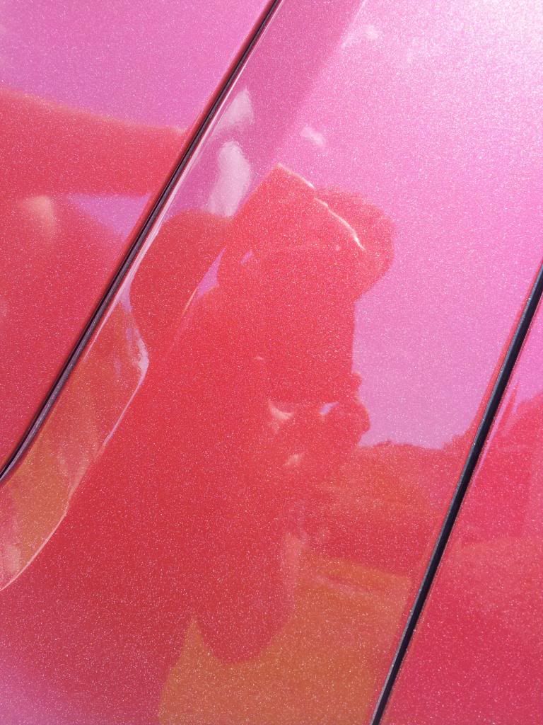

Thanks for all the schooling, I'm enjoy reading your articles. I think I'm going to bite the bullet and just get a polisher, specifically the GG. Do i need to use the SRC duo's or can i get off with just finishing polish? The paint has spider webs(mostly rear passenger quarter panel) and swirls. The drivers side looks a lot better.
