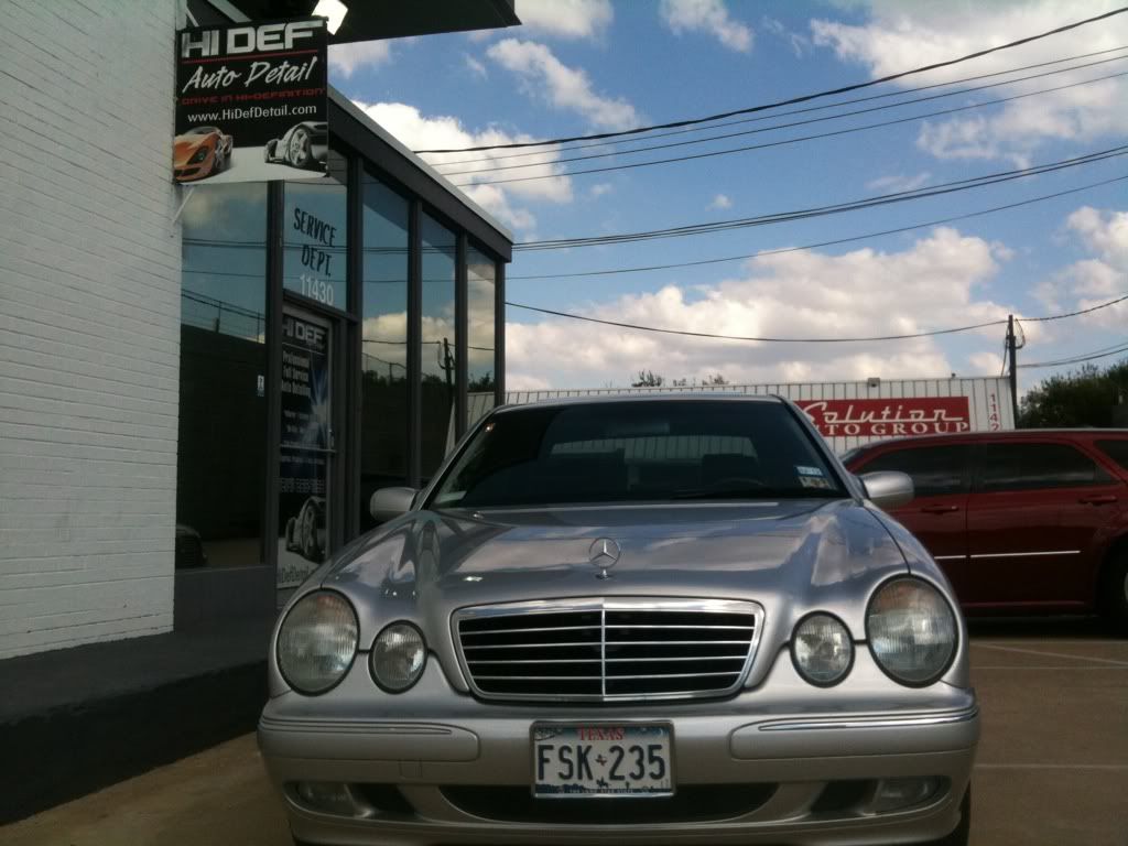

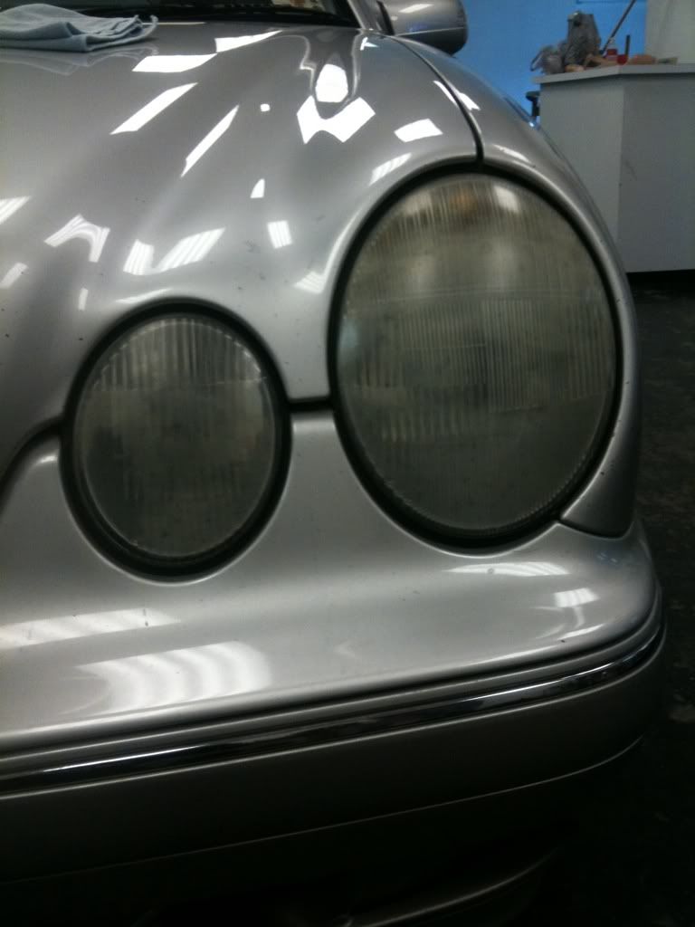

This 98' MB E-Class was in serious need of a headlight restoration. The owner works next door to my shop so I see the car all the time and night you can barely tell he had headlights on. So I talked to him about the benefits of headlight restoration and he decided to give it try over buying replacements.
Here's a before shot:

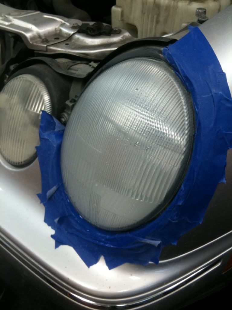

Here's the process:
1. Taped up the trim area
2. Wet sand 800 grit
3. Wet sand 1000 grit
4. Wet sand 3000 grit
5. Hand polish Hi Def Bling Polish
6. Apply ClearView Headlight Sealant

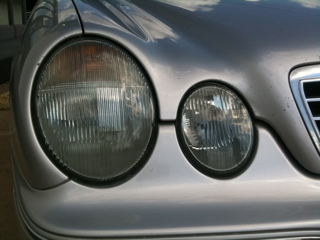

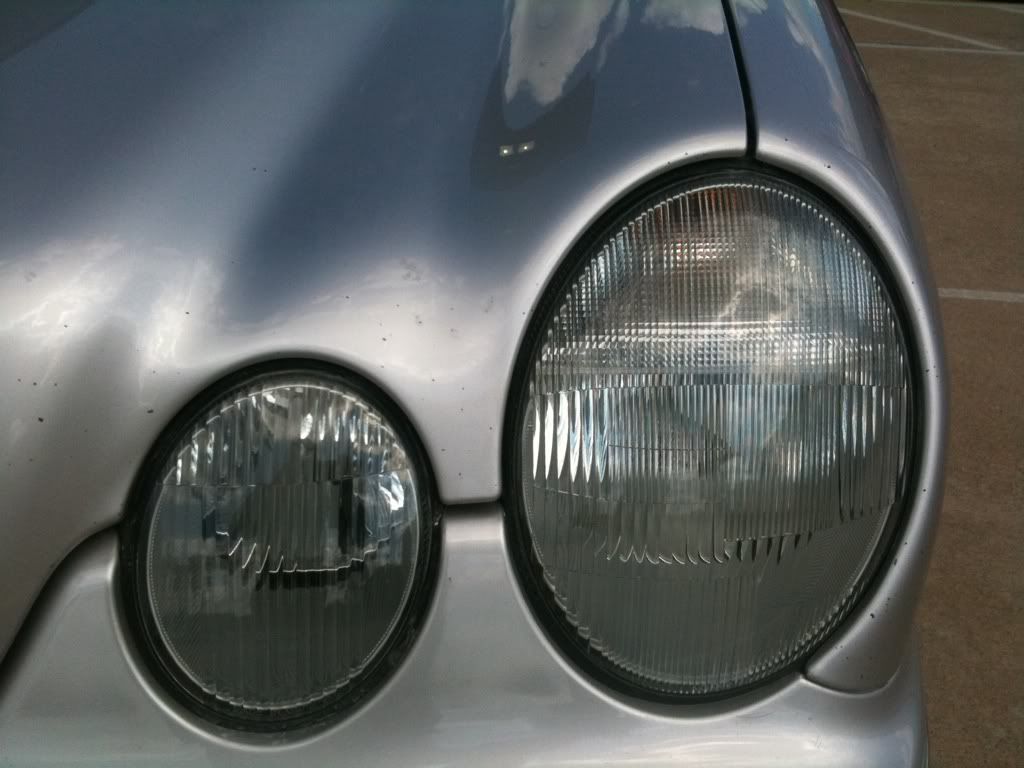

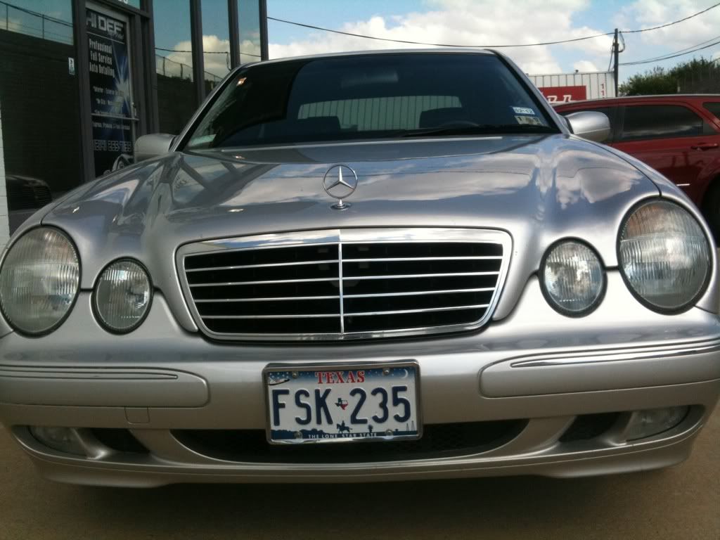

Here are the results:
