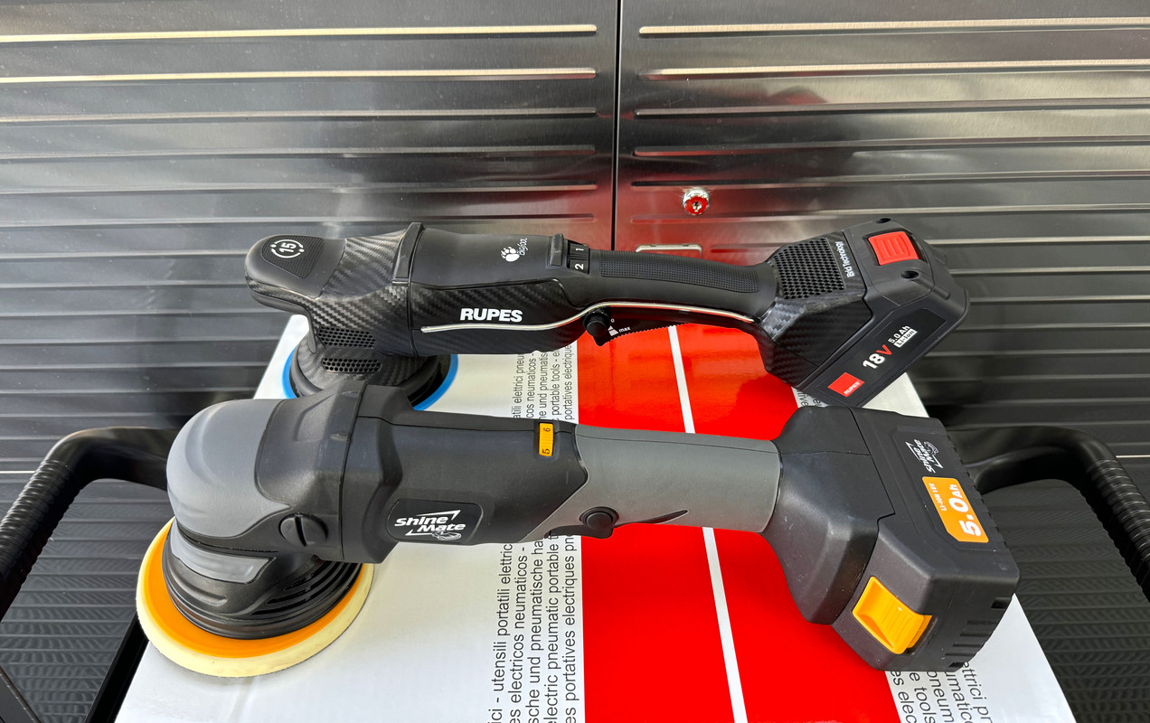

I took the plunge and bought a HLR15 as soon as they arrived in Australia, which was about 6-months after they initially went on sale throughout the USA. The very earliest examples sold in the US had some overheating issues, but that seems to be sorted now. Despite those concerns, as well as the documented battery placement and sensitivity to pads, I was super intrigued by the smoothness, lightness and form factor.
At the moment, I'm running the ShineMate EB351 5/15 back-to-back with the HLR15. The ShineMate has more torque, but the HLR is smoother, quieter, lighter and offers more speed headroom. Battery placement is better on the ShineMate, but to me, the HLR's setup hasn't been the issue I was expecting. In any case, I've always supported a polisher from the battery, so it just feel natural too me. And you are correct in the noise department, you hearing protection is optional not mandatory like other machines.
Overall, I'm happy with the HLR. It's not perfect, but as mentioned, what is?
