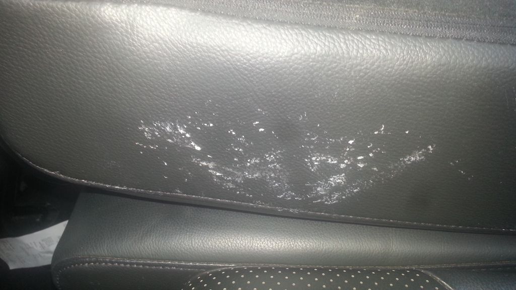

here some pics of the interior.
Some sections of the front seat seem like they've hardened too.. doesn't look to be splitting.. at least not yet, but certainly not softer like other eats in the car.

I got to say, that interior looks pretty bad. For the leather, I would start with Lexol Cleaner. A lot of folks swear by using Meguires Super Degreaser at 5:1. I used it 10:1 and it striped the dye. I have a feeling that my seats were re-dyed to begin with and that is what was stripped. Personally, I would stay away from the Super Degreaser. If the Lexol does not work you might consider re-dying, that is what I will be doing this summer. There are several companies that make dyes that can be sprayed on, SEM, Scratchwizard and Leatherworld Technologies are the best known.

I would also like to mention that the companies that make the leather dye also make plastic dyes and plastic scratch fillers that would repair your interior plastic panels.

Same for a protectant, pick one and use on the seat and plastics. Modern leather needs protected, not conditioned.

I'm totally onboard with 11Siverado and GSKR. Don't get fancy here and no need to go over the top with the expenses. An APC and some leather conditioner from your local auto supply store would probably get you 60-70% there. I would recommend finding a soft brush to be able to agitate the leather after you have sprayed it with the APC, you will see a world of difference. As for your carpets, if you can do as dthor68 that would be really great. If not, your Bissel and stiff brush/carpet cleaner will work and will probably get you a good 70% to where you want to be.
I would NOT use Simply Green! I used it on an interior one time and it removed the white paint from the buttons on the dash. It is way too strong for interior auto use.
Like others have said get a automotive grade all-purpose-cleaner and dilute it for interior use per the instructions on the bottle. I think the Poorboys product I use recommends 10:1. Once you've cleaned the seats, I'd probably hit them with some dedicated leather products like Lexol. As for the rest of the trim, a follow up with something like DP Interior Surface Protectant, 303 Automotive Protectant, or one of the Meguiars interior protectant products.

Regarding "hardened" leather... the outside edge of the seat (after the perforated section on the Right) seemed to have hardened texture to it.. not sure why though, whether it from wear, or whether somethings spilt (seen in the 1st and last pictures on original post)
