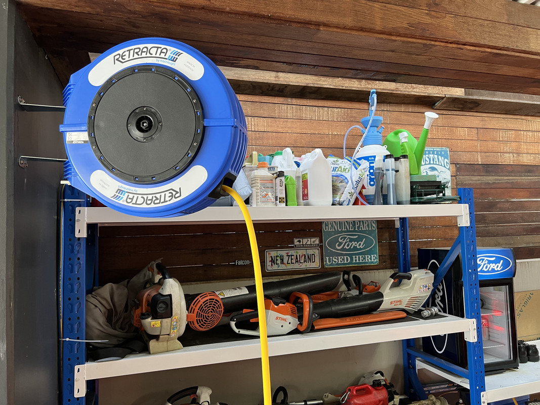

Late last year, I decided to invest some money into my setup to make it more convenient to use, the big addition was a wall mounted air reel with a soft, pliable rubber hose.
I have this plumbed back to my compressor with an inline moisture filter. On the outlet of the hose, I added a Prevost double-action connector, which also required fitting new Euro high flow fittings to all my tools.

Having the hose reel means I can easily reach for compressed air when needed, rather than dragging out and untangling the hose before use, followed by the frustration of coiling it back up again.
