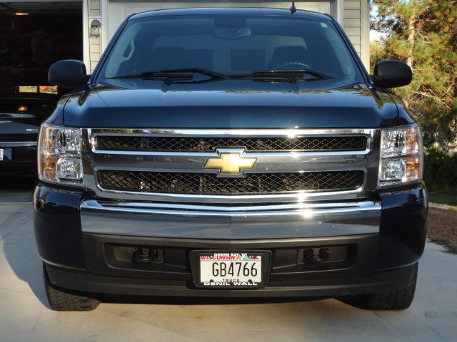

This past weekend I had a 30hr correction/protection on a 2008' Chevy Silverado Extended Cab:

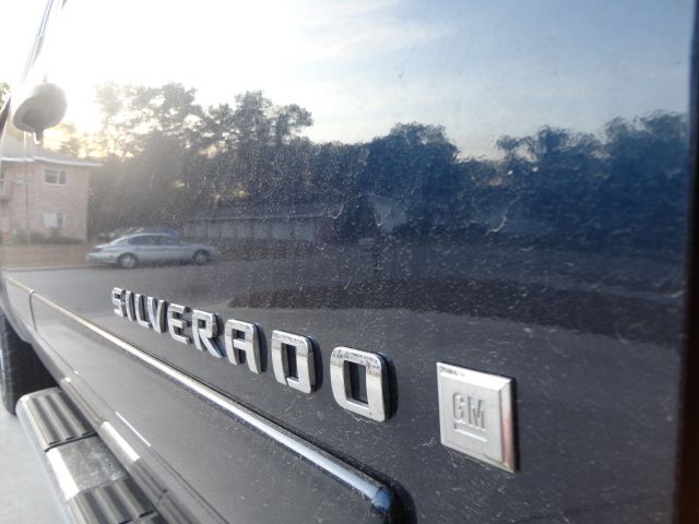

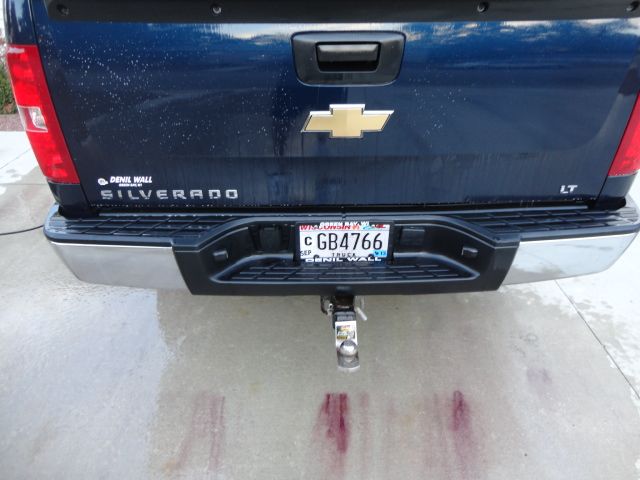

I washed and IX the truck prior to any correction work.The purple did not photo well on the dark blue paint but there was some iron contanimation on the paint:
cleaned the wheels and tires also prior to paint correction:

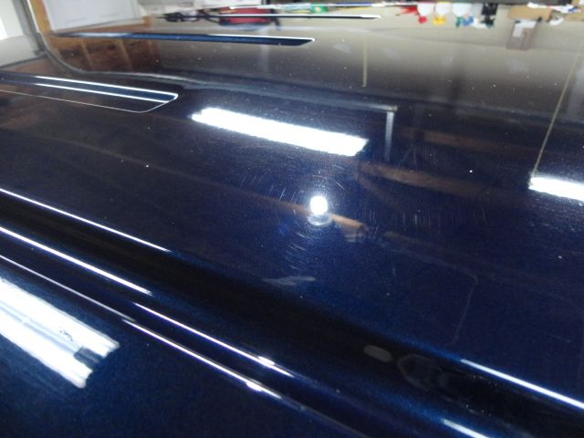

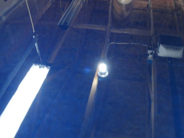

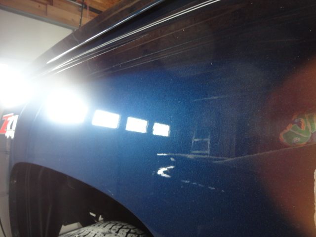

Pulled the truck into my shop after drying and here is the wonderful suprise I was working with:

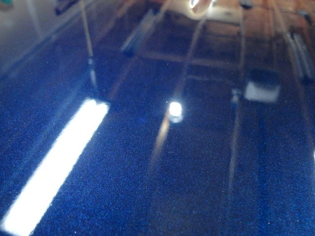

My weapon of choice was to use my new Cyclo (Thanks Old Tiger...Jim) and green Cyclo pads with OPT's HC:
after several section passes I wasn't seing the efficient correction I was looking for,so I busted out my OPT MF correcting pads and used them with the OPT HC:
after several section passes:

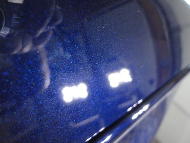

The majic was starting to work,you can see the top light (uncorrected) differ from the bottom light (starting to correct):
I taped off the hand painted pin stripping and started on my way:

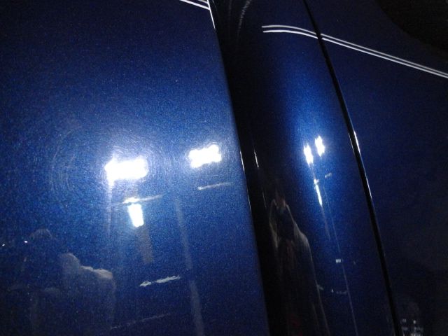

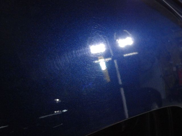

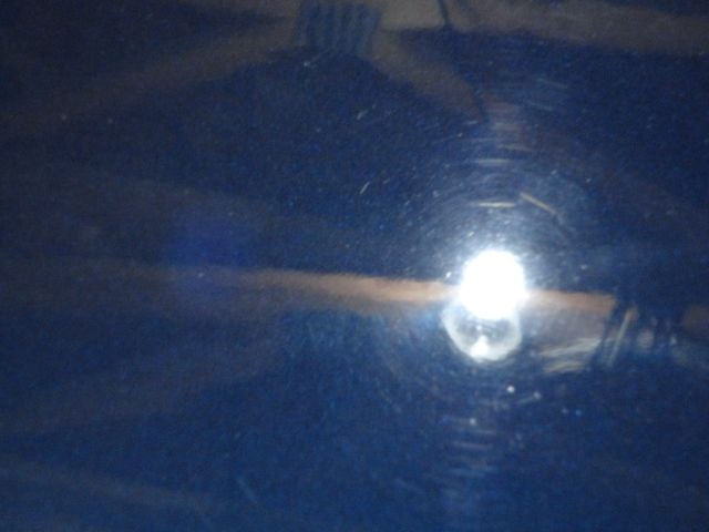

plenty of swirls,scratches,and RIDS everywhere.For some of the horizontal panels,I used my 3401VRG and GG3":

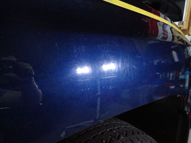

Left side uncorrected,right side corrected:

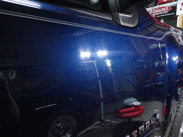

Working my way down the side of the truck,I corrected the tail lens as well:

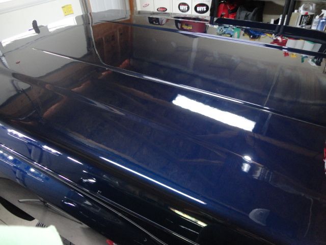

Started on the tonneau cover,the fiber glass was in very bad shape and the coating was a gel coat:
spent 4.5hrs on it but I came out clean and corrected:
side rail of the cover was just as bad:
ahhh,much better:

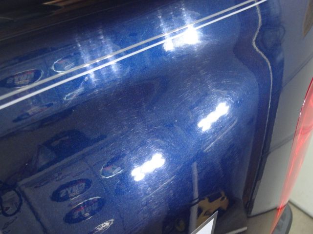

rear tail gate again very swirled,before and after:
rear quarter before and after:

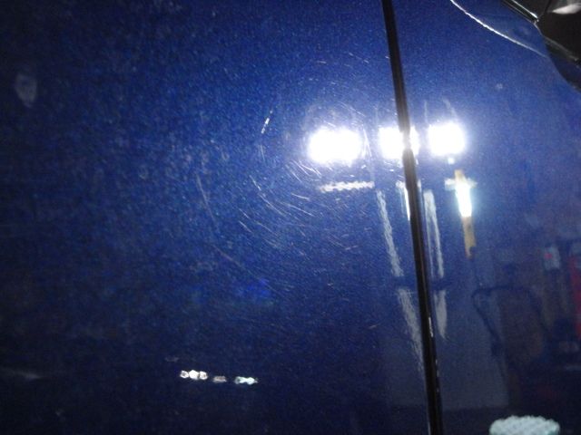

Front drivers door,swirled badly:
corrected like a champ:

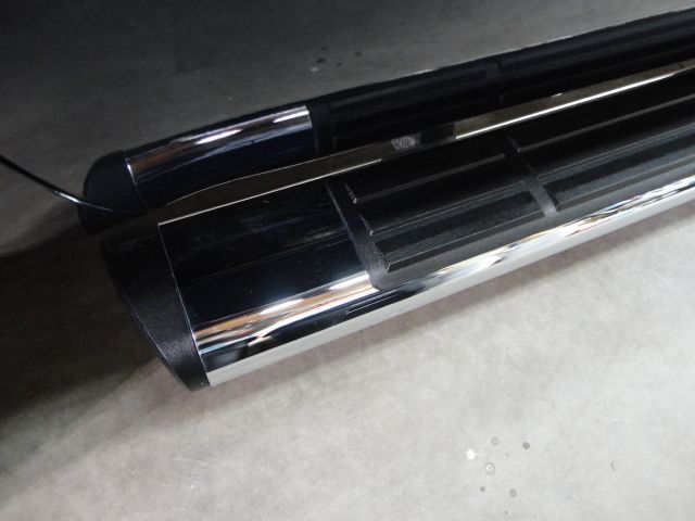

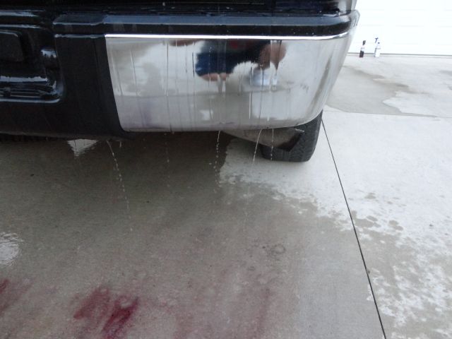

side foot step bar before:
chrome polished with OPT's Metal Polish and plastic dressed with CarPro's DLux:

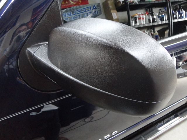

Mirror's cleaned down with CQ Eraser:
and then dressed with CarPro's DLux:

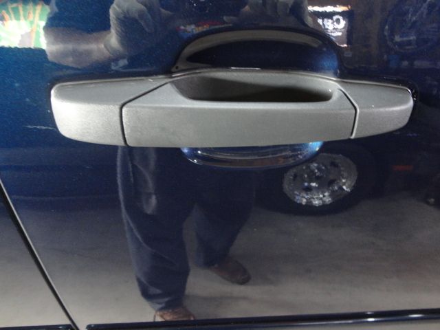

all handles wiped down and cleaned with Eraser:
and dressed with DLux:

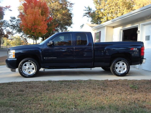

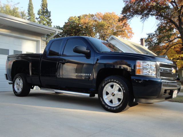

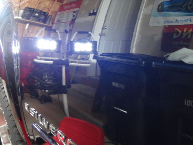

The truck came out great and had a mirror shine and image:

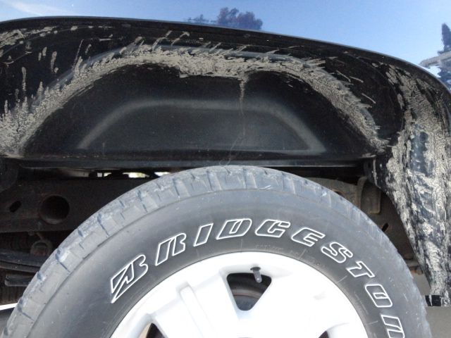

Wheel wells and wheels/tires before:
and after.wells prepped with Adams UC and tires dressed with Meg's Endurance Tire Spray:
