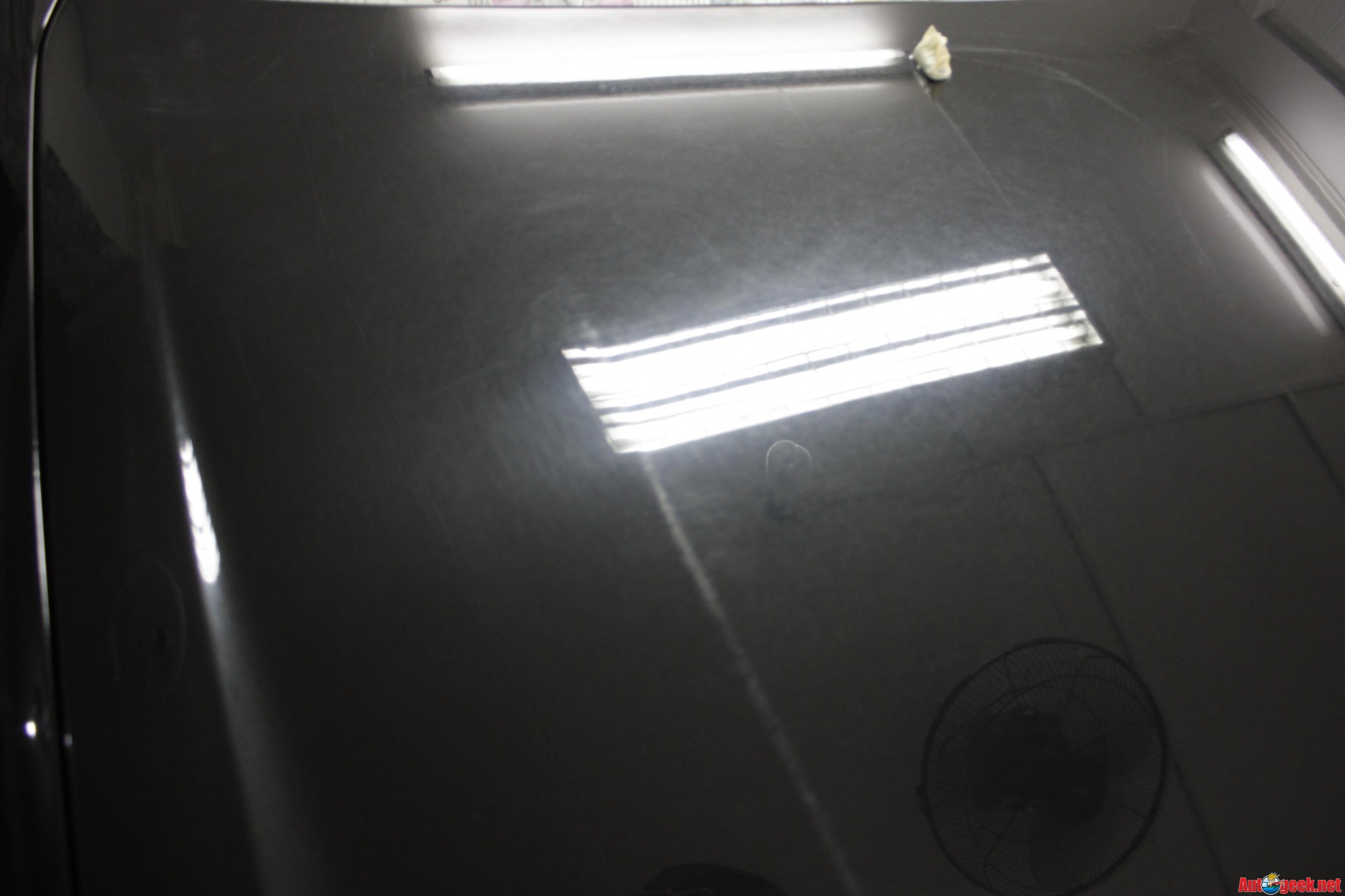

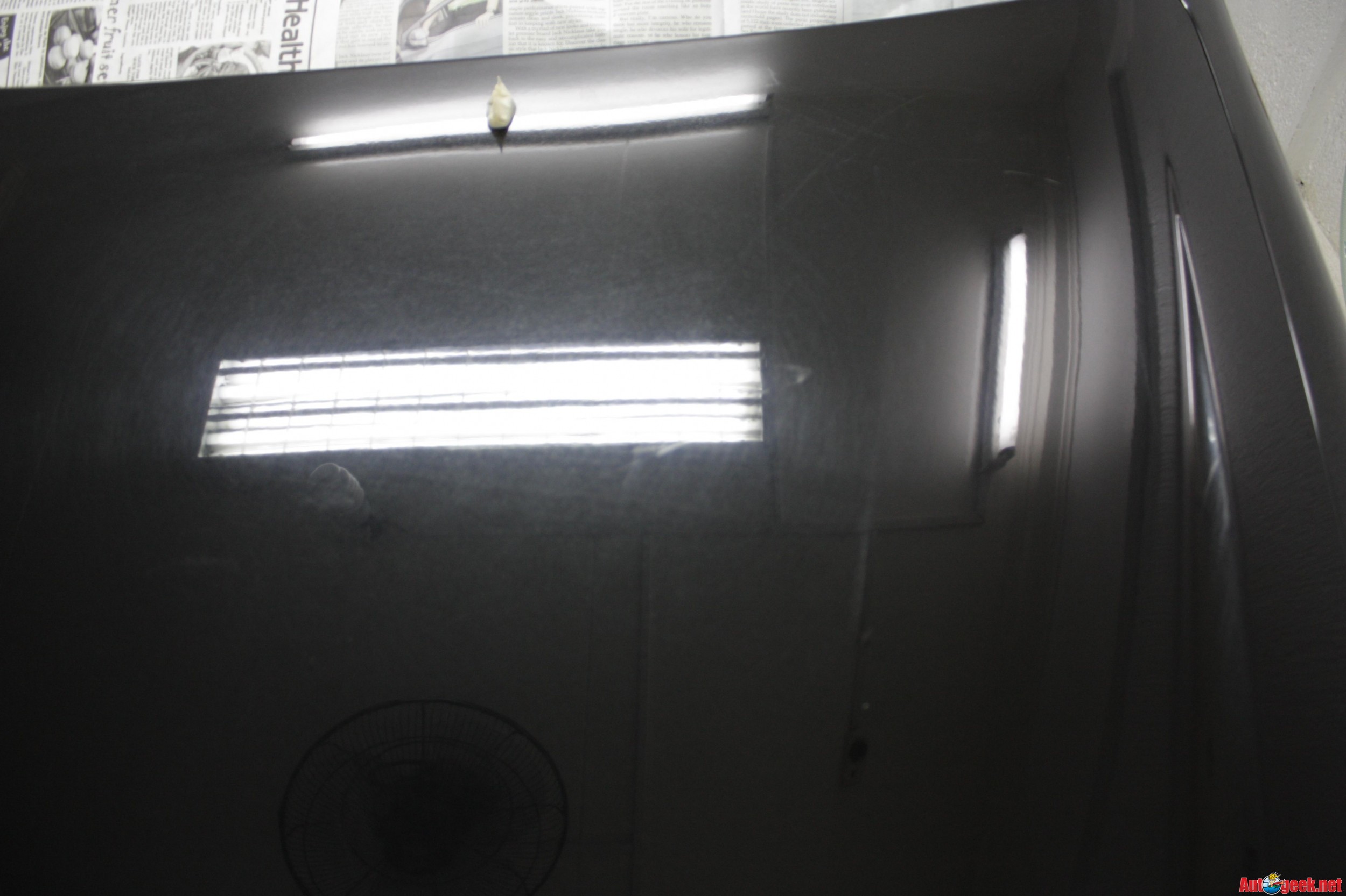

How can I remove overspray from my car? I just had a small tear in the back bumper fixed and I just discovered what feels like possible overspray over the entire car. I had just did the WG TSR, FG, WGDGPS, and topped it with Fuzion. The paint is in good shape any suggestions on the easiest way to get rid of the overspray? My paint is feeling really rough. I also have on hand some LC orange, white, and blue pads and the Meg twins (105-205). Not sure how to fix the problem. Also any suggestions on how to protect the new paint? It's one day old.
Here's a couple before photo's (the lack of photography skills are showing) I had a hard time with the weather, as soon as I finished it rained.
Thanks,
David
Feed back please
After claying will I need to polish with the 205 or WG FG? Or will the claying even harm the work I've already done? Also I just ran out of the dedicated claybar spray, all I have it the FK, WG detail sprits, and WG sealant spray. Would any of these work as a substitute until I get my DP BOGO?
