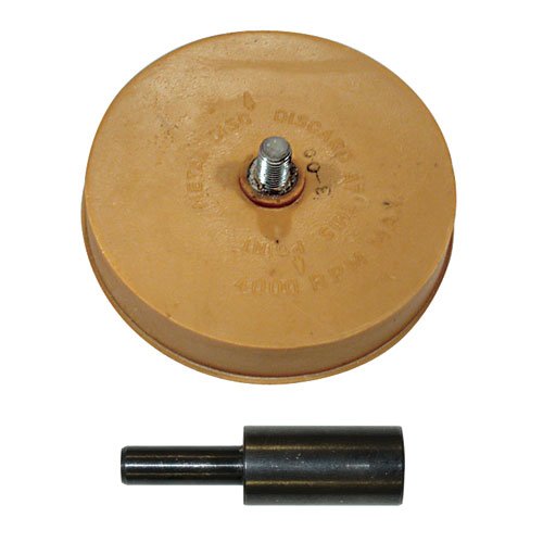

Choice Tool Supply 4" Smart Eraser Pad with Drill Adaptor Arbor
This is similar to the 3M easer but less then half the cost, $14 free shipping over $35 on amazon too.
Toyota has 4, I'd say big(er) chrome emblems on the back. I took me 3hrs with fishing line and goo gone for the small TOYOTA emblem (.5x3') in size, took me 30 mins after got my eraser for the other 3 that where twice as big and didn't need any crappy goo gone.
Forget goo gone, heat guns and the rest of that CRAP unless you have hours to waste, this is all you need.
I have used heat guns and a plastic razor with relatively good success, then follow up with rubbing alcohol. But I am learning so much more here. I have also used the 3m on the drill which is awesome!

This is what body shops use!

Yes it's used in body shops, pay attention to the max rpm, we had a guy get stitches in his lip because one grenaded in his face. Also be care you can burn the paint
