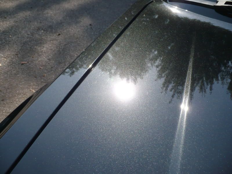

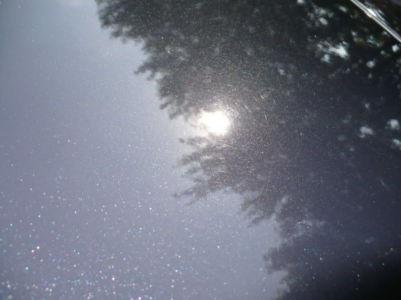

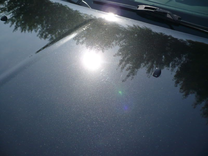

I take pics to show you what I mean about little swirls:
since I am a member here and I learned how to make polished I became addicted to a detailing!
205 should remove those light swirls. Even if you used 205 on a white pad 2-3 times a year you would never go through your clear. The amount of clear that combo will remove is almost immeasurable.
