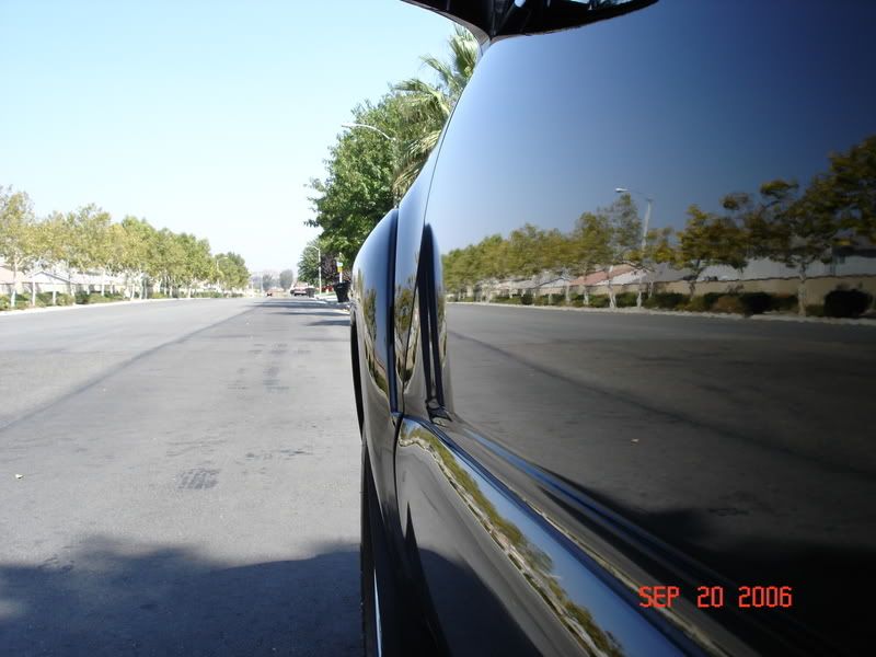

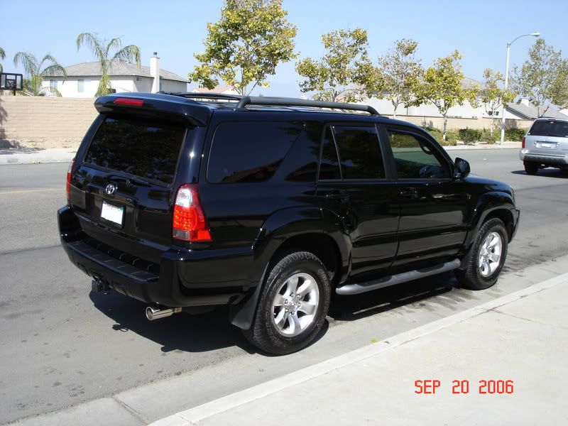

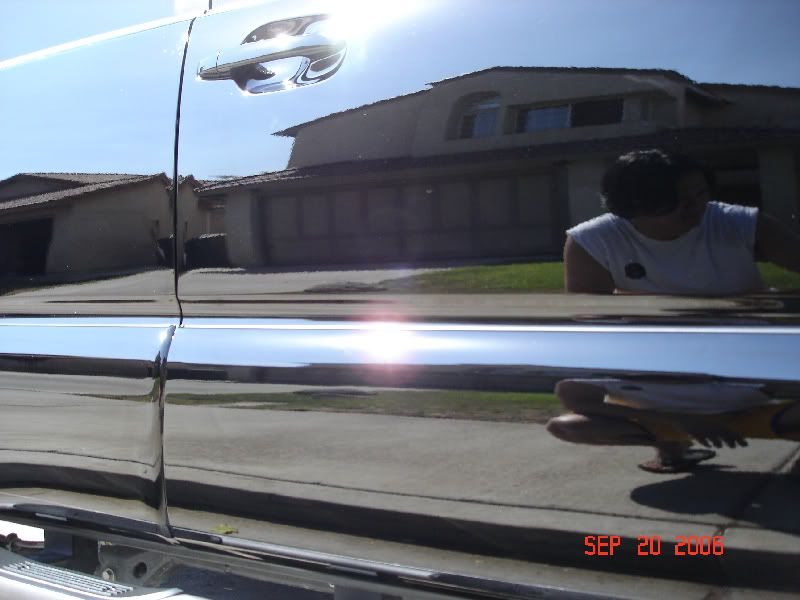

the truck i have is an 06 4runner in black. the condition is still excellent with some fine swirls and ai found a small scratch by the driver's door, you cant see it but if you glide your finger trhu it its there. i zaino'd it last week and thats where i see some swirls and not satisfied with the flaws.
from what i see, the only thing im missing is a good wax. here is my truck.
i can see very fine swirls if i look very hard not visible in pictures, which i plan to get rid off and make it slick.
mods, you can delete if im not supposed to have pictures here on this thread.
Seems that you like perfect finish. If you haven't tired Souveran paste, then pick it up when you get a chance. It will give you a gordeous soaking wet finish.:righton:
Souveran, 5 stars in my book! Nice pic's! Nice ride! We love pic's around here, so go ahead and post pics!!!
