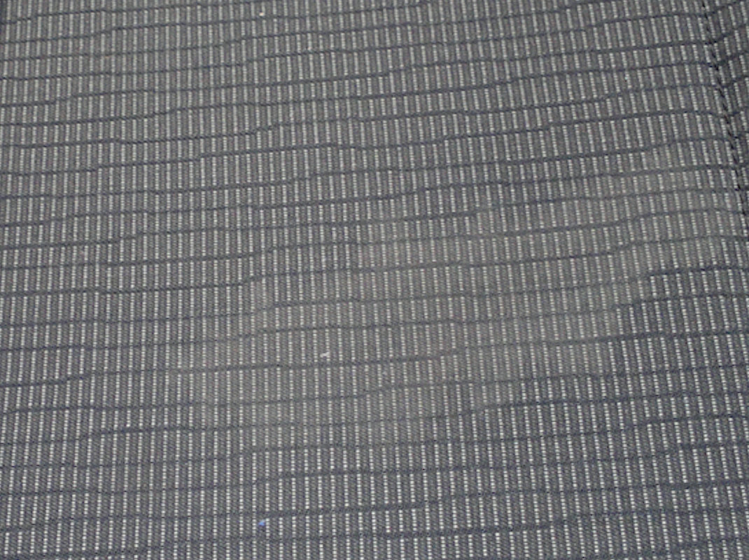

About the 4"x4" Suede Microfiber, Im sure when my Mr. Fix 9H arrives it wont have it, I will have to buy online for that. And from the dim looks of it, Our online shops here sell it and its from china. Im not sure if its the same quality as the carpro.
Im understanding now why these microfibers are so important. I'm afraid to buy the suede MF online cause there's no reviews. Its just says its for glasses.
I have attached pictures. Do you think this is ok? As long as there's no dirt it will not scratch the paint right? :-)View attachment 67853View attachment 67852
Mike has an article on IPA mixtures. Some even mix it 50/50 with water.
I would actually skip on the suede applicators and invest in the Autofiber microfiber coating saver applicators. They work much better than the suede block and applicator. You get many of them but you will find other ways to use them. If you must have a suede applicator, then the rag company butter soft suede's are much better in my experience.
I will also mention to get yourself some good towels for the coating process. The rag company edgeless 300's are a great towel for the job. Use one for the initial wipe and the second for the final wipe.
