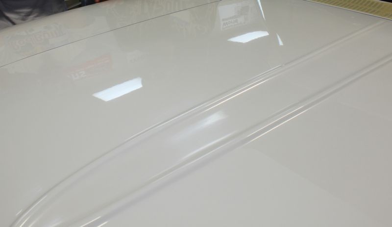

I have a friend who just purchased a new (to him) '09 C6 Corvette. He's asked me to help polish and put a coating on the car for protection and gloss.
This car has what I believe is an after market vinyl stripe package on the hood, removable roof panel, and trunk lid. Here is a photo:
I've never detailed a car with a graphics package on it before, and had some trouble searching for tips on how to do it. Can you give me some advice on what and what not to do to make this car look as good as it deserves?

I generally use m205 on a soft finishing pad. No pressure so as to minimize heat. The coating we use doesn't increase gloss on matte stripes and works great for uv protection.
Assuming the graphics are vinyl then here is what I did (not much success). I used green LC pads and Optimum Finish II polish. The vinyl tends to heat up so I went speed 4 on my DA. Put a coat of Opti-Seal and called it a day. The vinyl doesn't correct like paint, so your results may vary. If the are paint then same as you would polish paint (No compound's just polish and lower cut pads).
I've never bothered taking any particular care over graphics. I treat them the same as the paint, except in some instances I've had compound dry up on them and not very easy to get off. Ended up having to use detail spray and lots of repeated wiping. The only precaution would be around edges that are starting to peel up, but I've still never had an issue. Any coating is not going to stick the same, but it's a vinyl sticker and no one expects it to be as shiny as the paint.
One other thing I did notice when detailing a truck with vinyl carbon fiber look wrap on the fender flares, my exterior trim dressing made them look awesome. I have no idea how long it will last, but they were already yellowing a little and has some whitish stains on them. Looked good as new with the dressing.

From the picture, the vinyl appears
to be "shiny" (vs. being matte).
