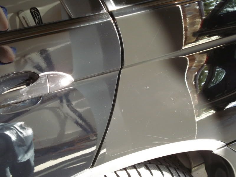

Even professional paint shops can't always get it to match correctly. Get it in the right light and you can totally tell when paint doesn't match.
LOL! So true!
Some places will also mix the paint for you and put it in a rattle can.
Some colors have more variances than others. LOL, I had my bumper painted on my TSX "Milano Red" and even though I was there when they chose the variance chip, matched perfect when held next to the car, it still came out wrong.

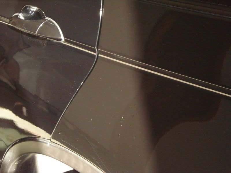

Here is the same vehicle from a distance without the lighting.
They tried to tell me it didn't have any bodywork done on it. lol As far as I could tell, that door is the only part of the car that hadn't been repainted at some point. It was just so covered in swirls that you couldn't tell. lol
