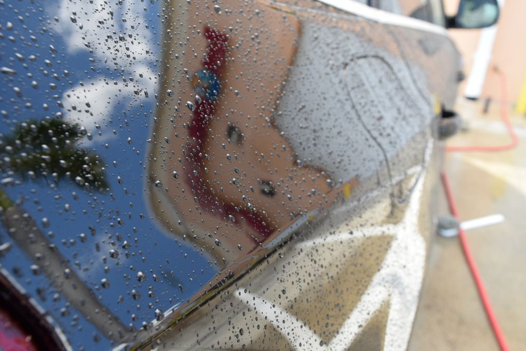

You will INSTANTLY notice the hydrophobic water behavior as soon as you rinse off.
The water beading is very aggressive.

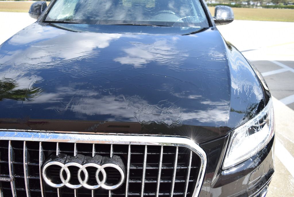

Old water behavior
After a few sprays of Hydro Blue and a rinse, Look at the nice glossy protection it leaves behind. Notice the other half of the hood still has puddles of water that linger.
50/50 shot of one side treated with Hydro Blue.
Lets fix the other half of that door!
Rinse.
Much Better!

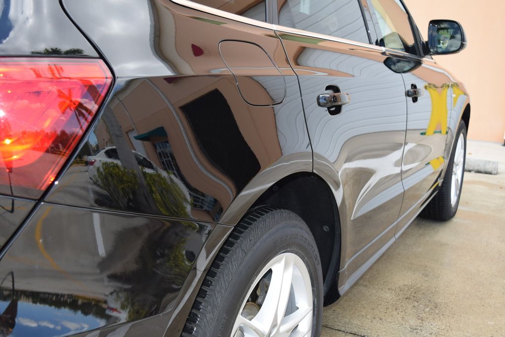

After drying Hydro Blue makes your paint feel really slick and smooth.

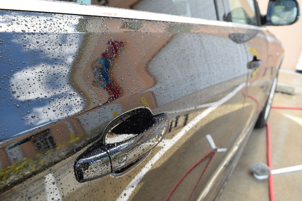

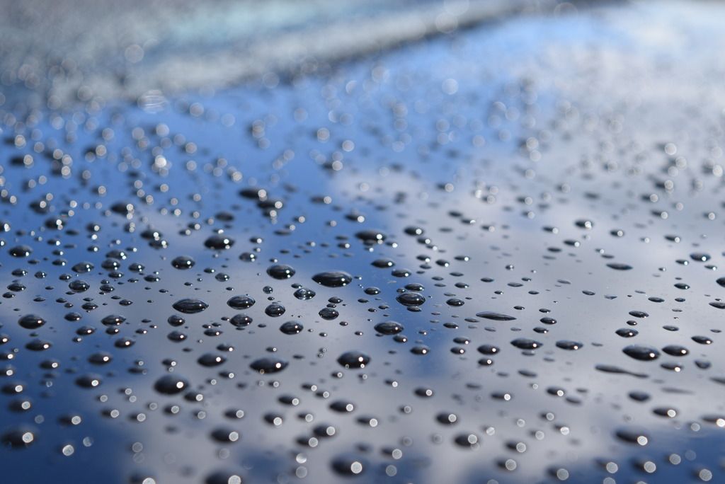

Water Beading
Lets take a look at some closer water beading shots

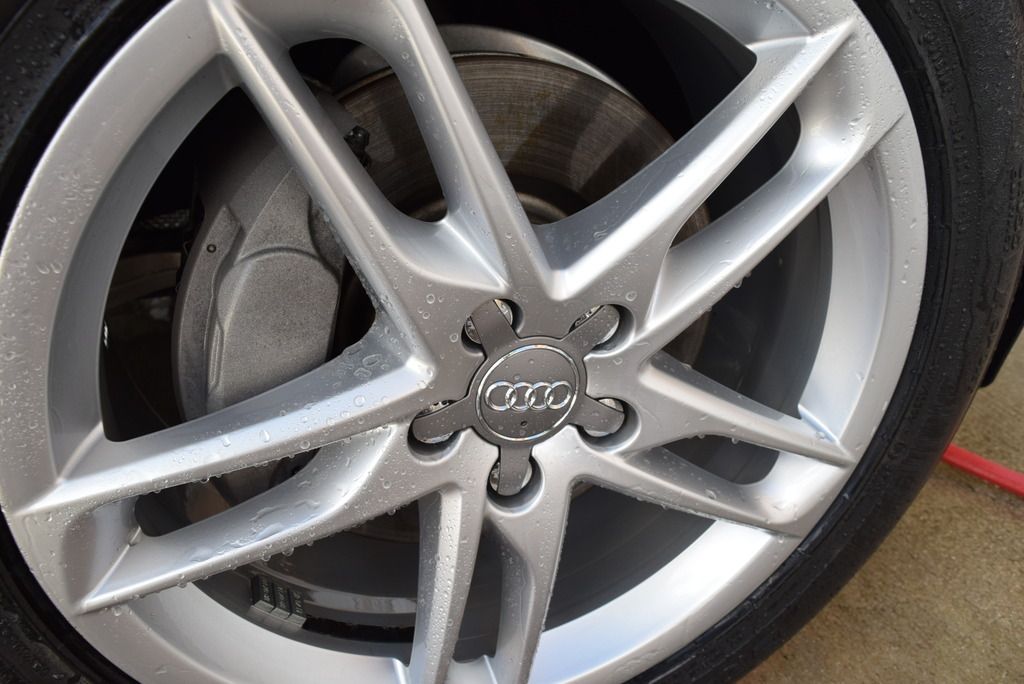

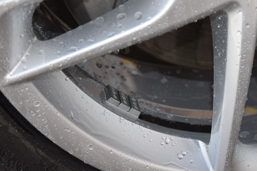

Wheels
Hydro Blue is a excellent way to maintain your wheels, The application process is just as simple as simple as spraying on and rinse off.
Before Hydro Blue.
Notice the water puddles in the barrel of the wheels.(Before)

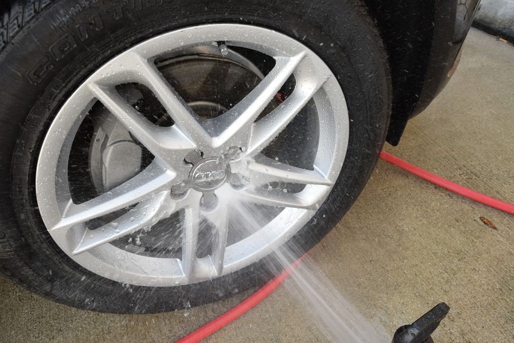

Mist on, (Make sure you get inside the barrels as well)
Rinse off.
Notice all the beads. (after)
No more puddles, the barrels are protected. This is going to make the next cleaning much easier.
More beads.

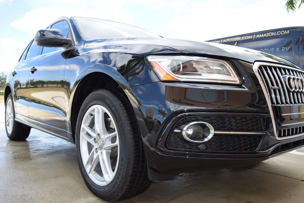

After Shots
Hydro Blue is really fun to use, To see the water behavior change before your eyes is really exciting. Hydro Blue really does provide a nice candy gloss that is super slick to the touch and makes drying the vehicle a dream. It is great to maintain your current existing McKee's 37 Paint, Wheel, Or glass coating.
As you seen from the before pictures this car had no wax/sealant at all, To go from water puddles to a water repel magnet in the matter of a spritz and rinse is awesome.
