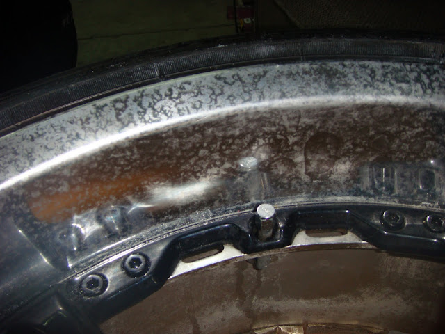

Hi all,
Need urgent help with customer's rims. There's 1 rim which was stored in the garage with the other rims which was piss on by a cat and left some nasty stains. I've tried just about everything I have and know to remove it; clay, polish/compound, vinegar and warm water, glass stain remover, tar remover, autosol, even tooth paste...I actually thought of coke. None of them worked. Anyone care to share their ideas and experiences. Appreciate the help. Feed back please
Here are some pictures:

The problem is there might be some kind of clear on the rims, or even the chrome itself has been pitted by the acidic nature of animal urine. If that's the case they may even need re-chroming

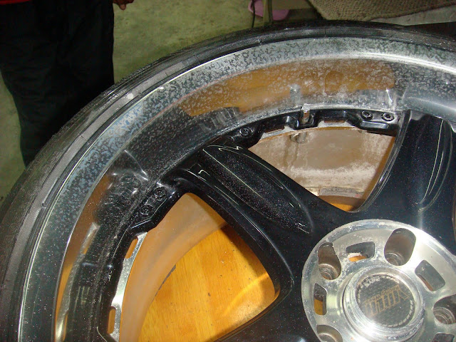

Those are VOLK Racing wheels GT-C and they are 2pc Forged Outer & Cast Center. Try using the P21S Gel Wheel Cleaner and than the Wenol Red and the Wenol Blue. If that doesn't work than try using The Wenol Red with 0000 Steel Wool. Last option is to take the wheels to a Machine Shop and have them professionally polished out. Volk makes awesome racing wheels and are expensive hope this helps.
These are not chrome wheels.

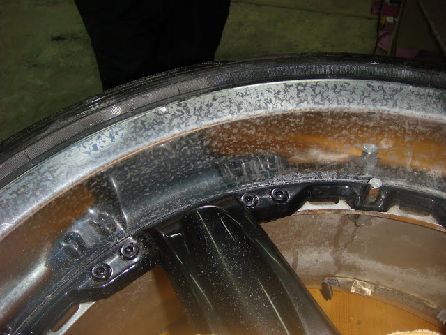

The wheels appear to be etched and I'm not so sure they are actually chrome. You'd want to be positive about the material and coating first before getting aggressive.
Looking at the back side of the barrel, it seems they might be cleared aluminum based on some of the haziness and what appear to be defects in the protective coat, rather than actual chrome. If the wheels are aluminum and clear coated by some material, they need to be refinished (most likely by a professional). The coating needs to be stripped, the wheel polished to a high degree, then a protective coating is applied. Probably much more effort than is worth pursuing as a project, but with the exception of re-coating the wheels with a durable product, stripping them and polishing the wheel can be a DIY effort.
Now if the wheels are actually bare aluminum (should see black residue when polishing), these can be brought back with some tenacity. I'm thinking you might have to do some fine sanding to remove the pitting and etching, then use various levels of metal polish to remove the sanding marks and haze. But go through the polishes first before touching the sand paper, since completely removing sanding marks from aluminum takes considerably more effort than someone accustomed to working with painted finishes expects.
