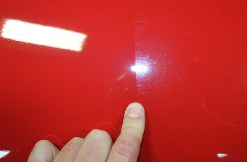

Test spot for product starting with least agressive. In a few months rupes I bird will be my tool for this correction but for now the way I've been doing for quite some time...

That was a 04 merc sl500 125k on her so it needed some correction. Previous owner had it since new (female) long nails and wore a watch on her right hand.
Few years back a supplier of hi-buff came to me with these dowels with tips on the end of them.. I asked what the hell are these for.. He said what ever you can use them for hi-buff is sick of throwing out spent foam from the middles of their rotary pads. So I took in a bag of yellow(cut) green(lightcut) blue(polish) and white (finishing). My only use really has been interior trim via drill.
Works well. Heavy correction you have to work it quite a bit but light correction works great. I used green with fg400 fixed what I needed it to.
