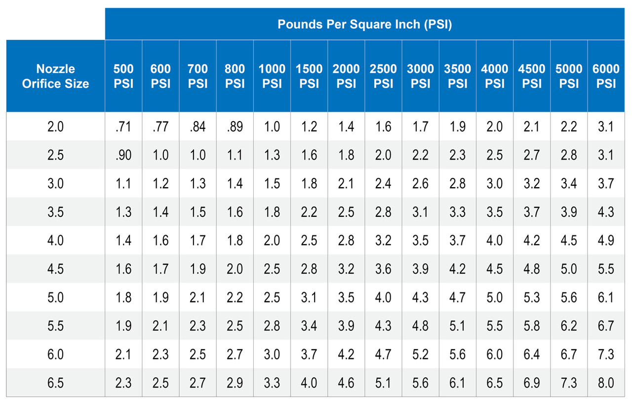

Each pressure washer needs to be treated differently when it comes to nozzle size. What works in an Active 2.0 may not work well in a Karcher K5, a Kranzle to an AR. Also, nozzle orifice size is different to nozzle angle size. You will get some minor added pressure by using a 25-deg angle compared to a 40-deg, but to the effect most people assume. Nozzle angles will be denoted with whole numbers, as in 15-deg/25-deg/40-deg. Orifice sizes are denoted with either a number beginning with a 0 (030, 040, 050 ect), or 0.0 (3.0, 5.0, 6.0 ect). Below is a basic chart, but again, you may get some variance depending on machine. Notice how small the increments are, its a fine line between great flow and workable pressure, a high pressure/low flow setup that risks damaging the machine, and a unit that loses its effectiveness by flowing too much.

Make a few nozzle/hose/gun modifications and that makes a big difference in how effective a basic machine can be.
