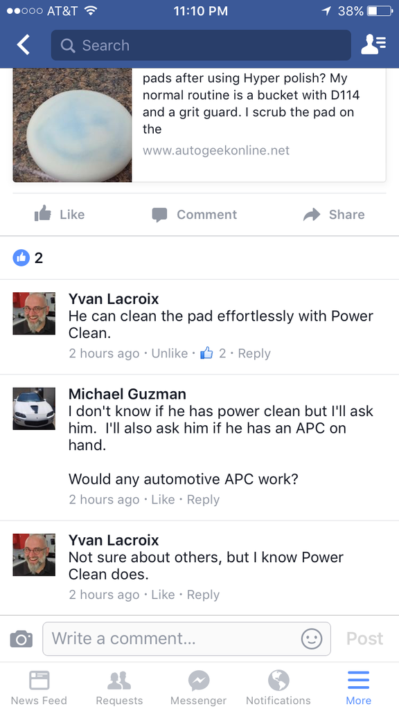

Posted your link on the optimum facebook group.
Thanks Mike
I have super clean, purple power and zep industrial purple. I will give it a shot
Might be time to pick up some power clean
