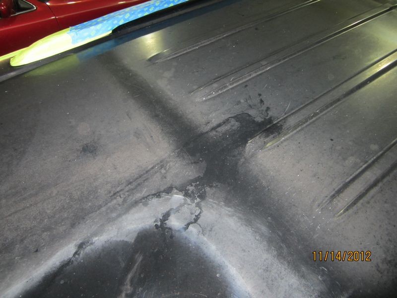

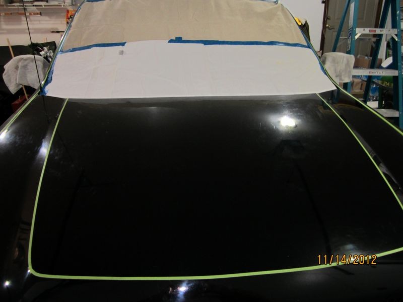

Long story short, you may need to update some products and gear but it can easily be saved. Here's a before and after of a BMW M5 I just did and it's hood was completely trashed and nearly gone due to abuse in Florida's sun. To top it off it was a re-paint. I took at with 2000 grit wet sanding then moved to 3000 grit, followed it up with CarPro Clear Cut Compound and some wool pads, then polished it back with Gyeon Primer and a white pad.
You likely won't need to sand yours as it's no where near as bad. Get in touch with someone who has one or pick up a paint thickness gauge. I personally wouldn't touch a used car like that without one as you just don't know what's been done to it and how much paint you have to work with.
