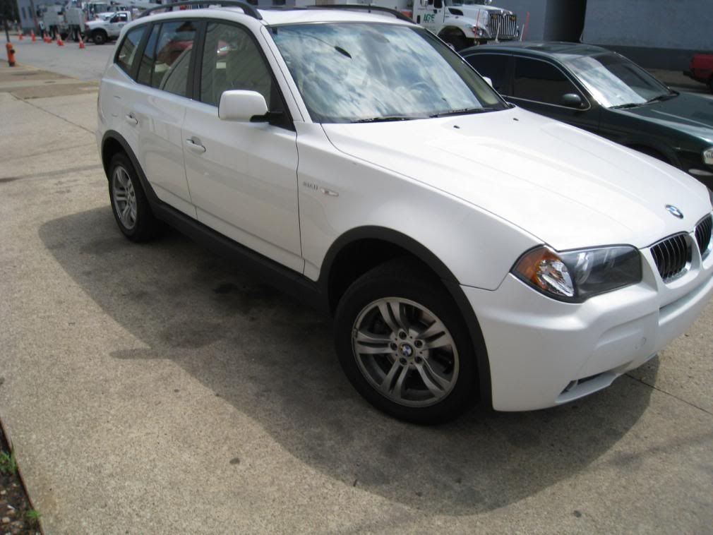

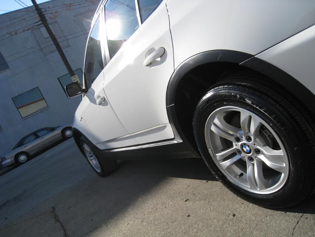

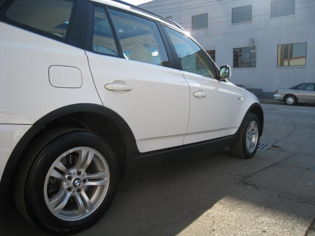

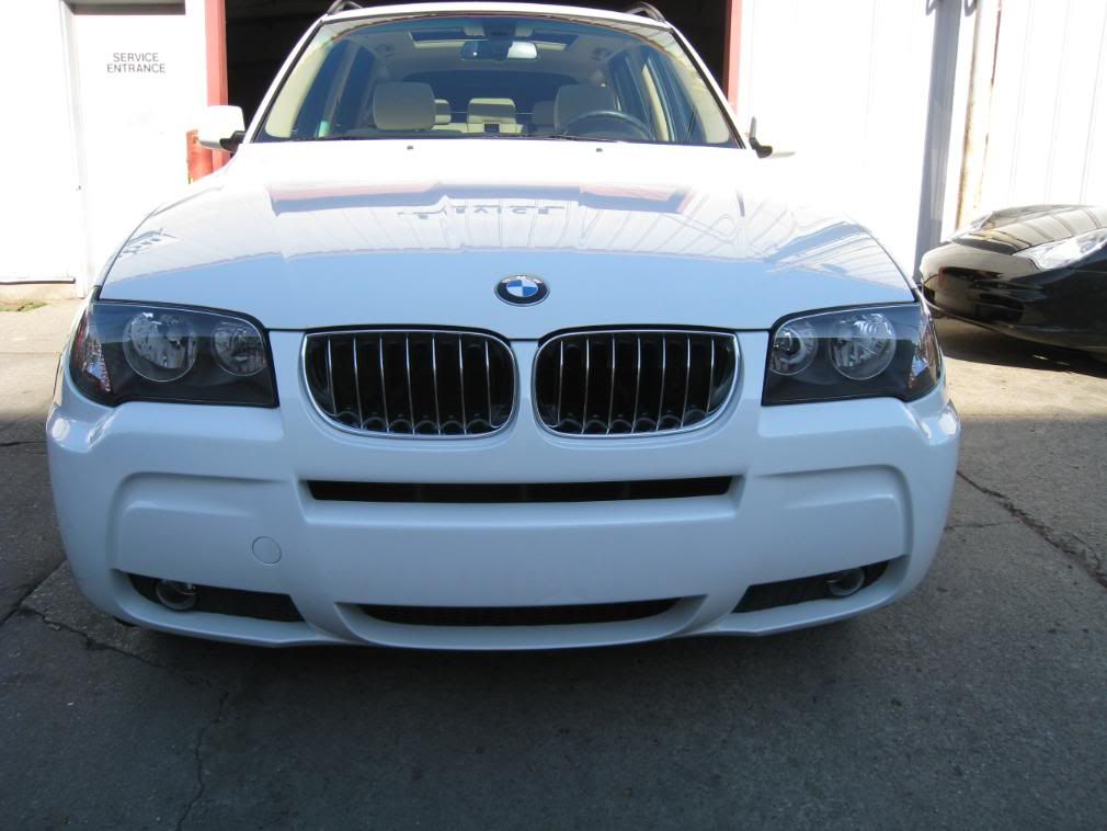

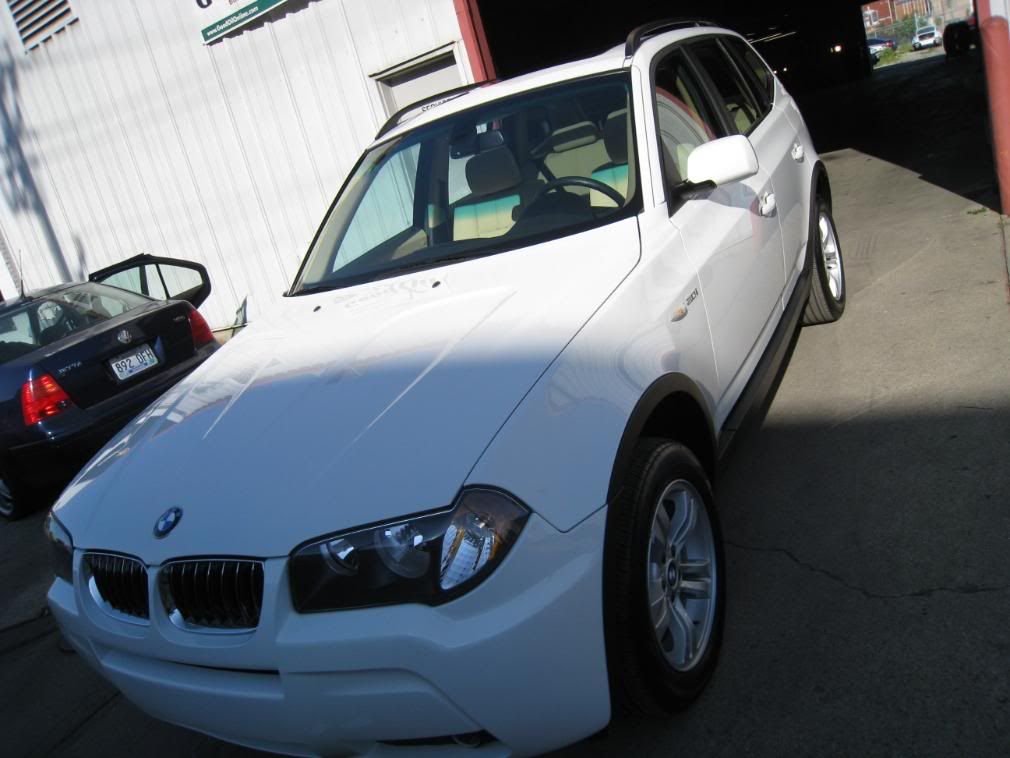

Here is the other X3 I did with the Black and Red one It was a 2006 3.0 with 20 something thousand miles Decent shape, it had been given a auction detail so it was really just paint correction and a mor thourough interior touch

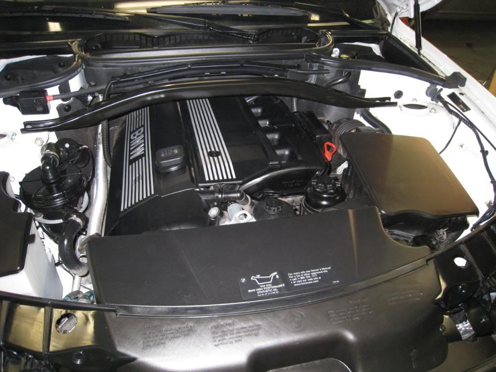

Engine, Wells, Tires and Rockers were degreased with Purple Clean
Wheels were cleaned with HF Acid
Citrus Pre Soak
Wash-Clay Process with Wash and glow
Rinse and dried with purged air and chamois

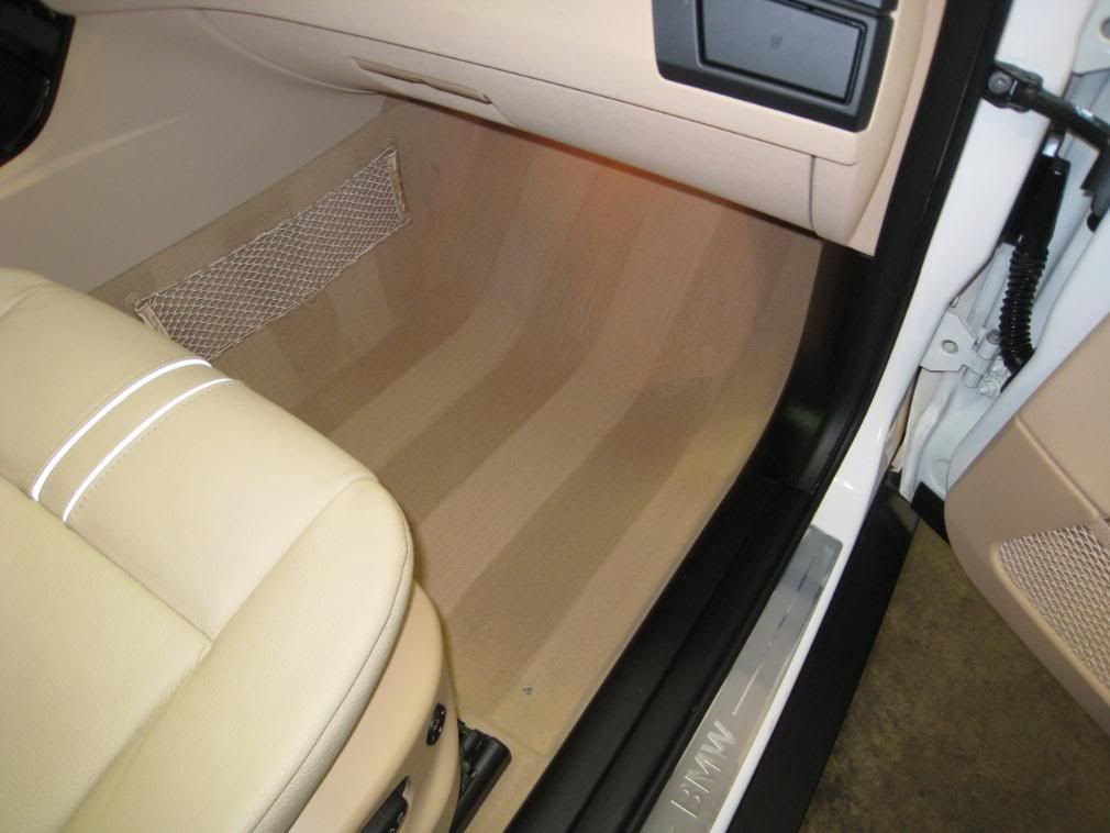

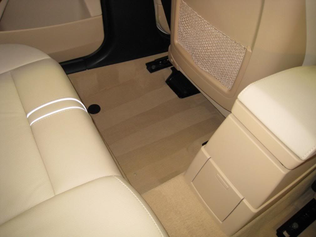

Interior Tools used:
Matco air polisher w/cyclo brush, Various brushes, Shop vac, extractor, Comp air, plastic upholstery tools for crevices, scotch pads, magic erasers
Chemicals
Fabrik Magik
Blue clean apc
Mr Jinx
Sprayway spot
Sprayway glass

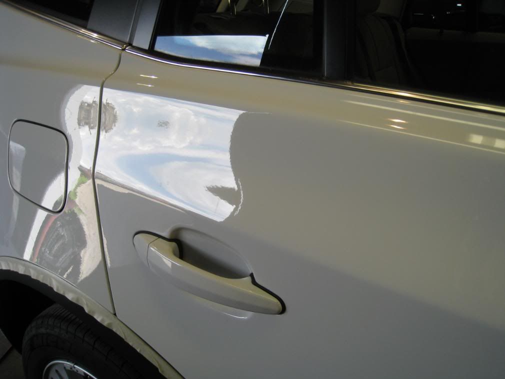

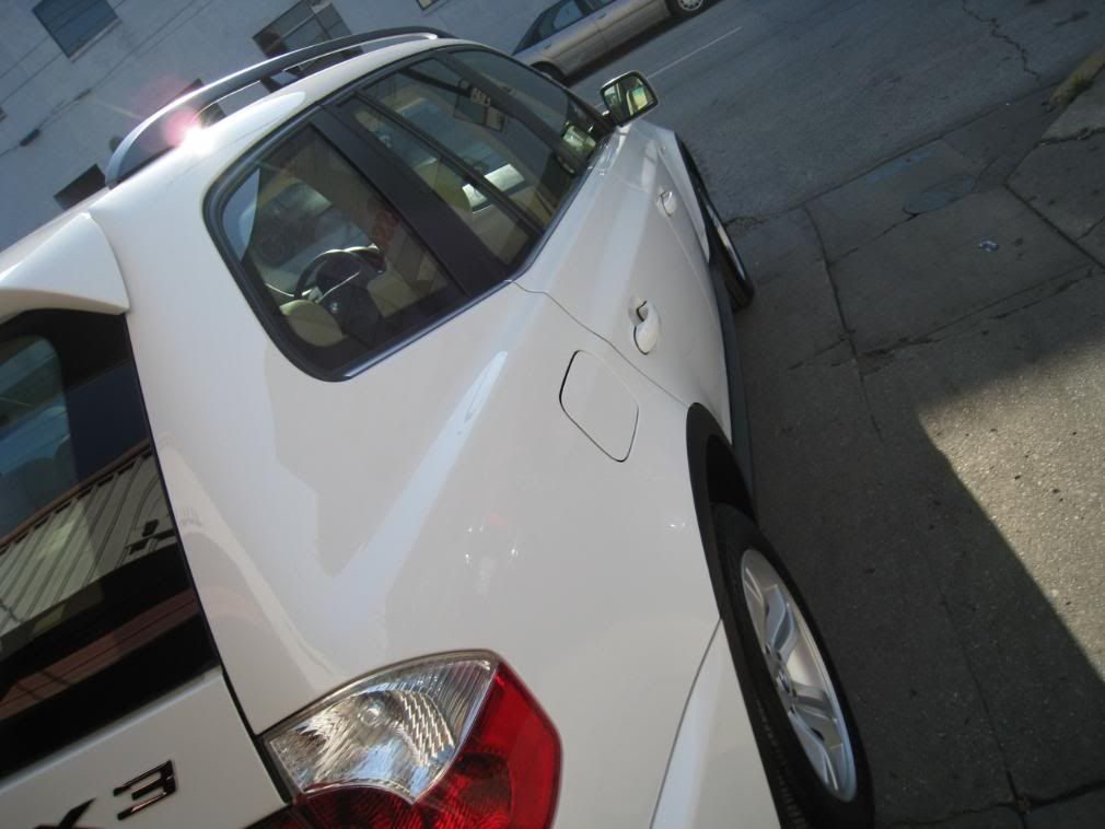

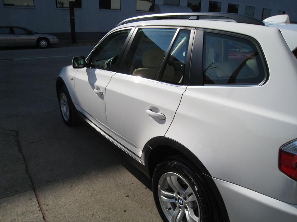

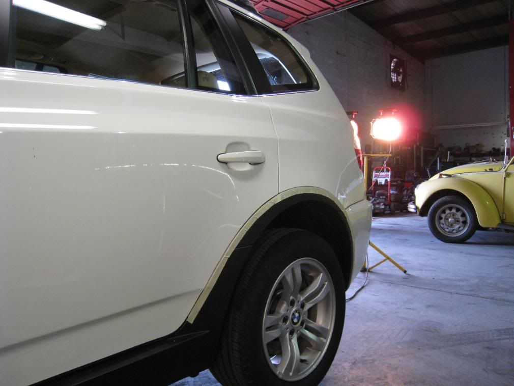

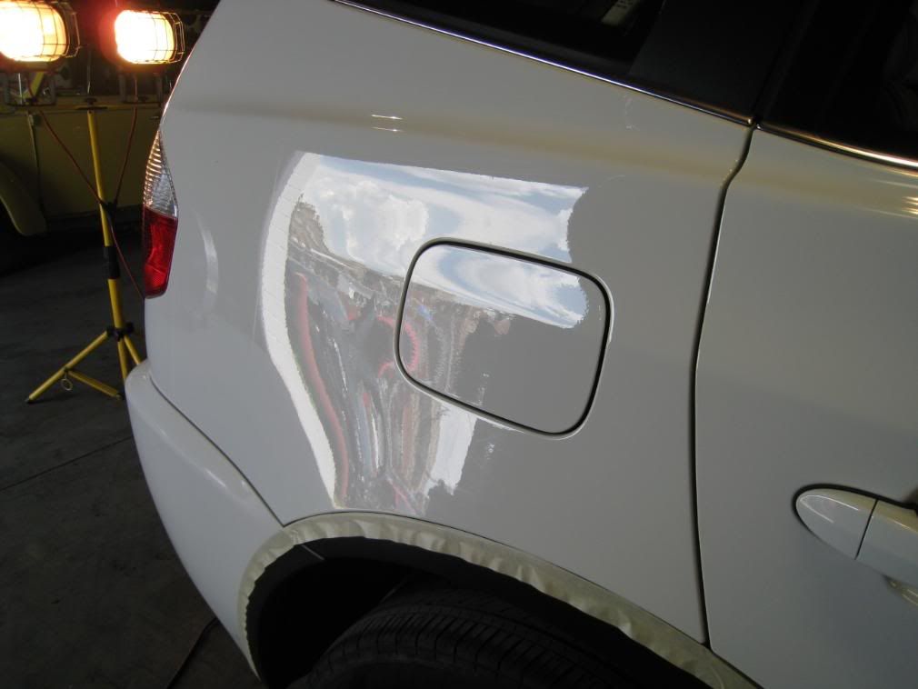

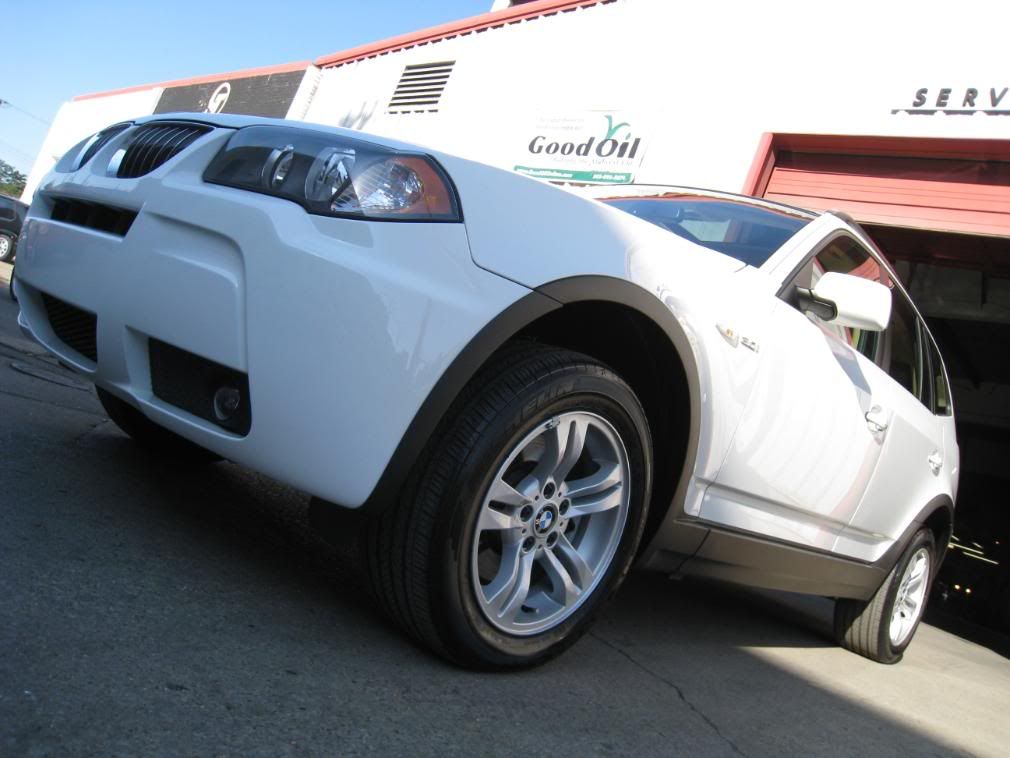

Exterior(paint correction)
Megs DA Polish with Sonus white polish pad at 1200-1800 via Makita
Megs 20 sealent with Megs finish pad at 800-1000
Megs final inspection wipe down
Dressings
Engine/trim-quick Shot
Wells- sprayway undercoat and instashine
Tires-Ultrablue II

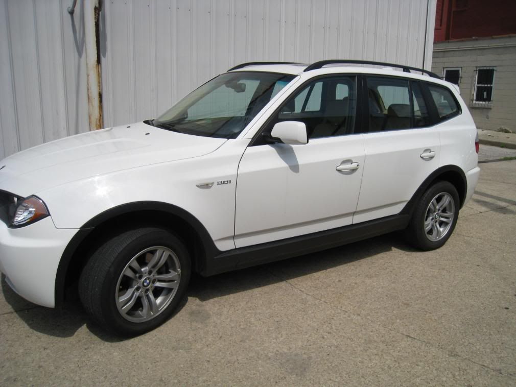

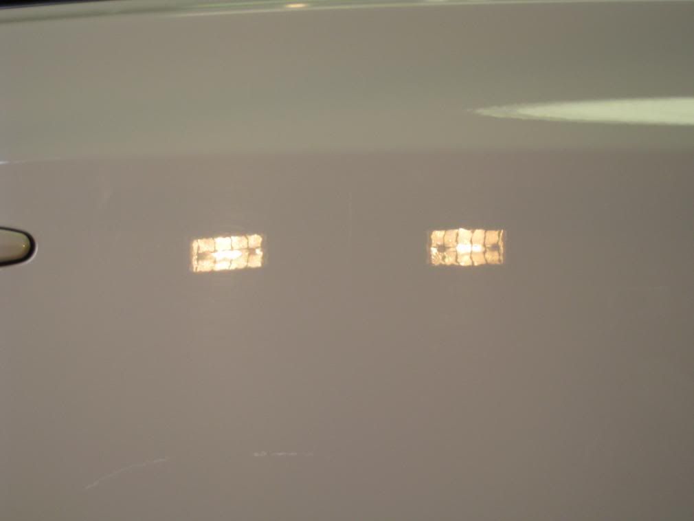

BEFORES...
paint correction...

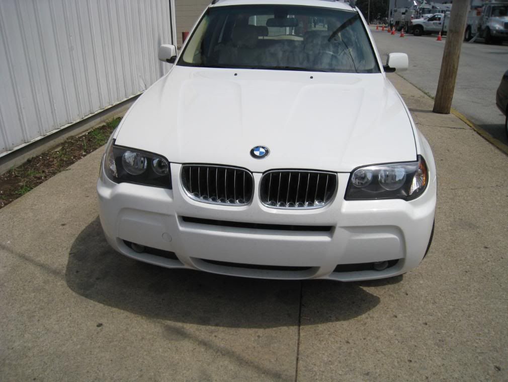

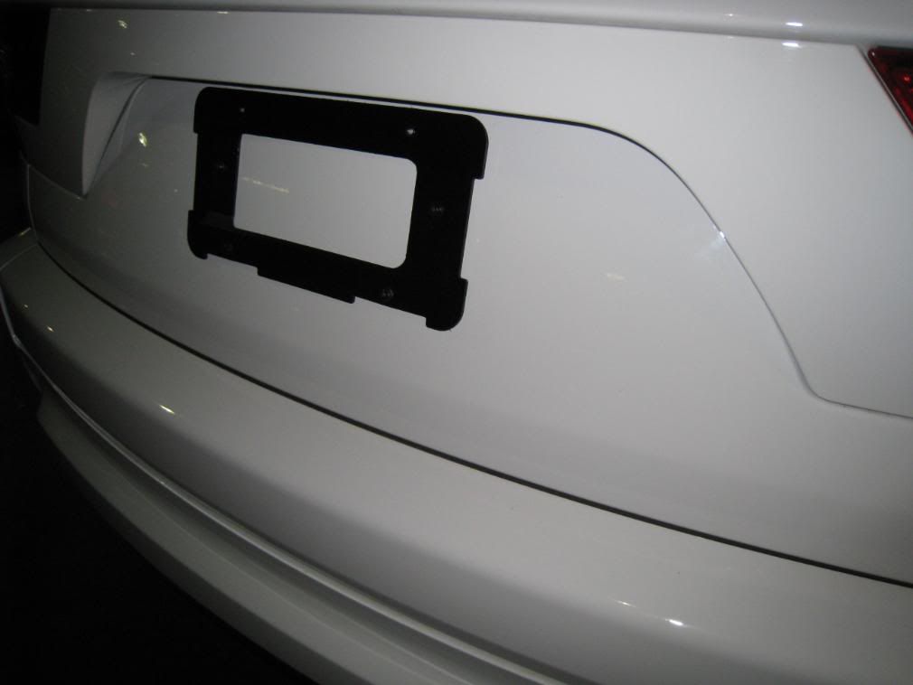

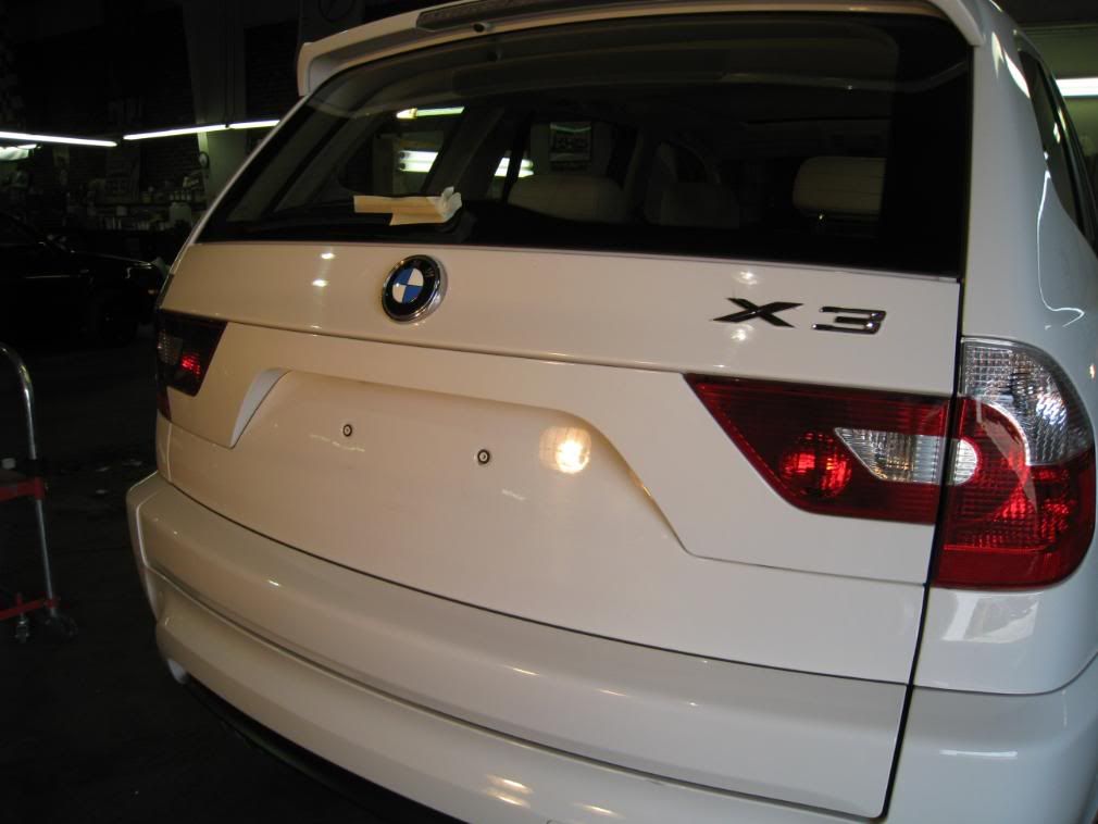

Plate bracket removed
Painted and replaced

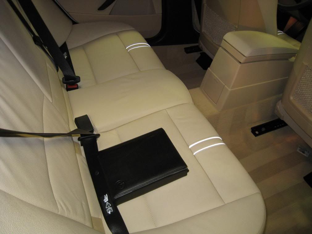

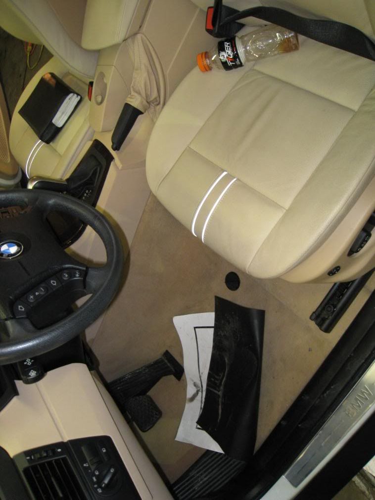

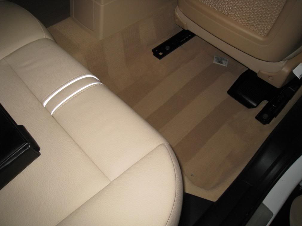

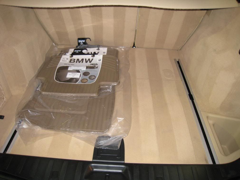

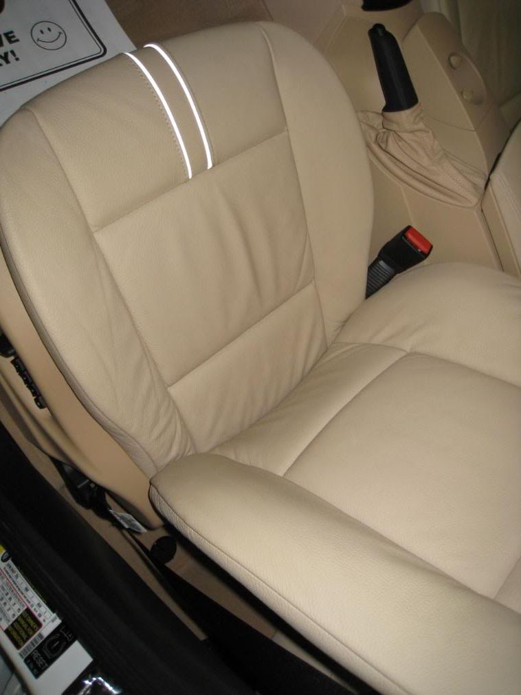

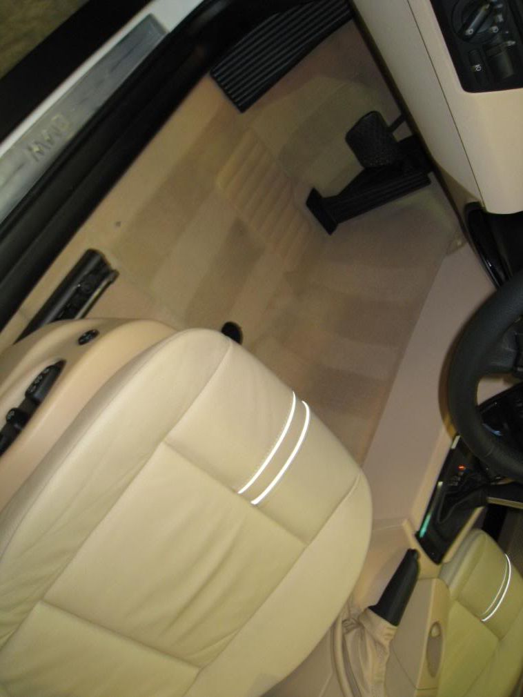

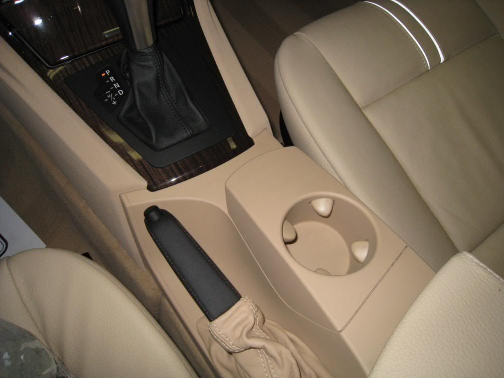

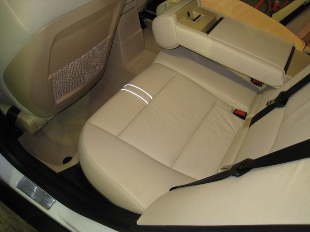

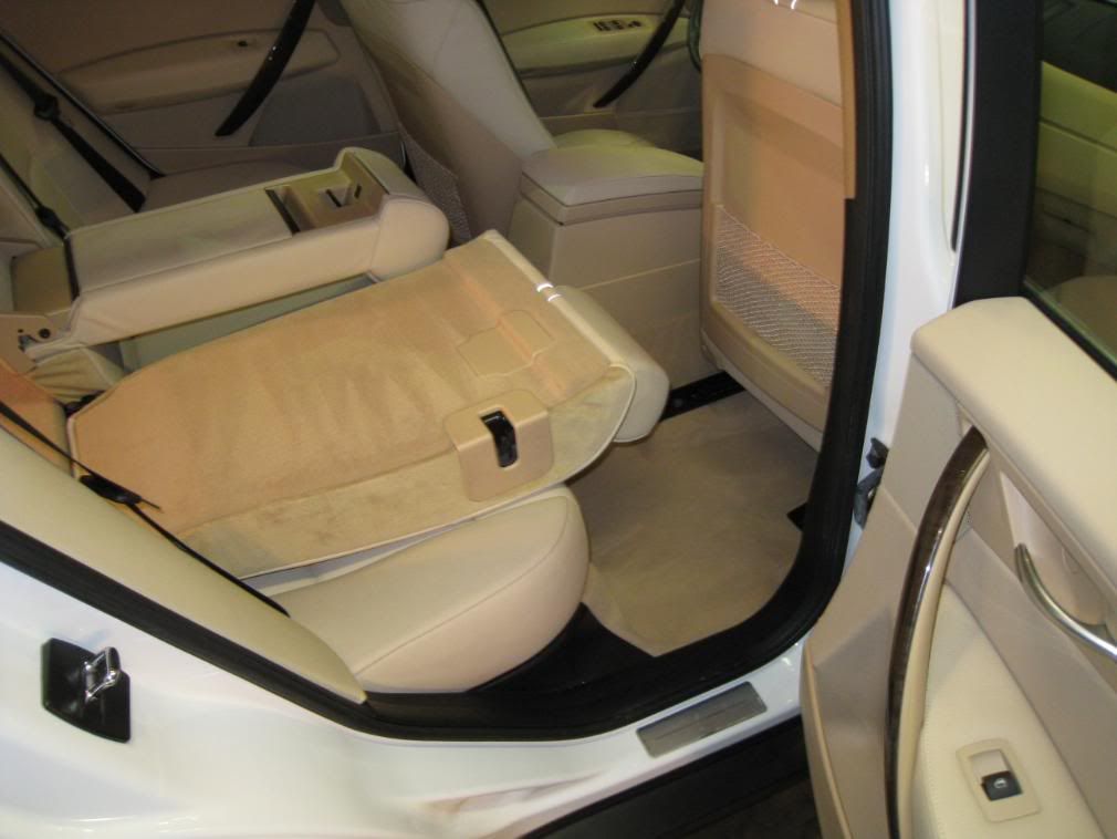

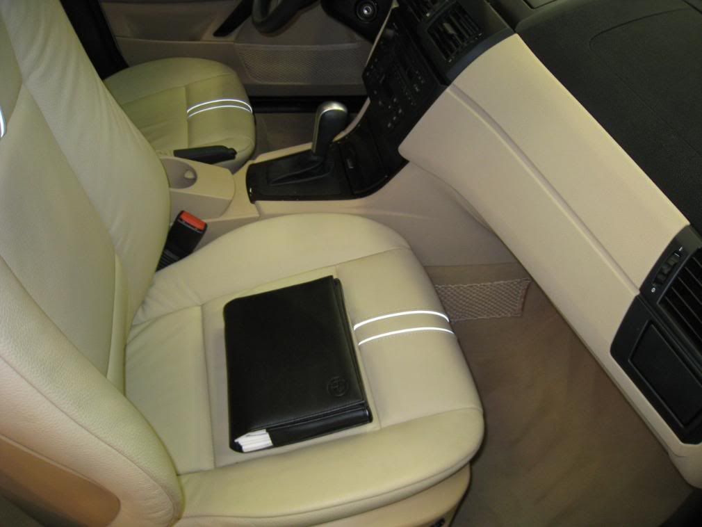

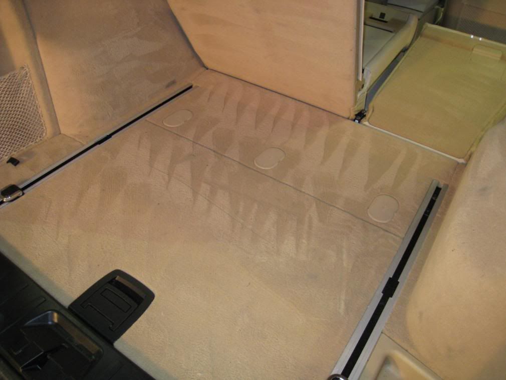

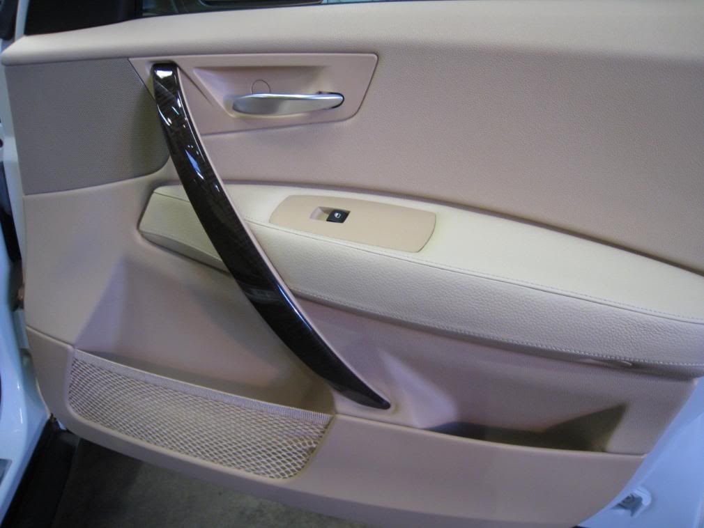

Interior shots...
great work, I like those SUV's.... are those lines in the seats reflective?
That looks beautiful. I am sure your work will be appreciated by the owner. Thats the quality of detail that I would assume most of us here on the forum are aspiring to.
