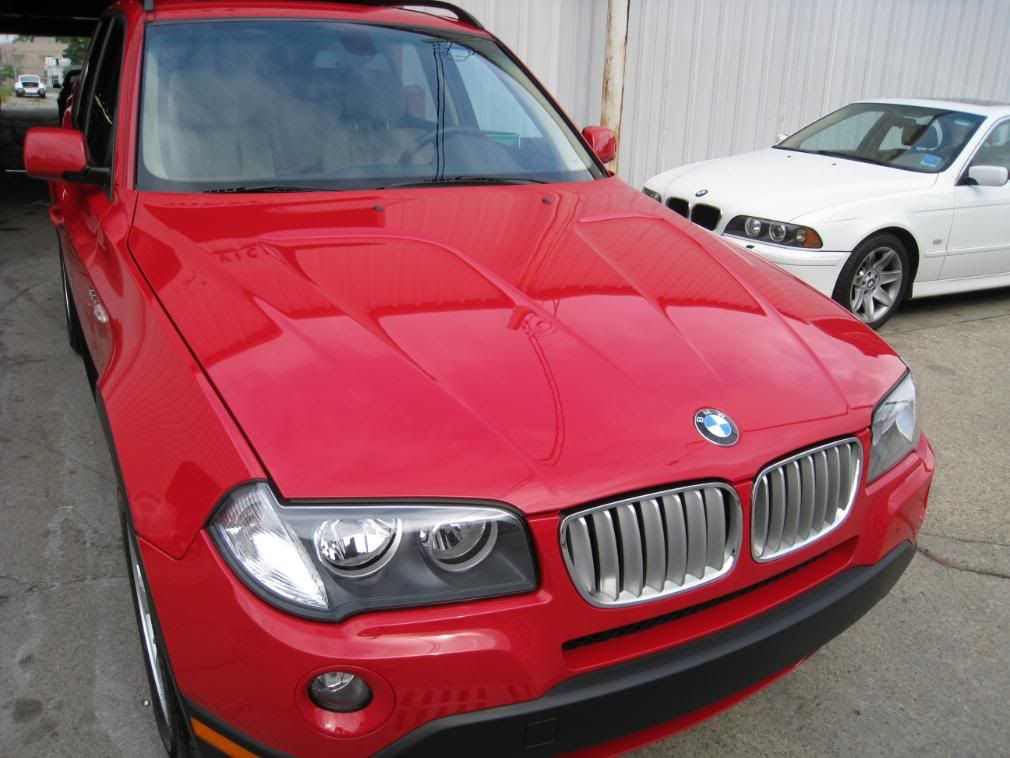

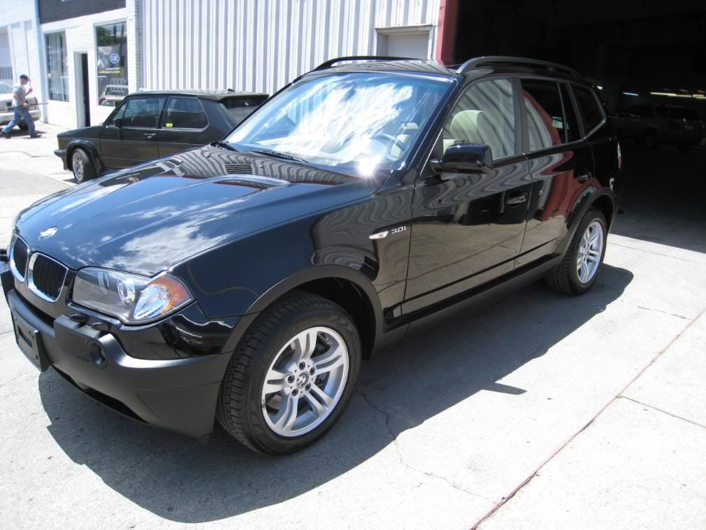

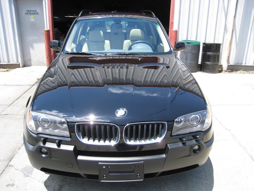

Process was the same on both, except that I had to hit about 70% of the black one with some M105 with a yellow sonus pad The red one is a 2007 and the Black is a 2004, I am working on a white 2006 now

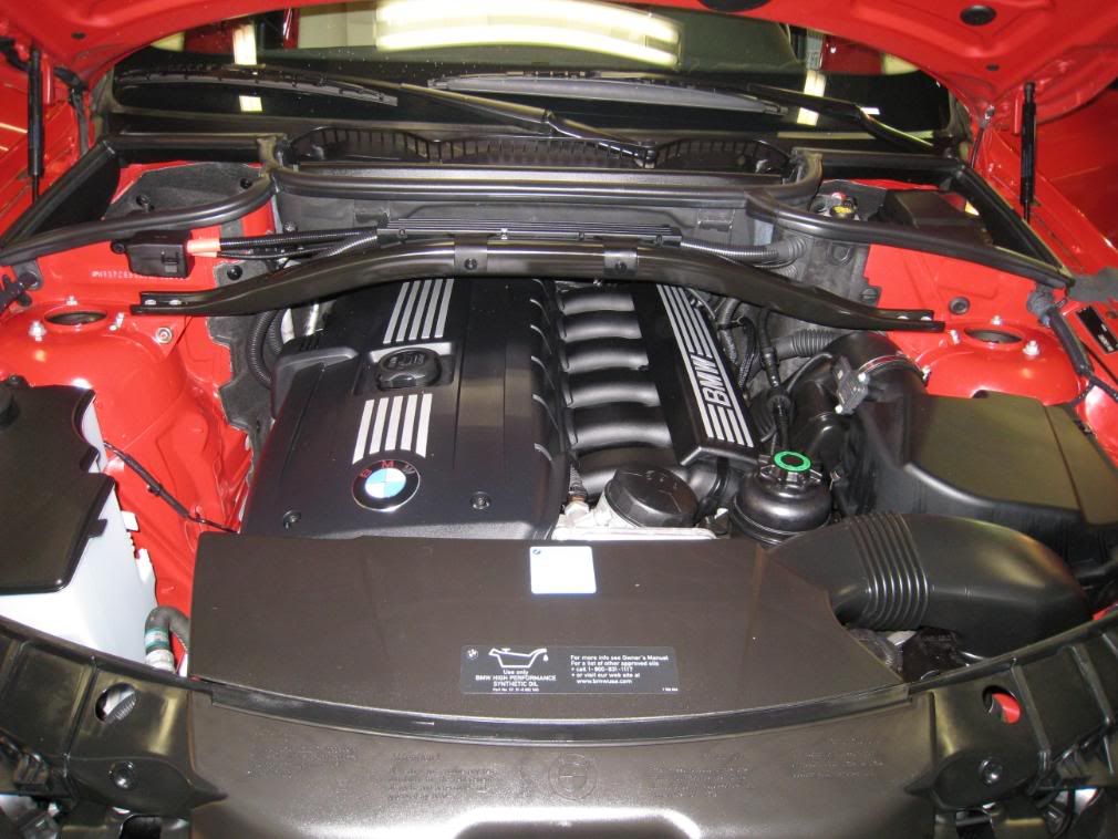

Engine, Wells, Tires and Rockers were degreased with Purple Clean
Wheels were cleaned with HF Acid
Citrus Pre Soak
Wash-Clay Process with Wash and glow
Rinse and dried with purged air and chamois

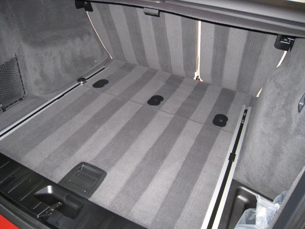

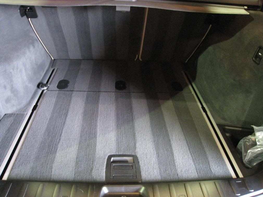

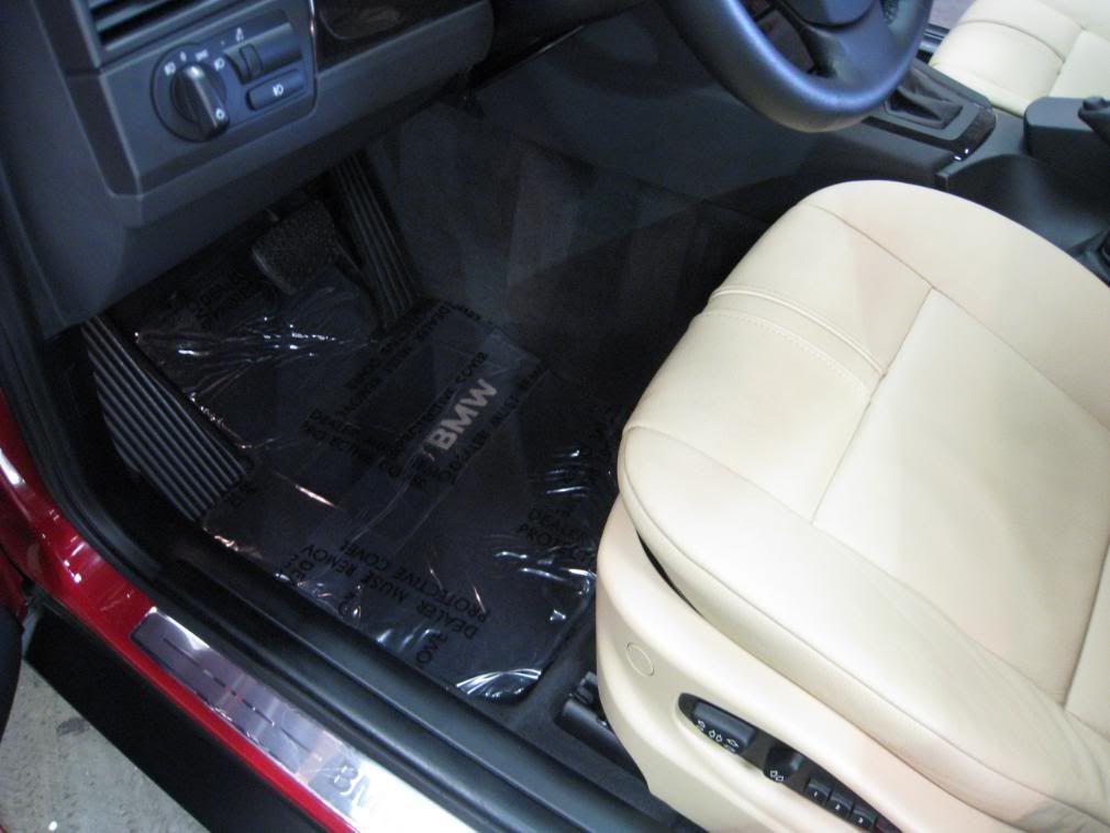

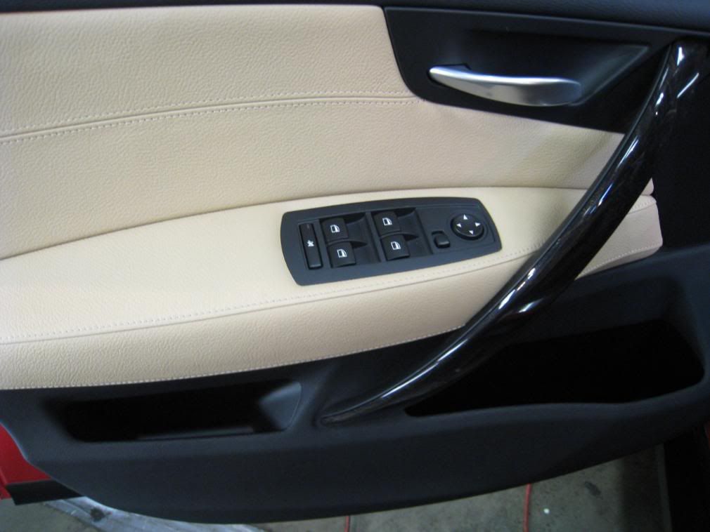

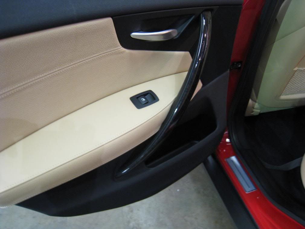

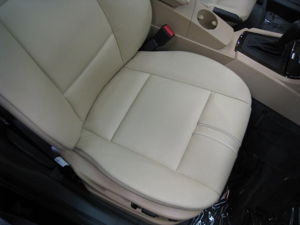

Interior Tools used:
Matco air polisher w/cyclo brush, Various brushes, Shop vac, extractor, Comp air, plastic upholstery tools for crevices, scotch pads, magic erasers
Chemicals
Fabrik Magik
Blue clean apc
Mr Jinx
Sprayway spot
Sprayway glass
Exterior(paint correction)
Megs SF Polish with Sonus white polish pad at 1200-1800 via Makita
Megs sealent cut with Instafinish Swirlaway with Megs finish pad at 1000
Megs #26 via PC
Dressings
Engine-quick Shot
Wells- sprayway undercoat and instashine
Tires-Ultrablue II
Any metal or exhaust polishing is done with Carbrite metalbrite and a silvereagle air polisher

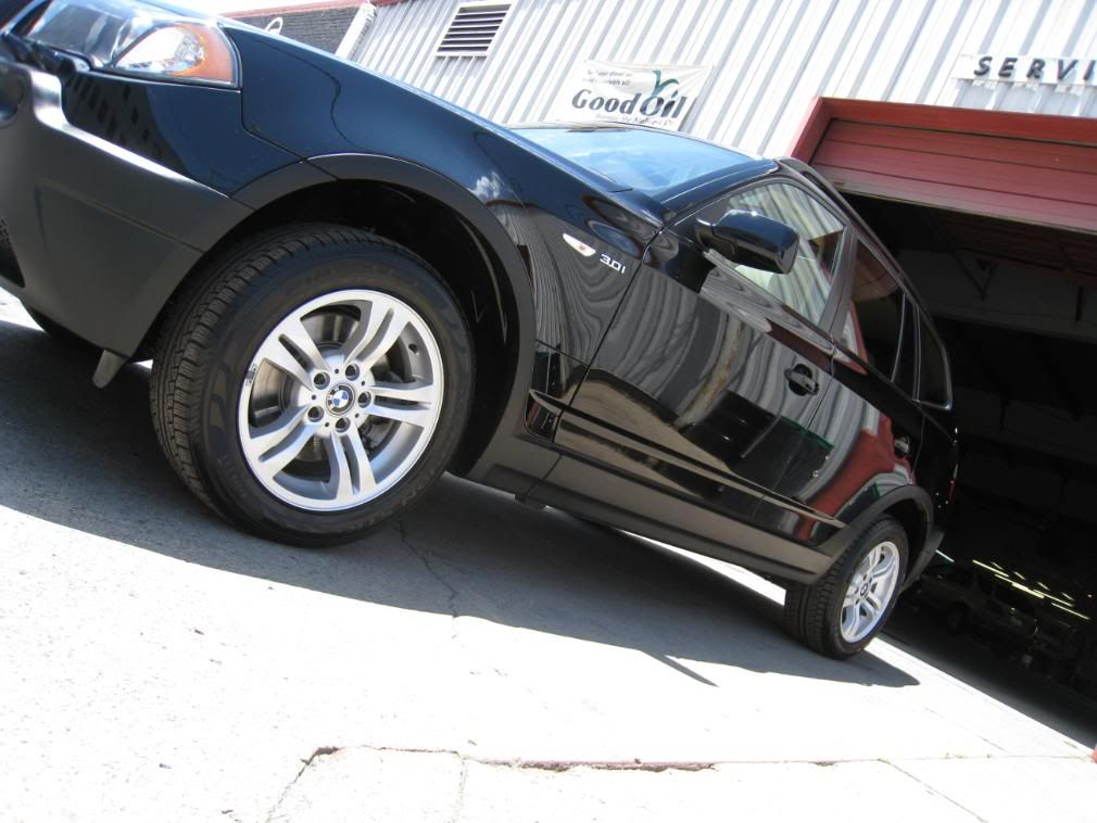

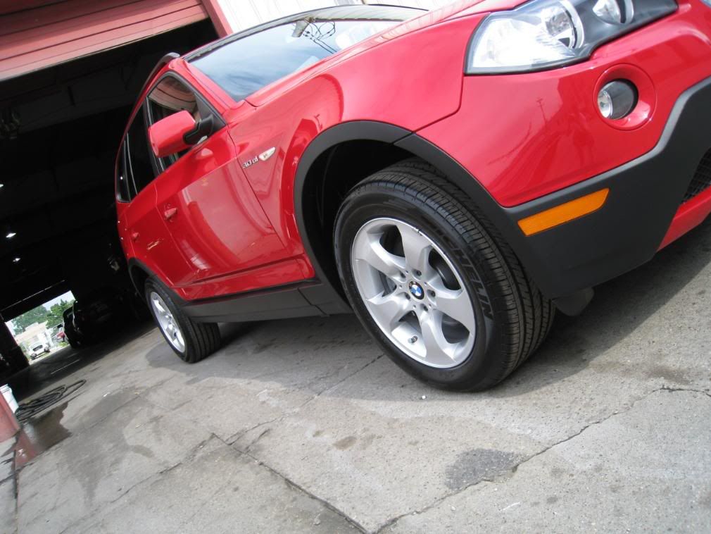

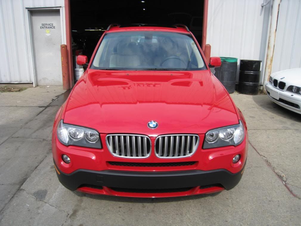

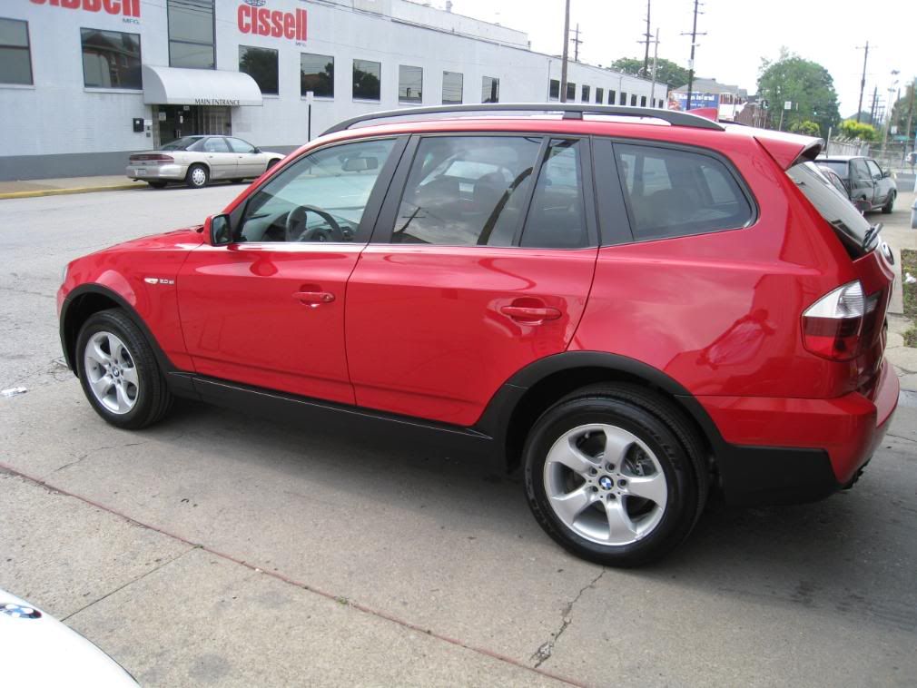

Red one...Afters only

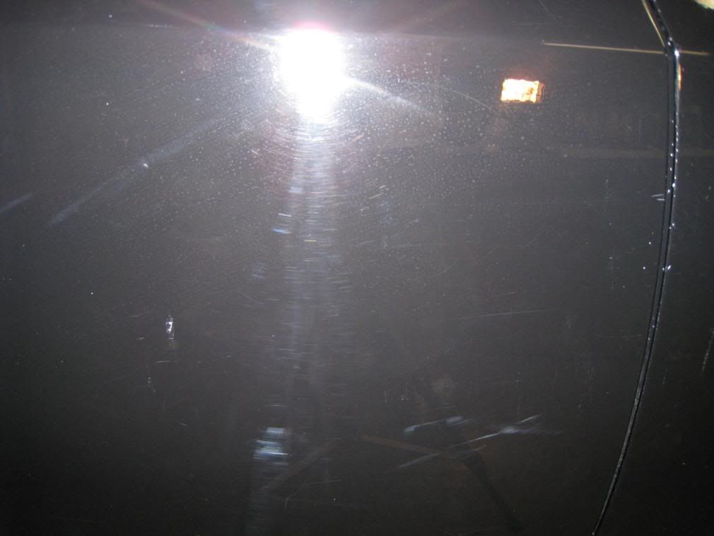

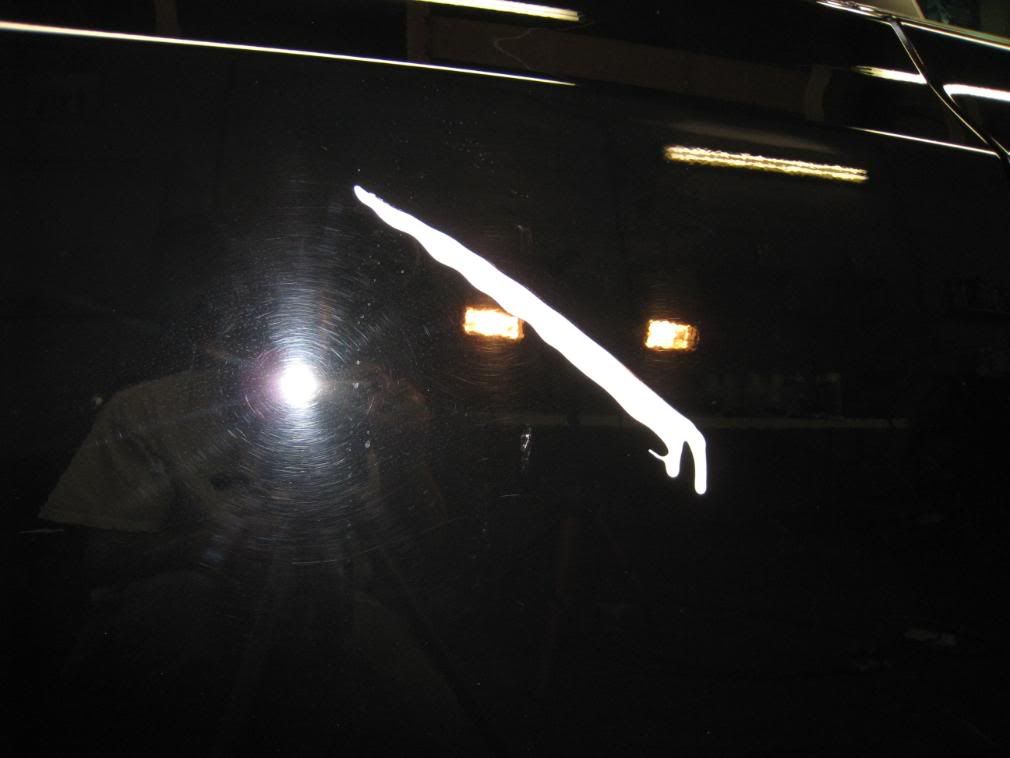

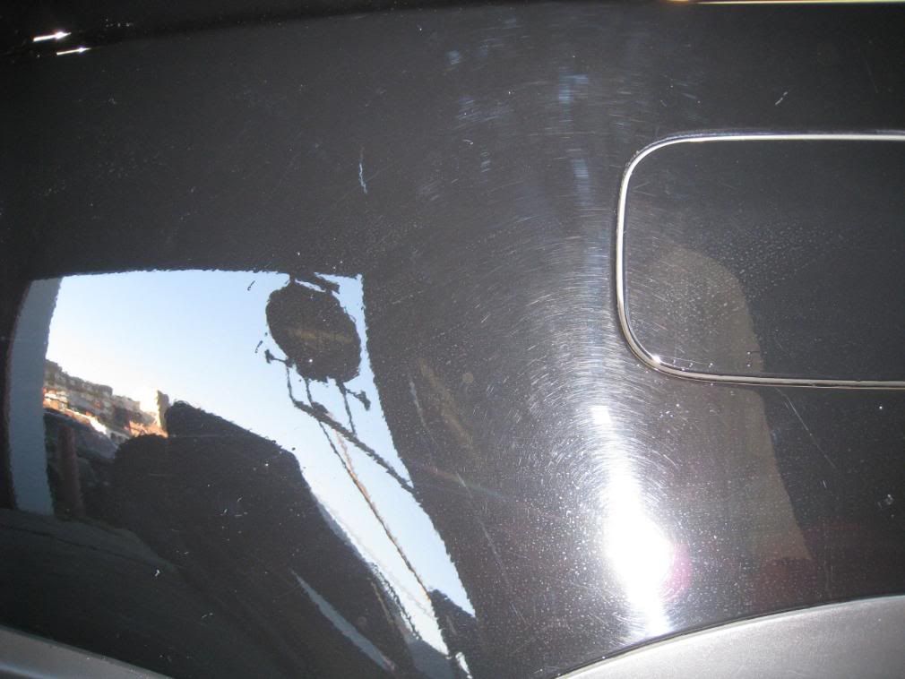

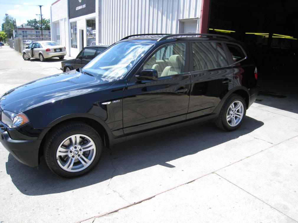

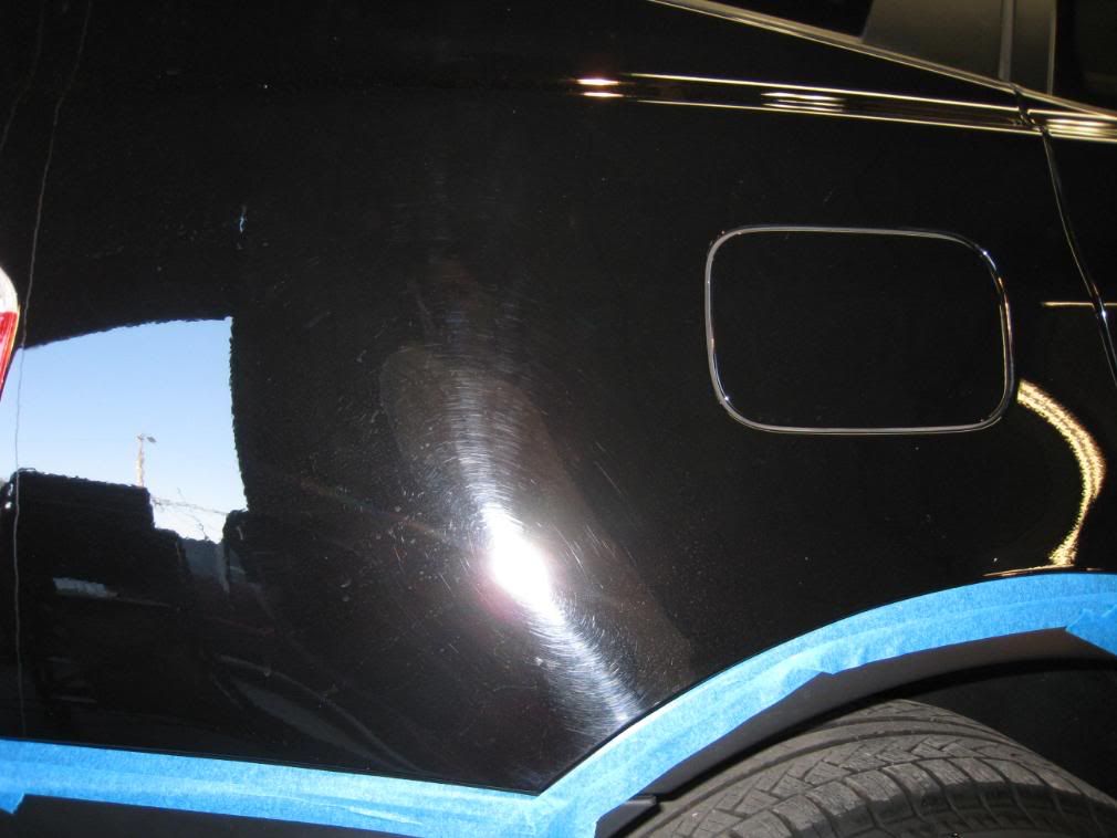

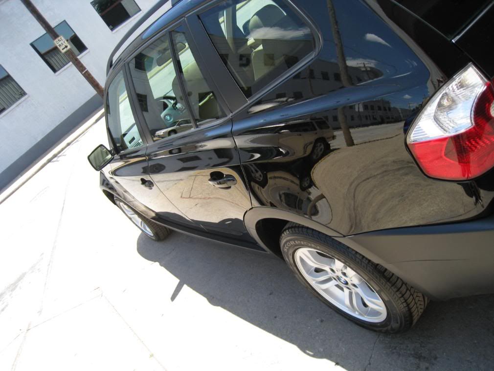

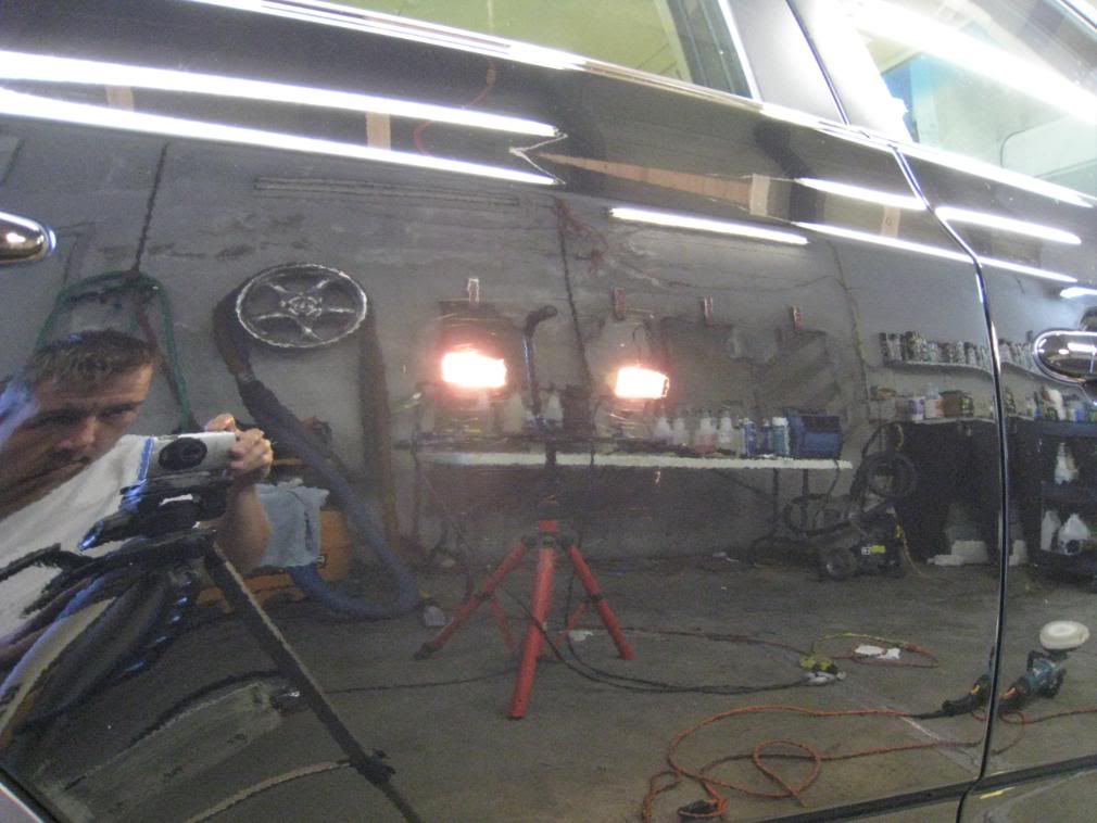

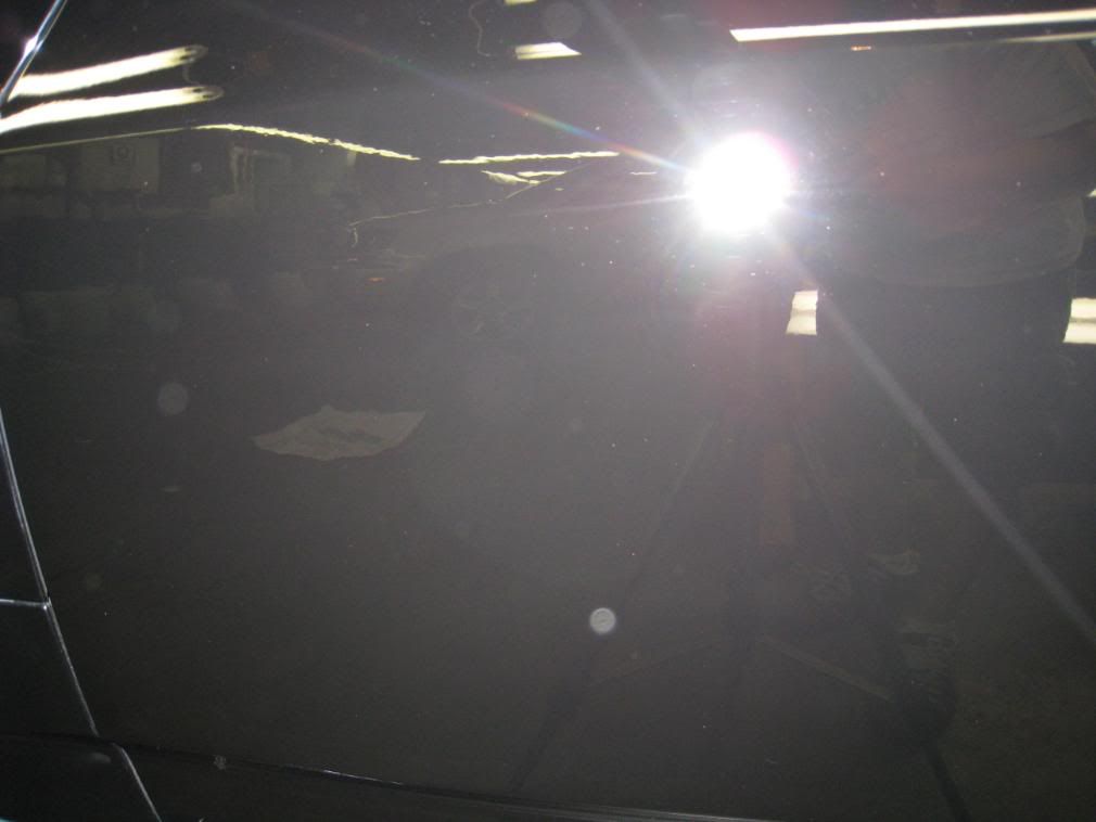

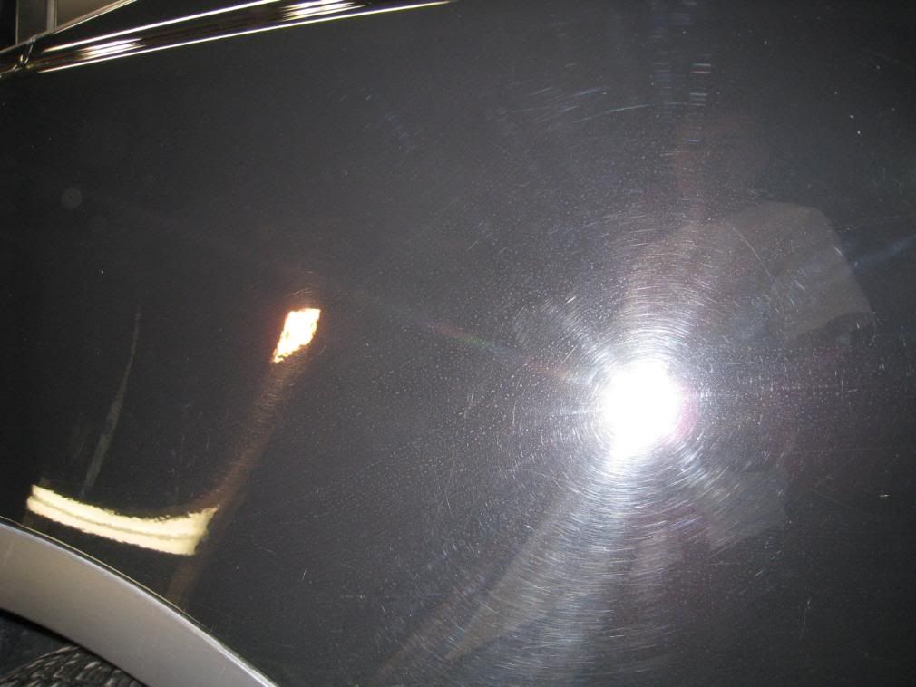

Paint correction on the black one

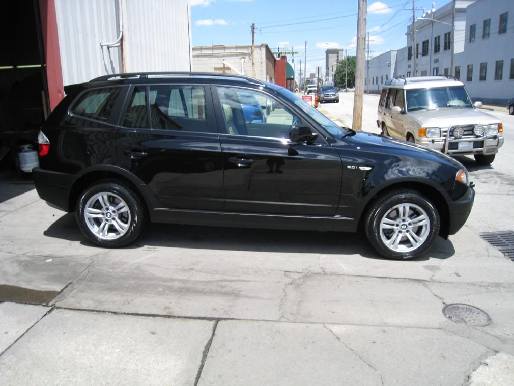

after105
rear hit with 105 and SF
corrected
