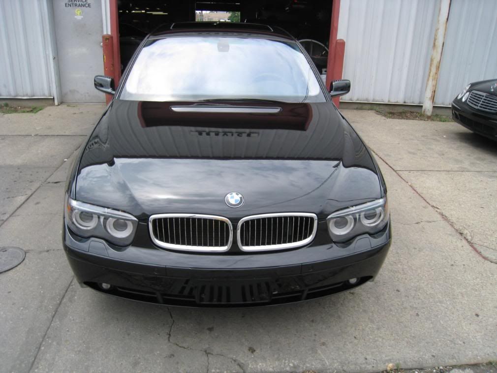

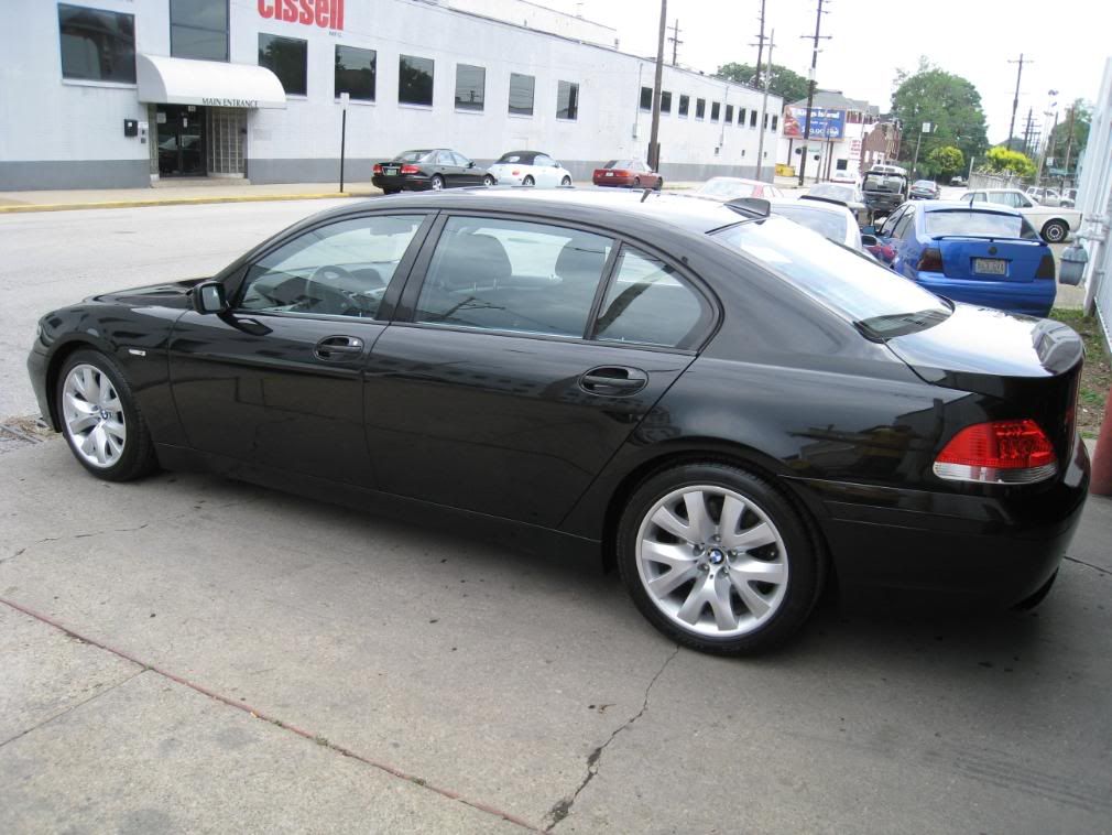

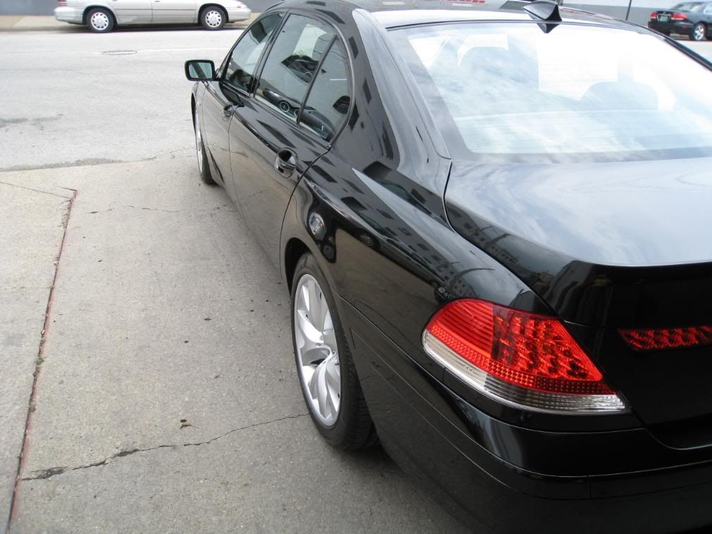

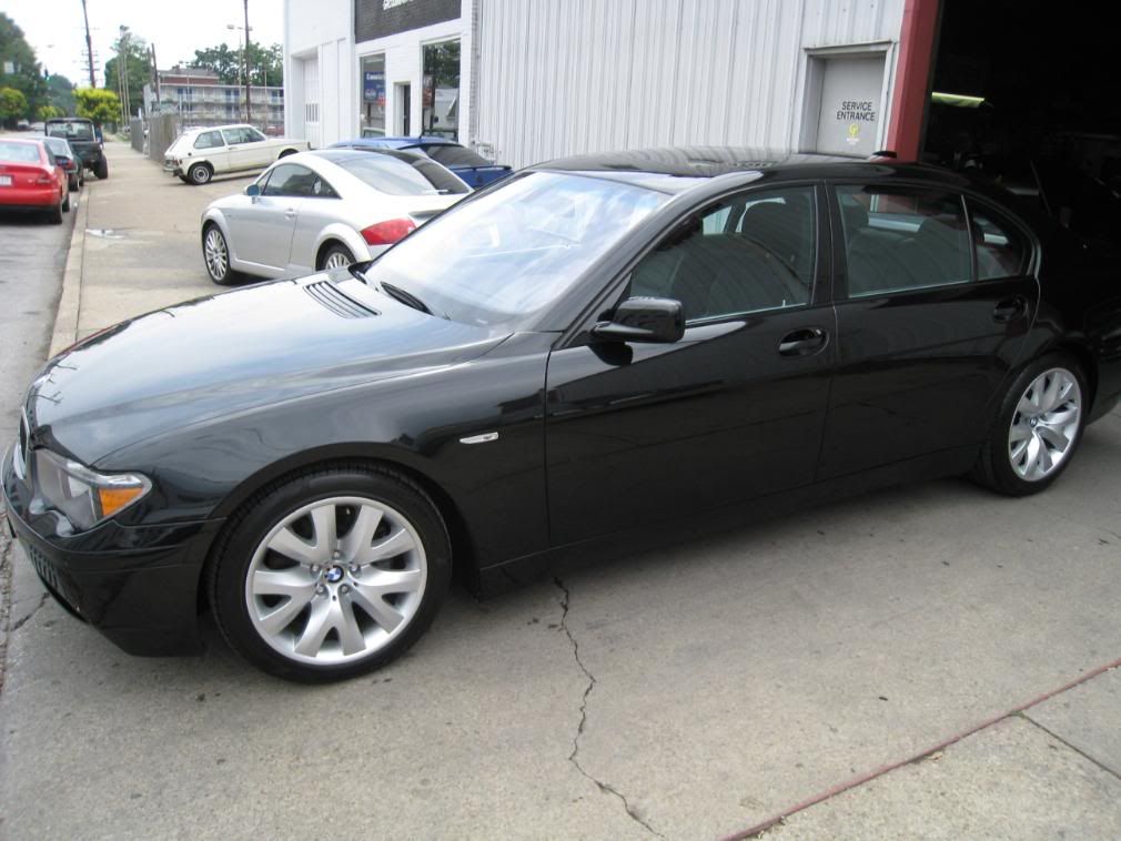

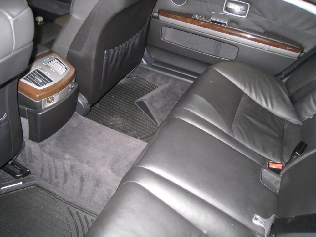

It was actually that carbon metallic, 745 49K on it

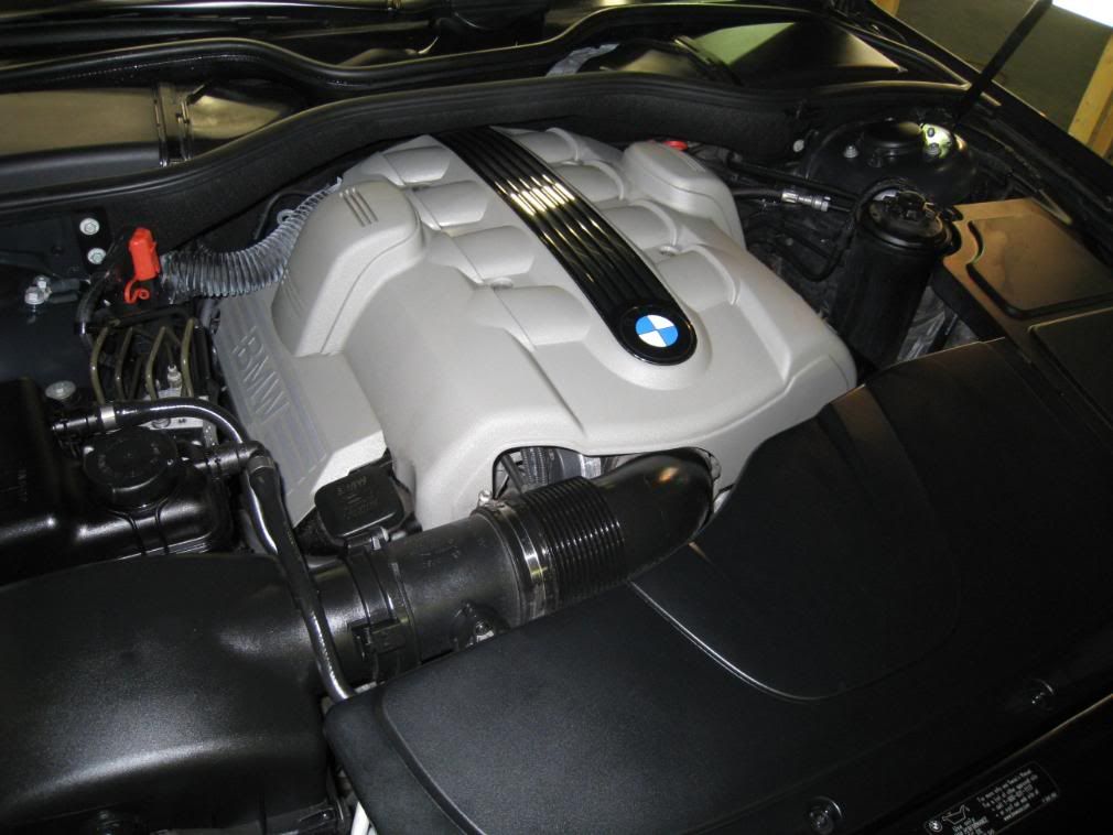

Engine, Wells, Tires and Rockers were degreased with Purple Clean
Wheels were cleaned with HF Acid
Citrus Pre Soak
Wash-Clay Process with Wash and glow
Rinse and dried with purged air and chamois

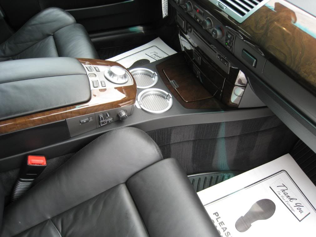

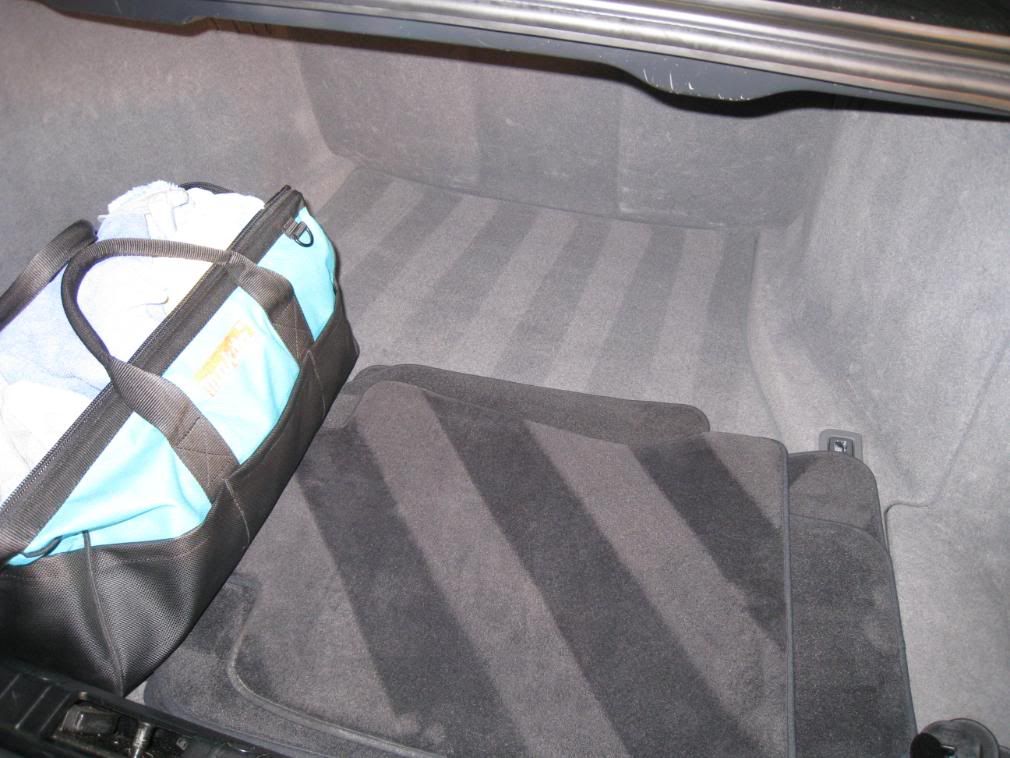

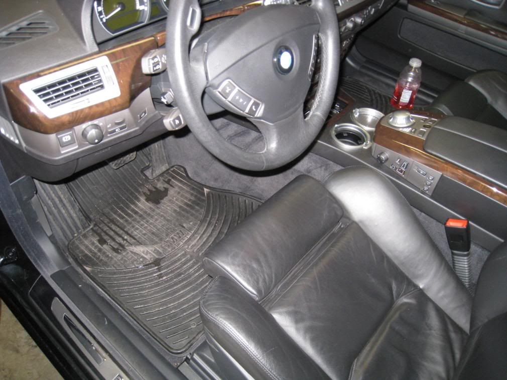

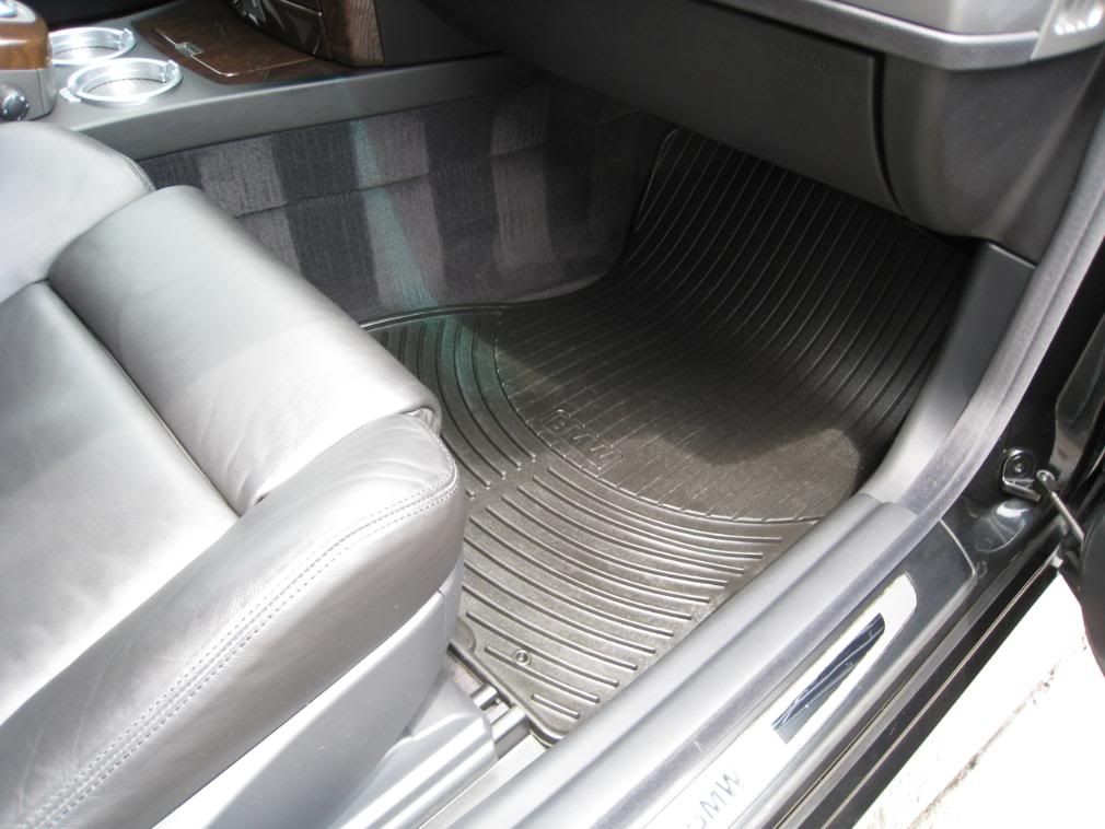

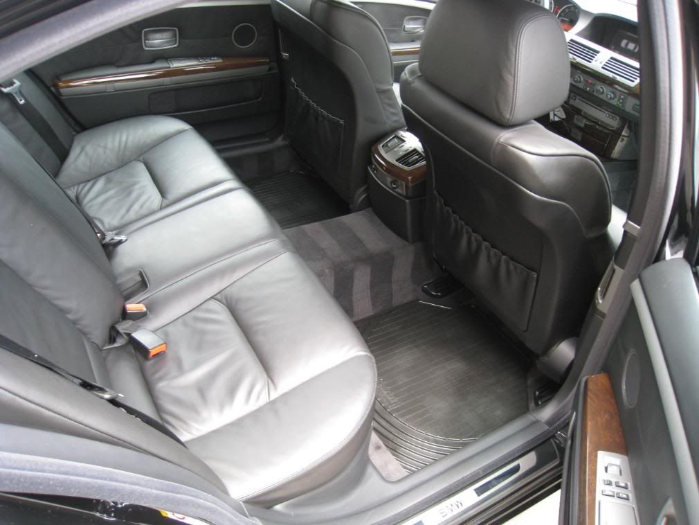

Interior Tools used:
Matco air polisher w/cyclo brush, Various brushes, Shop vac, extractor, Comp air, plastic upholstery tools for crevices, scotch pads, magic erasers
Chemicals
Fabrik Magik
Blue clean apc
Mr Jinx
Sprayway spot
Sprayway glass

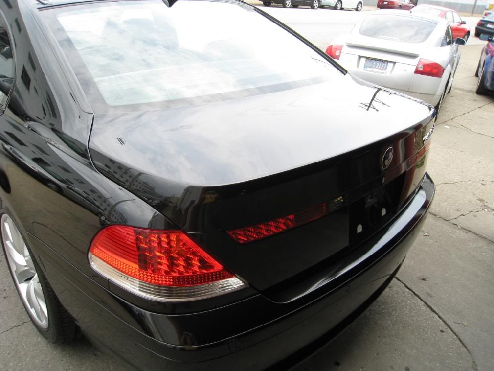

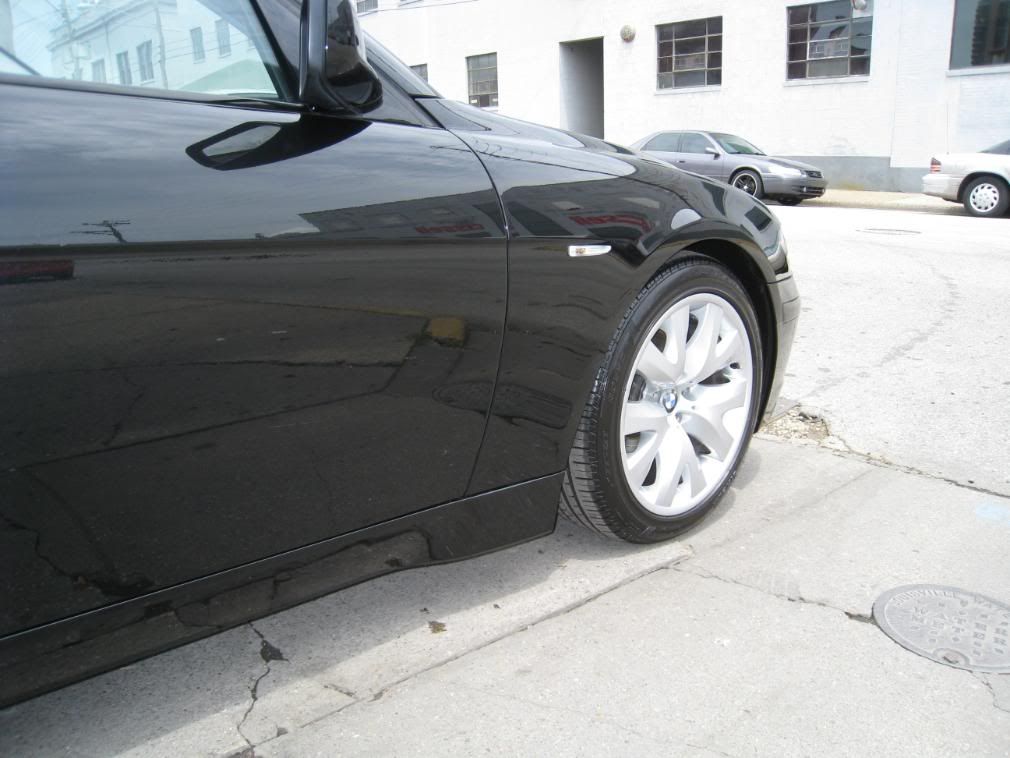

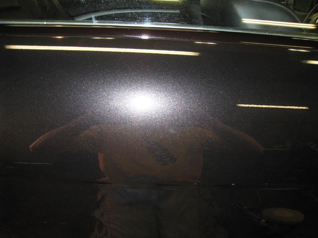

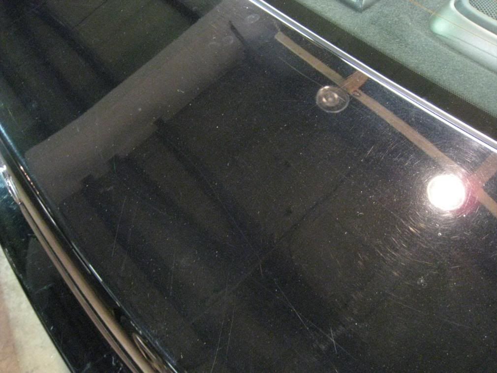

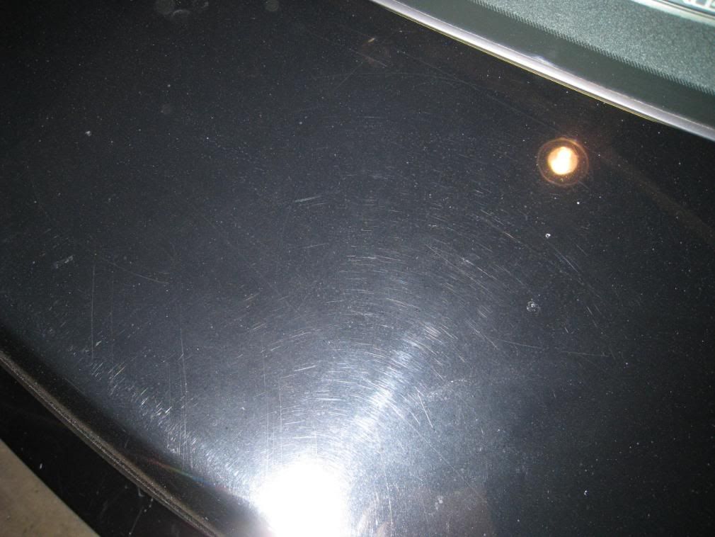

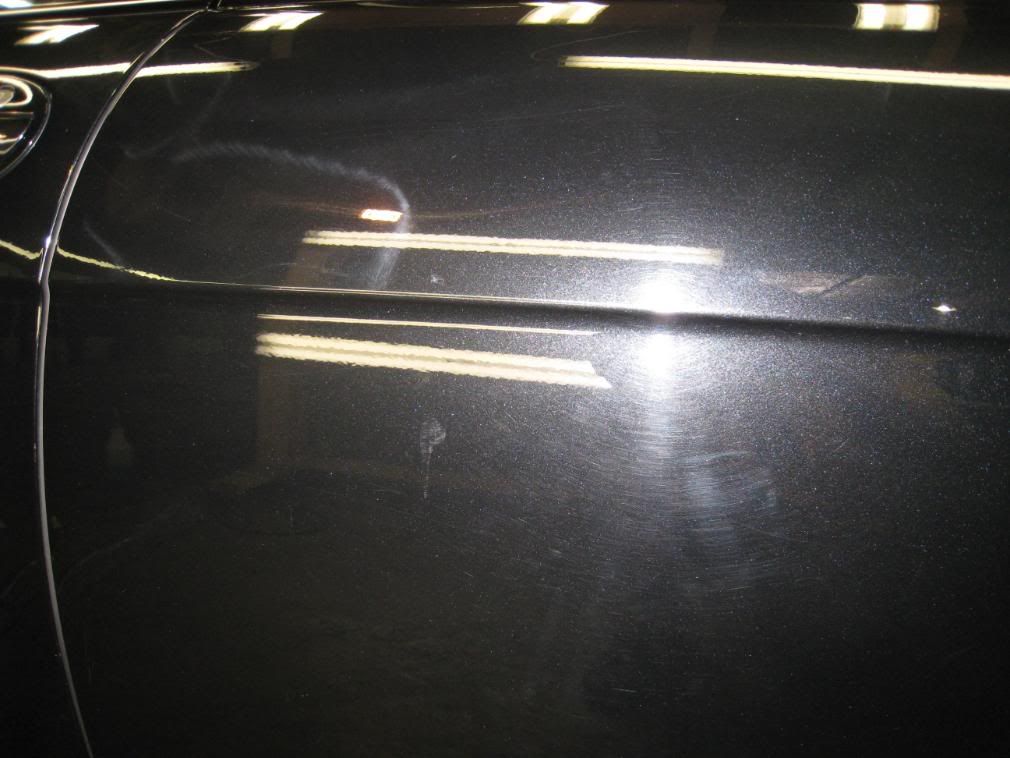

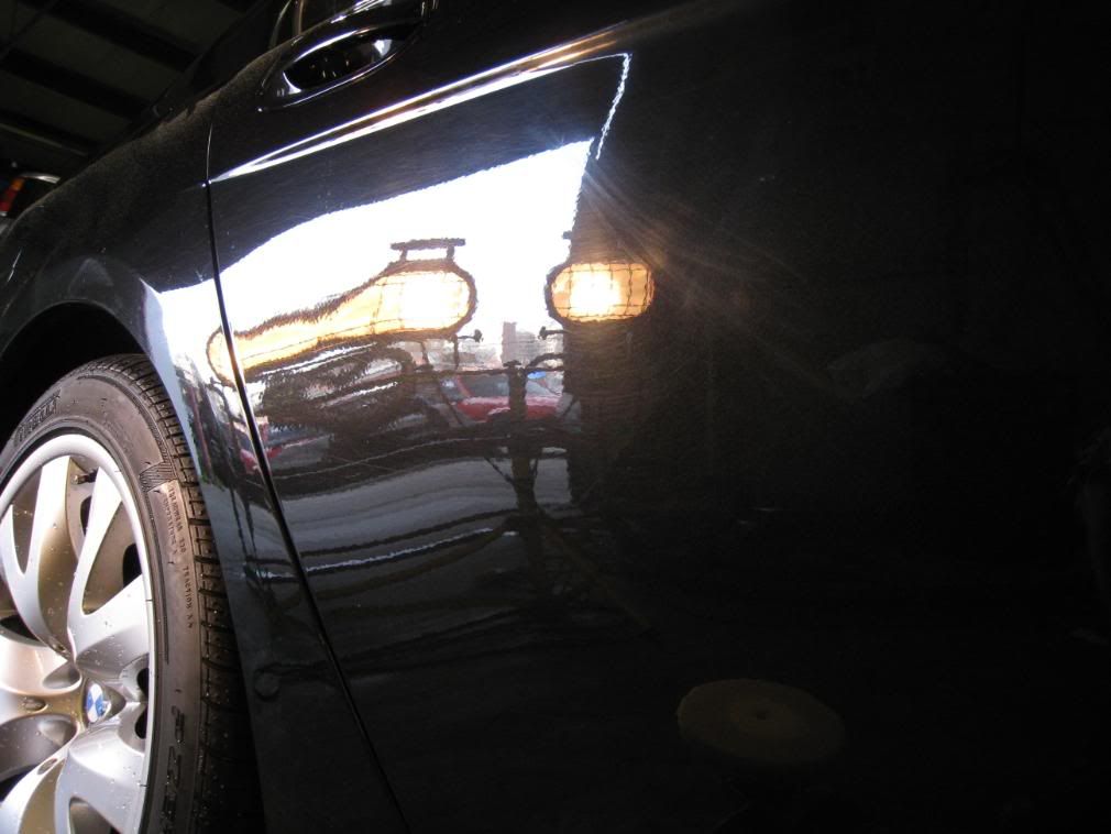

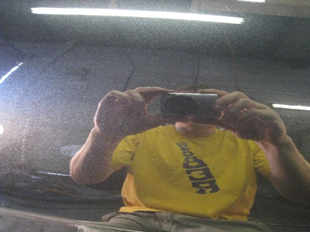

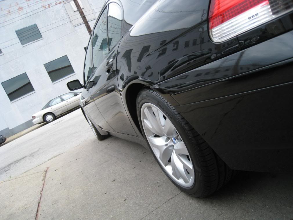

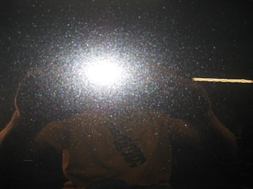

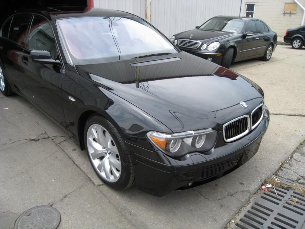

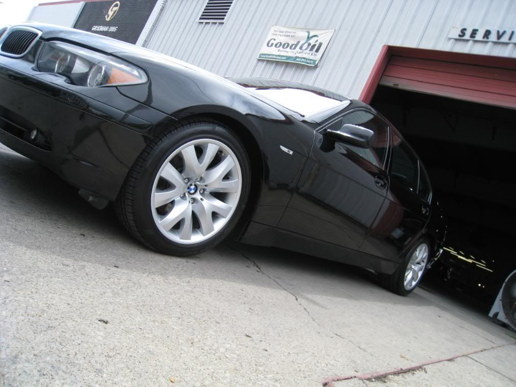

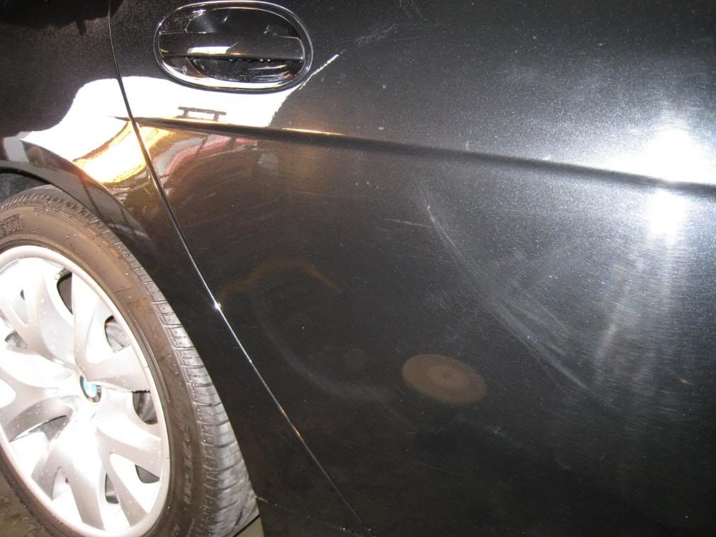

Exterior(paint correction)
Megs 105 with cut pad at 1500 or so
Megs SF Polish with Sonus white polish pad at 800-1800 via Makita
Megs sealent with Megs finish pad at 1000
Megs #26 via PC
Dressings
Engine-quick Shot
Wells- sprayway undercoat and instashine
Tires-Ultrablue II
Any metal or exhaust polishing is done with Carbrite metalbrite and a silvereagle air polisher

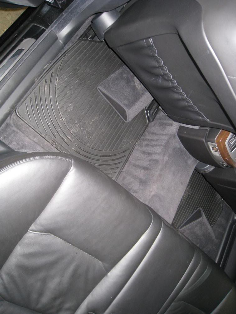

Befores
Paint correction
Engine and interior afters
