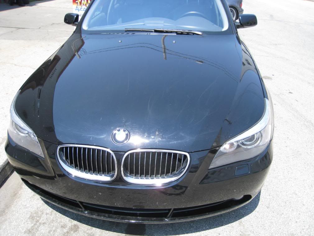

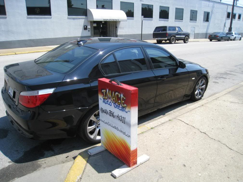

I didnt take a picture of it up close, but this car had a sticker on the window that it was certified DENT free, obviously there was not a Swirl Free sticker anywhere to be found.
2004 BMW 545i 66K miles

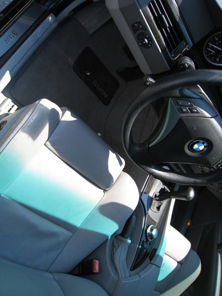

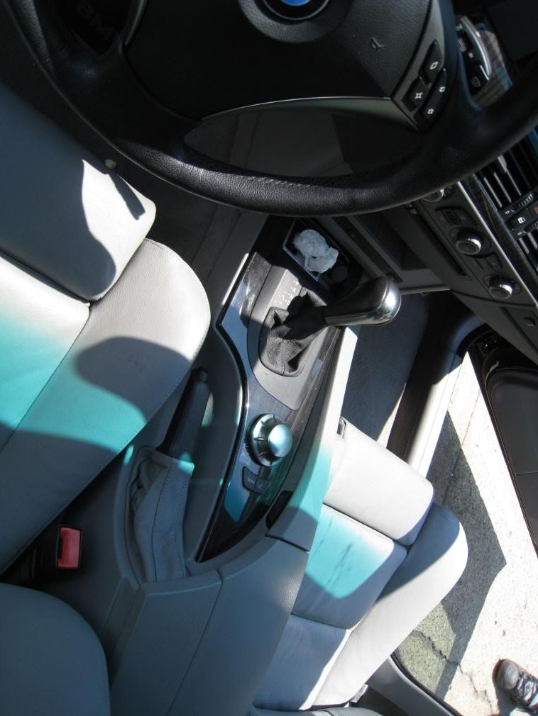

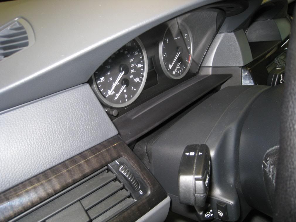

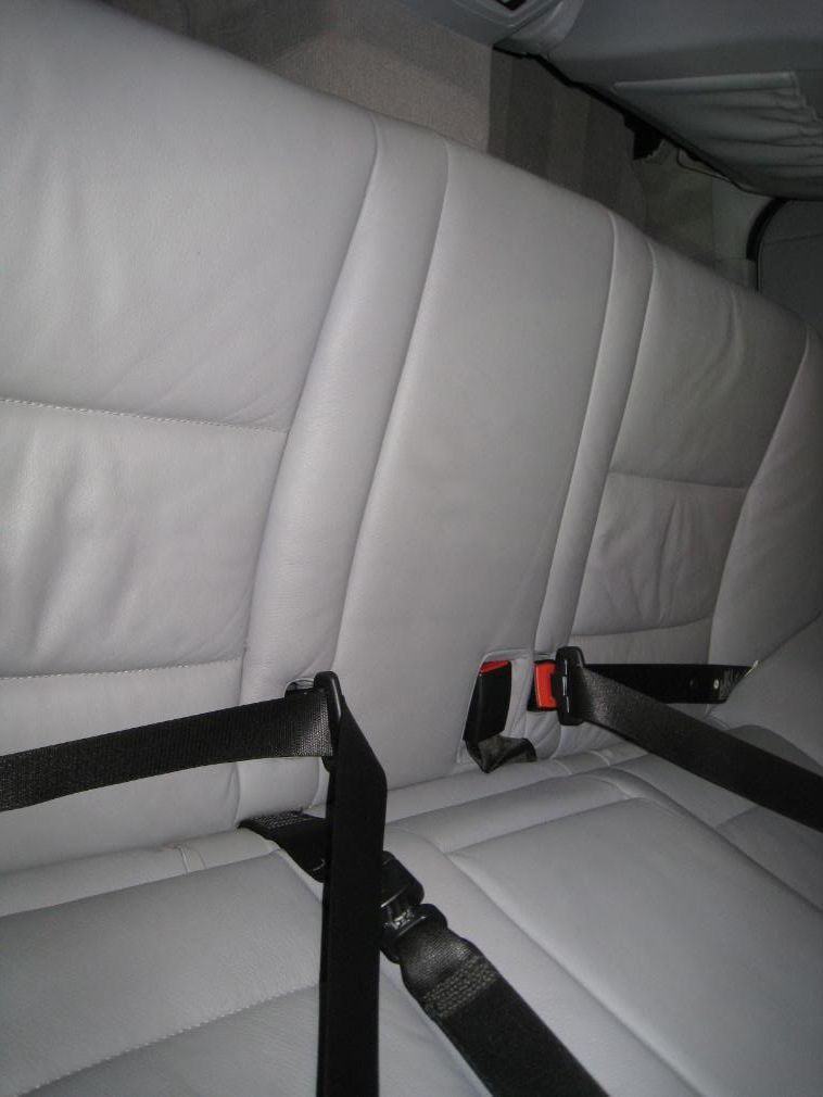

Interior Tools used:
Matco air polisher w/cyclo brush, Various brushes, Shop vac, extractor, Comp air, plastic upholstery tools for crevices, scotch pads, magic erasers
Prepped with the tornador thingy
Chemicals
Fabrik Magik
Blue clean apc
Mr Jinx
Sprayway spot
Sprayway glass
Exterior(paint correction)
Megs 105 with wool pad and finished with the red foam pad
Megs SF Polish with Sonus white polish pad at 1200-1800 via Makita
Megs Speed Glaze at 1000
Megs #26 via PC
