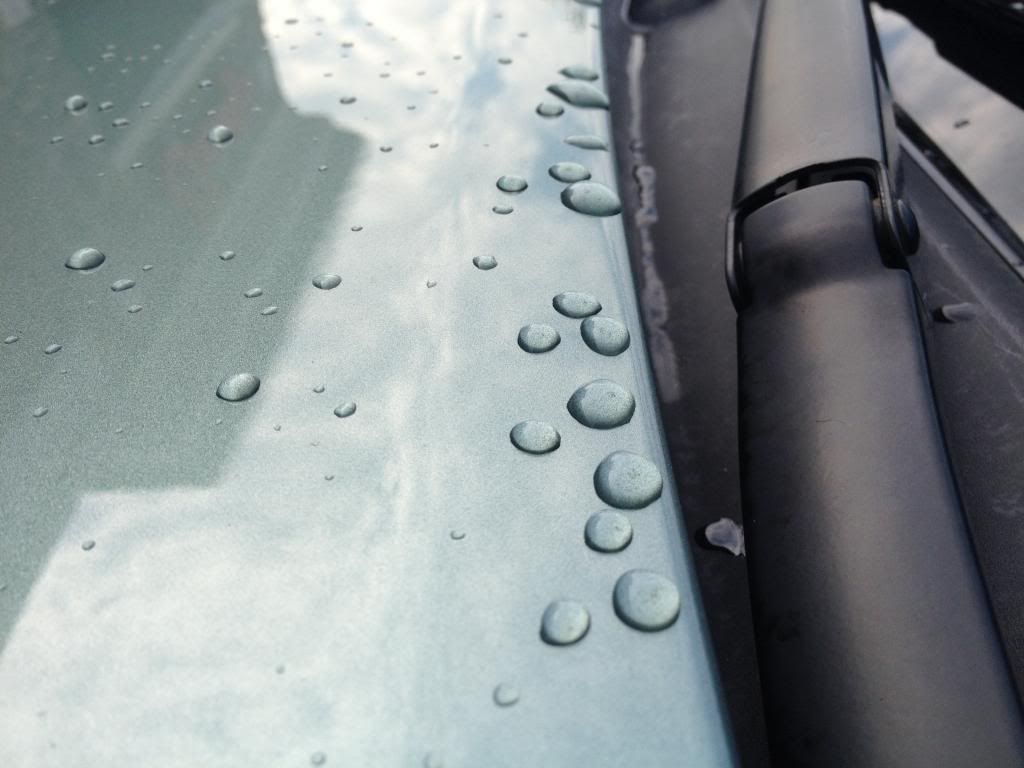

I sprayed the entire front bumper, front half of the hood, side mirrors and part of the fenders down, let it dwell for 2-3 minutes, then used a bug sponge to clean everything up.
Foamed the car down, 2-bucket washed, rinsed, sprayed it down with iron-x, foamed down again and rinsed, speedy prep towel, foamed down again, then final rinse.

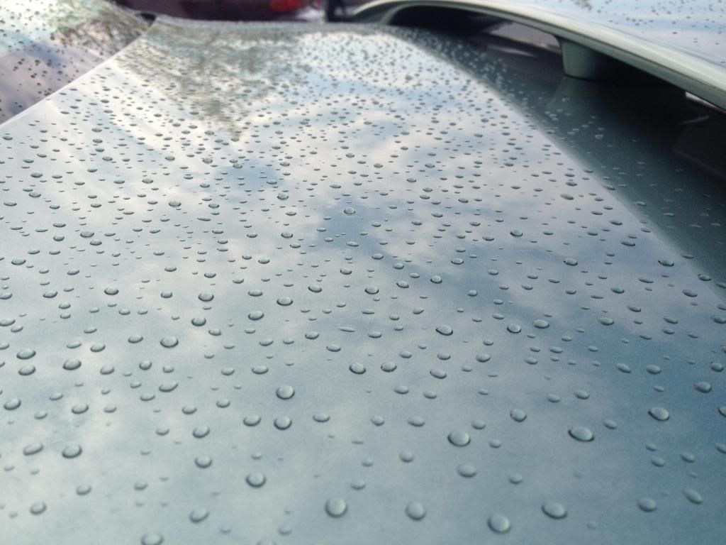

It's easy to work with and apply. The results have been amazing for such little effort it is so apply. I was skeptical at first, because literally all you do is give a panel a spray or two then apply in a criss cross fashion with a foam applicator pad. Then lightly buff the panel to level everything.
