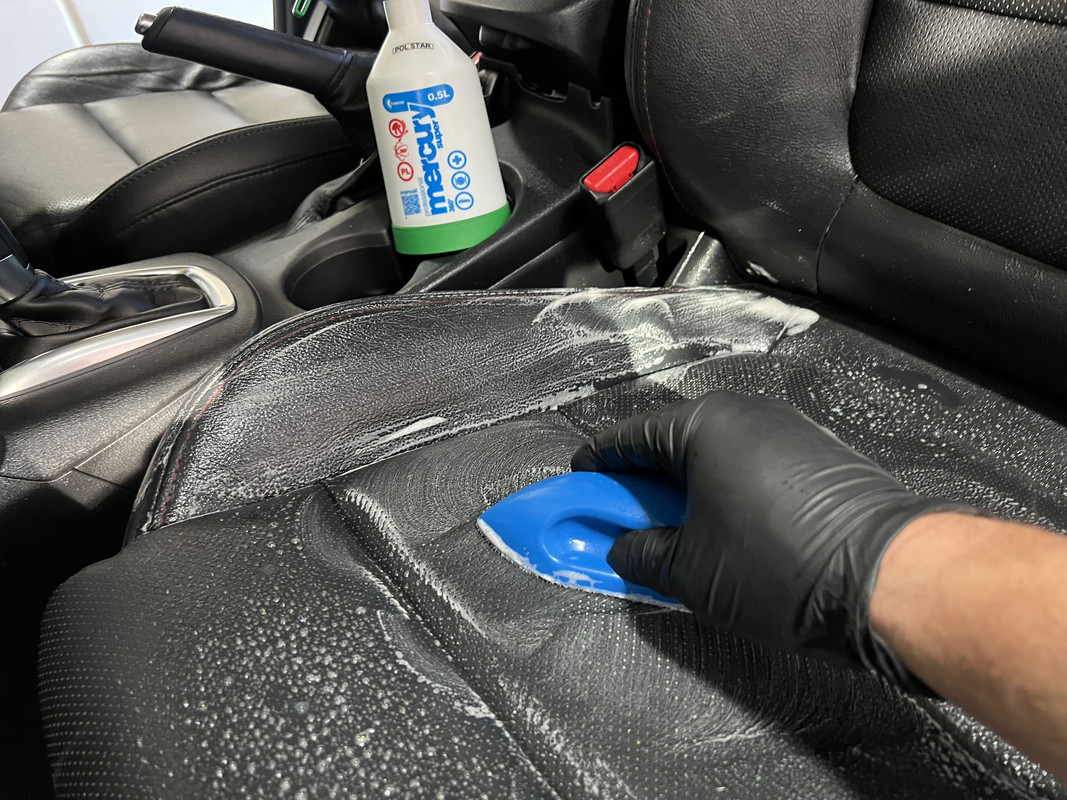

Koch Chemie Pol Star – I primarily bought this as a dedicated fabric and carpet cleaner, but it can be used as an all-round interior cleaner as well. Compared to the ready-to-use products listed here, Pol Star was designed to be diluted. KCx suggest dilutions from 5:1 out to 20:1, I have it mixed at 8:1 for heavier cleaning ability. Pol Star is pH neutral and largely free of scent and colorants. I’ve found Pol Star a very effective bulk quantity leather cleaner, it lathers up with a brush or scrub pad to perfection, then wiping away to reveal a completely matte finish. It can also be put into a small foaming bottle.
Cleaning Ability – 10/10
Protection – Said to offer light “conserving” ability
Finish – Matte/OEM
Scent – Nill
DFB Score – 9/10

Detail Factory boars hair brush -
Detail Factory synthetic bristle brush -
These small brushes come in handy for cleaning pedals or getting crud out of seat stitching and seams.

A scrub pad or mitt can make short work of larger surfaces. These have stiff fabric bristles that deep clean hard plastics and leather.
