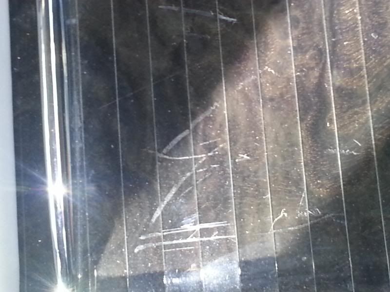

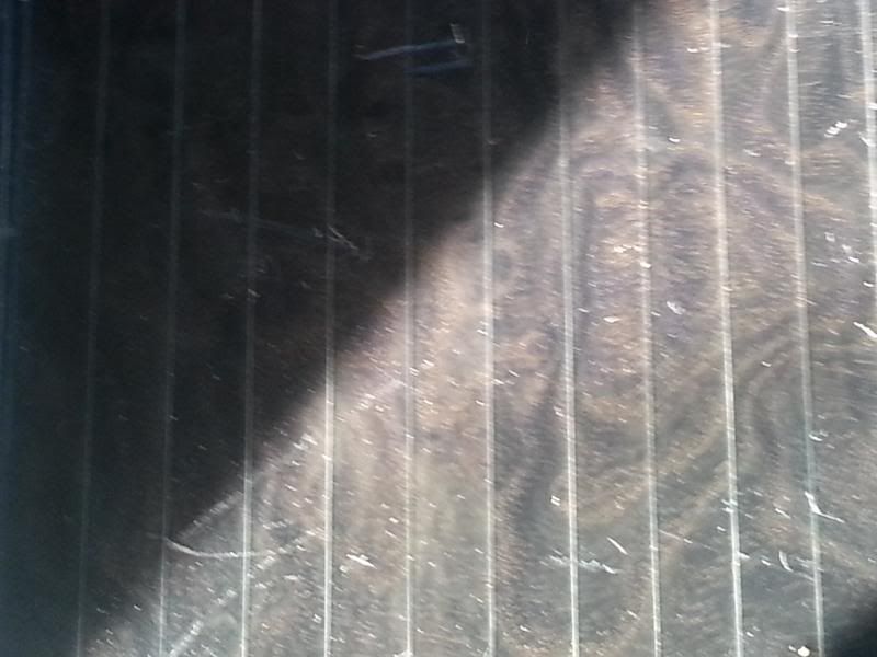

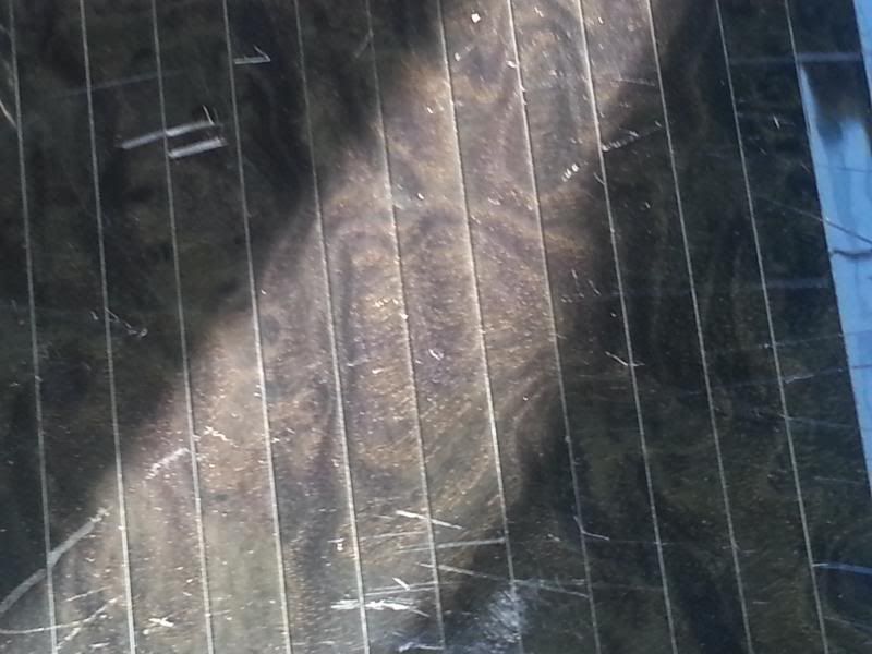

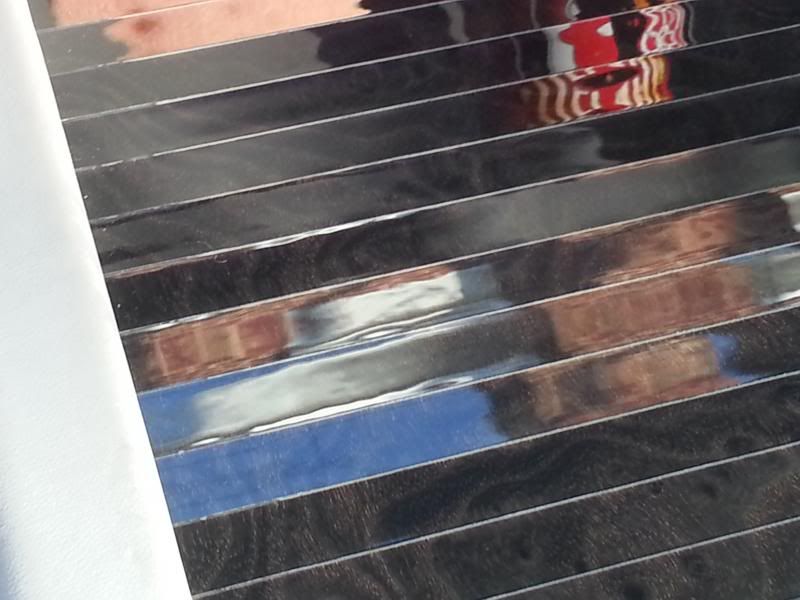

xabo Member Joined Mar 19, 2013 Messages 152 Reaction score 1 Nov 25, 2013 #1 Anyone have an idea as to what can be done/used to remove these scratches on the rear console cover?
allenk4 In time out Joined Mar 12, 2013 Messages 4,845 Reaction score 0 Nov 25, 2013 #2 Wow, those are deep! http://www.autogeekonline.net/forum...ound-something-else-polish-interior-pics.html
T tguil New member Joined Mar 10, 2010 Messages 175 Reaction score 0 Nov 27, 2013 #3 Sorry ….scratches like that are "forever".
allenk4 In time out Joined Mar 12, 2013 Messages 4,845 Reaction score 0 Nov 28, 2013 #4 Come on.....sand w 3000 then compound & polish Post picture after
T tguil New member Joined Mar 10, 2010 Messages 175 Reaction score 0 Dec 1, 2013 #5 Take it to a detailer that does interior repair and see what he has to say.

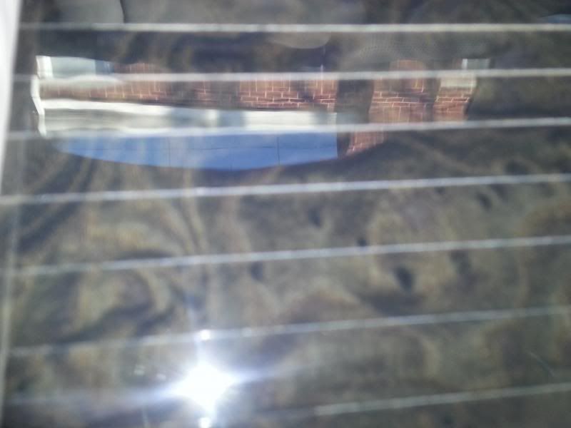

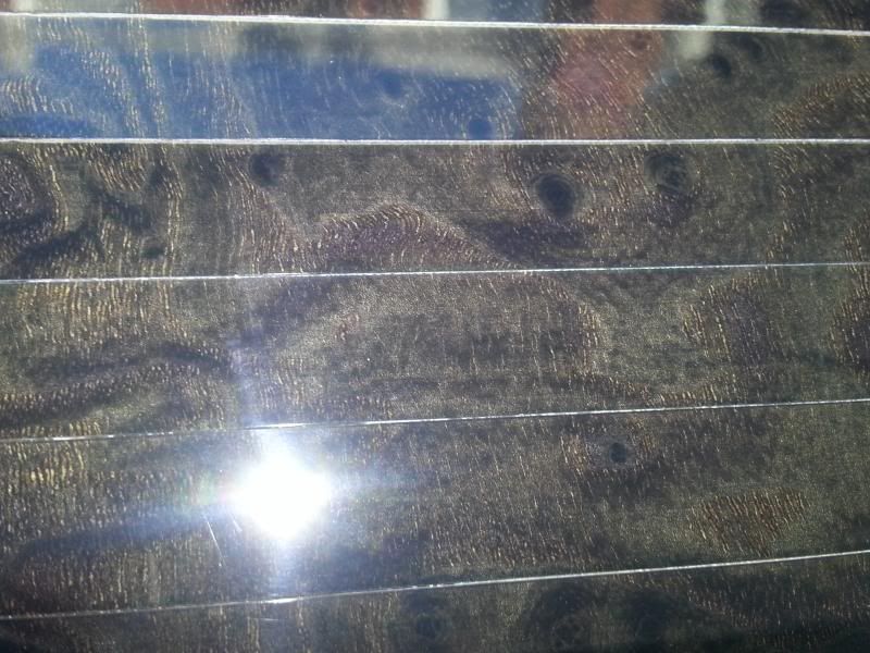

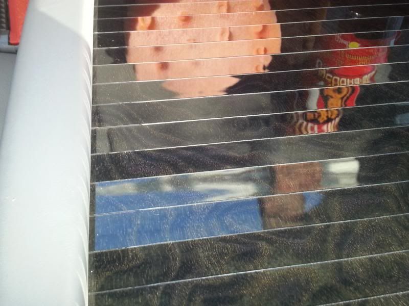

xabo Member Joined Mar 19, 2013 Messages 152 Reaction score 1 Dec 1, 2013 Thread starter #6 allenk4 said: Come on.....sand w 3000 then compound & polish Post picture after Click to expand... WG Uber Compound with 4" Orange pad by hand.........Thanks :xyxthumbs:
T tguil New member Joined Mar 10, 2010 Messages 175 Reaction score 0 Dec 3, 2013 #8 07RS4 said: Awesome job again Click to expand... +1 Guess some scratches in plastic aren't "forever". :xyxthumbs:
