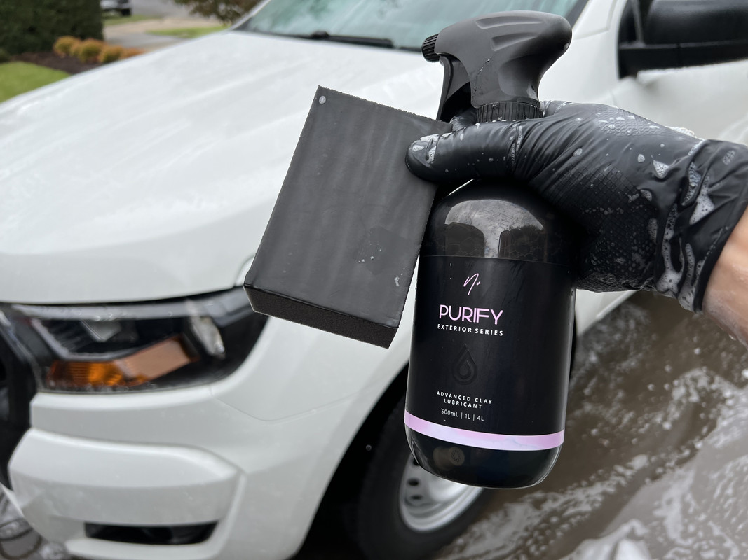

I'm not as experienced as most on here, and I do detailing as a hobby. So I don't pay attention to time, it's more what I am enjoying that counts, and work off that. So I take a clean dry car and spray it down with iron decon. I started with Sonax Fallout remover then when it ranout I bought Bilt Hamber. I have also used Megs UWC when I was needing a bit extra. I let it dwell, then very lightly mist the car with water and let dwell some more. Doing that 2 or 3 times to let the iron do as much work as possible. Then rinse off fully and wash the car. Then I take a bucket of clean, soapy Megs Hyper Wash and clay with synthetic mitts and sponges. Dry and start compound/polishing.
Again being a hobby, when I have been striving to have the best look of the car at the end, before I started compounding, I have clayed again with a Sonax clay pad and glass cleaner as lube.
I have combined the iron and clay process as one step in the past, but I didn't care for the method for a couple of reasons -
Firstly, the stink factor. Even wearing gloves, I really don't like the smell of iron removers. NV Purify, which is sold as an iron removing clay lube, it smells the least offensive but still not nice. You end up with that stink in everything, your clothes, your towels, your clay media.
Secondly, I would only be using this method if the car is only mildly contaminated on a car you love, or if the paint is jacked and going to be polished straight after. My reasoning here is that you end up rubbing all that contamination into the paint.
