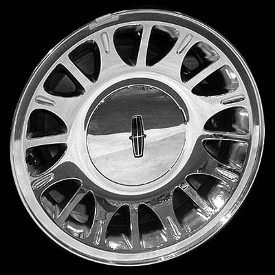

Does the P21S work on plastic plated chrome? My wheels are chrome, but the center caps are plated plastic.
EDIT: Does P21S offer a chrome wheel cleaner? All the ones I see are for alloy wheels.
Yes it cleans plastic chrome. I just did my plastic grill, the applicator turned a little black probably from the build up of waxes, QD's etc. The applicator washed right out. I also use it on my uncoated chrome wheels.
