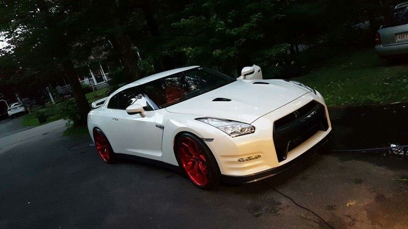

For as long as I have been at it there are still firsts that come along. This time is a full wheels off and coating on a new white 2016 GTR. I did confirm that this particular model has the scratch shield "self-healing" clear coat.
There is definitely a challenge to polishing out this type of clear but it can be done using some interesting techniques.
Really looking forward to doing this vehicle! Little teaser picture from the owner.

Don't overthink the correction process here... we've worked on several GT-R's that have the scratch shield sticker on them and all of them reacted to normal polishing technique/products/processes just the same as any other paint. I have read some of the "horror stories" of GT-R paint being very difficult to polish, so perhaps we've been lucky, but I would recommend starting with the basics and adapting to more non-traditional processes only if needed.
You know the saying... work smarter, not harder. Don't over complicate things :)
