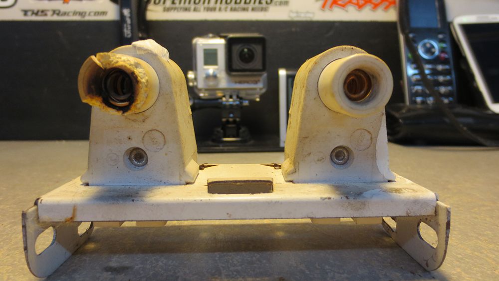

Flipped the wall switch for one bank of the florescent lights and one of the double 8ft fixture tubes started flickering. My first thought was I'm loosing a tube, no big deal I've replaced dozens through out the decades.
I'm walking under the light heading for the storage room to get a replacement... I hear crackling like a welder sound. Looking up the spring loaded porcelain connection is arching like crazy. I'm like what the... then the porcelain burns through and the tube falls swinging down! Jumping out of the way, closing my eyes... the tube misses my head clipping my elbow knocking it on the hood of my truck :eek:

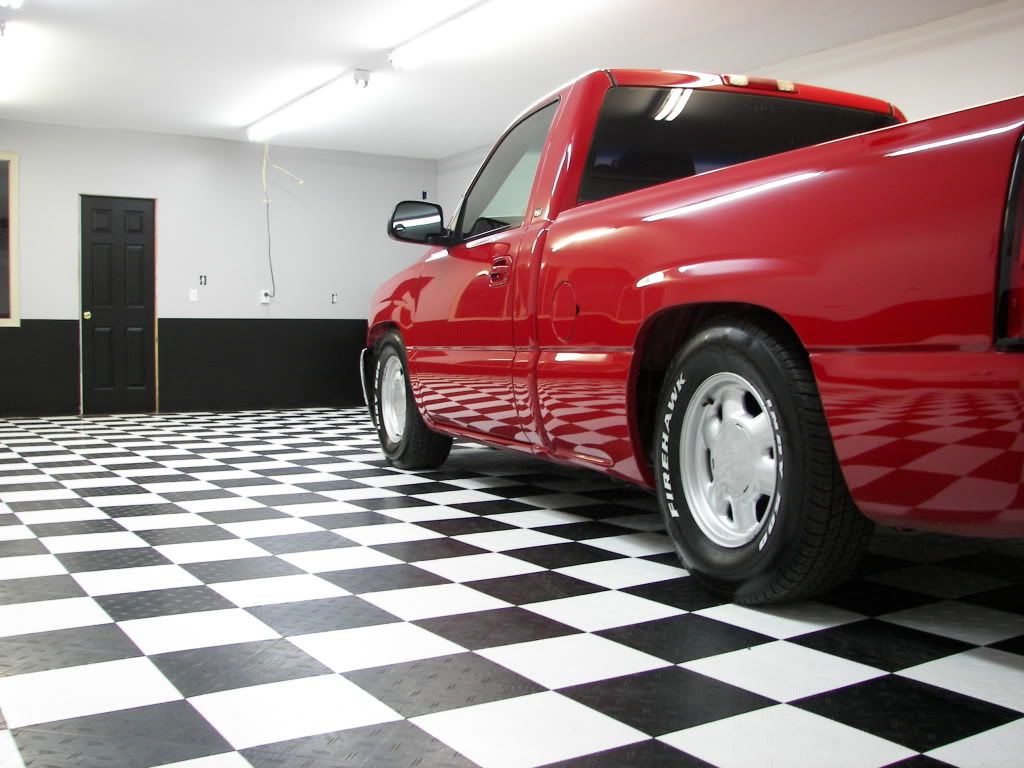

Talk about close call! Those flourescent ends do get old and brittle. Looks like yours was a little loose and burned over time. In the future, you may want to install those clear diffusers to catch a broken bulb. Better yet, perfect excuse to replace with a T5 setup to match your awesome garage!

Bob I didn't understand your post until I saw a pic of the lamp holders. They do look exactly like "tombstones" lol
I had another matching fixture in the storage room with a bad ballast. Robbed the tombstone assembly and popped it right in place of the burnt one. Now I can see again :D

Any idea what would cause that much heat to toast the 'tombstone' like this?
Just can't remember ever seeing one like that without a 'super short' somewhere in the fixture.
I would say it was probably just high resistance in the contact--it's in a garage where the environment is suitable for some dampness/corrosion--plus those contacts aren't exactly the highest quality to begin with--either in the fixture or on the bulb.
I've been climate controlled about 8 years but I did have these hanging in here for over 25 years lol. They were given to me and no telling how old they are!

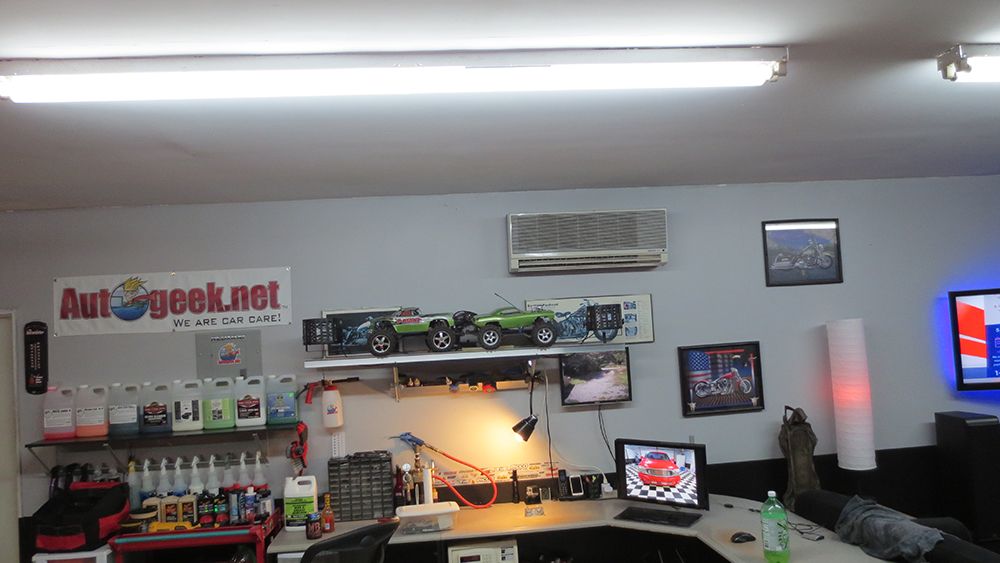

Kind like to stay with 8' fixtures anyways. Started out with 6, now have 5 (removed one over the bar) and would like to only have 4 total when I buy new ones. If you look at the pic above you'll see the one over the tv, sofa area. It doesn't do much good there lighting vehicles. Before I did carpet, tv, bar etc. six fixtures made sense because I could pull multiple vehicles inside to work on.
6 old double 8's was pretty bright back then... but now it's time to change though.
