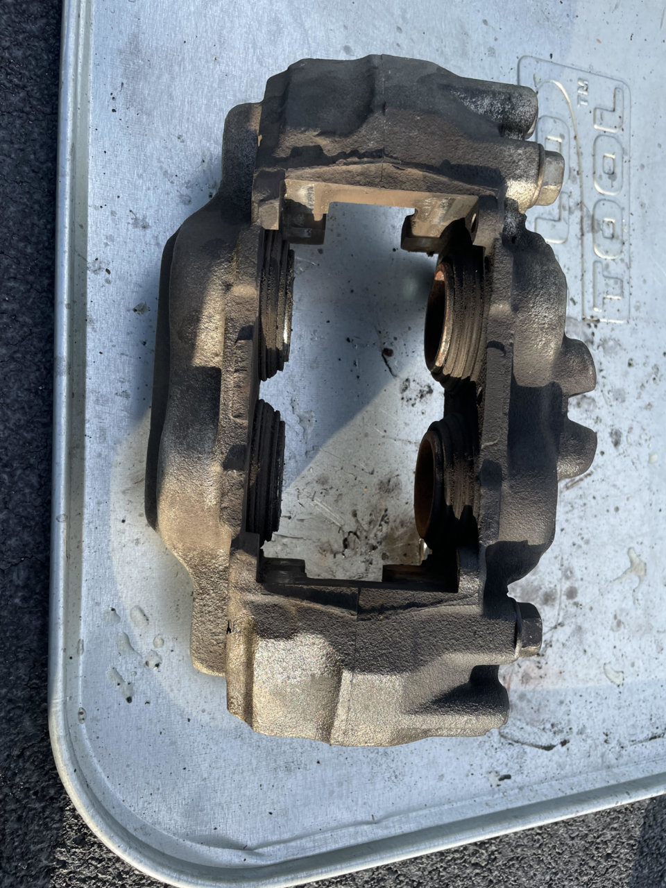

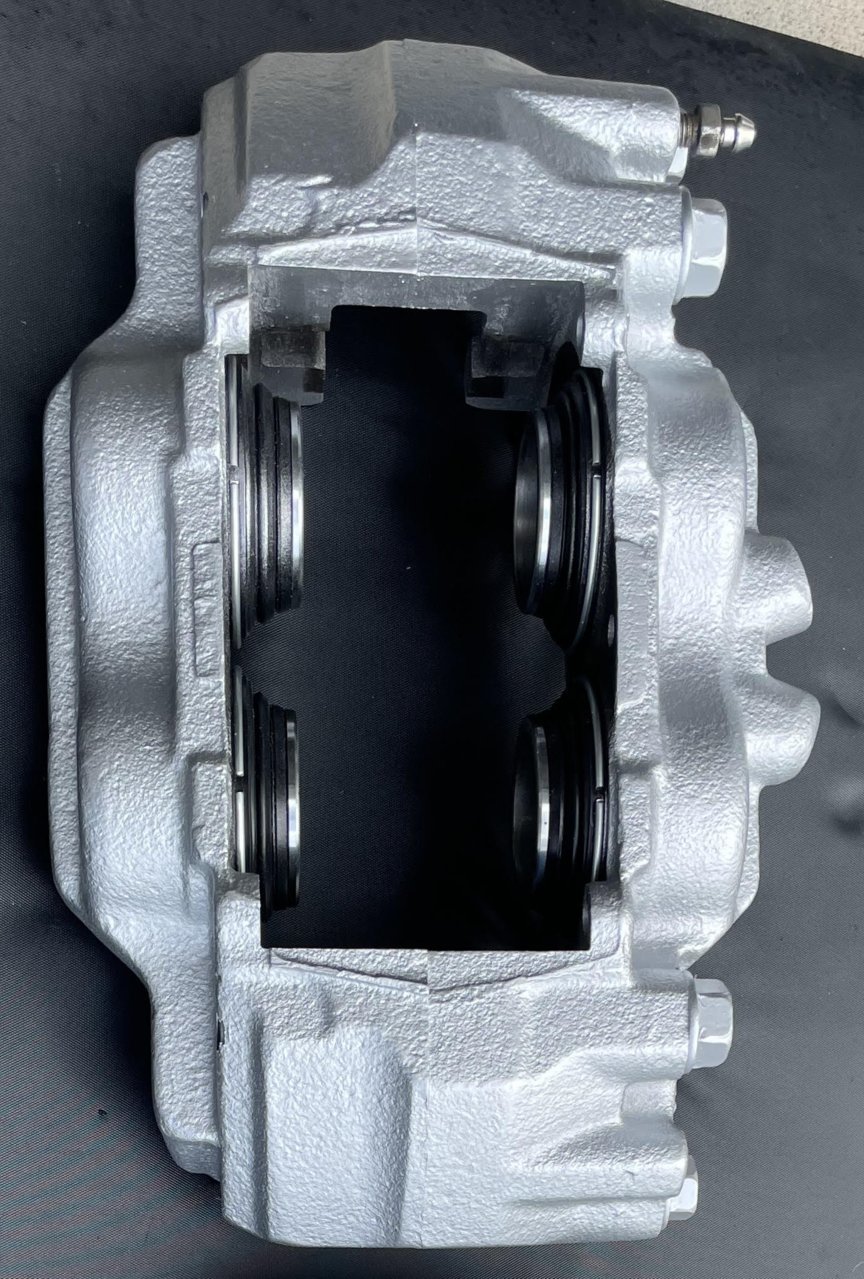

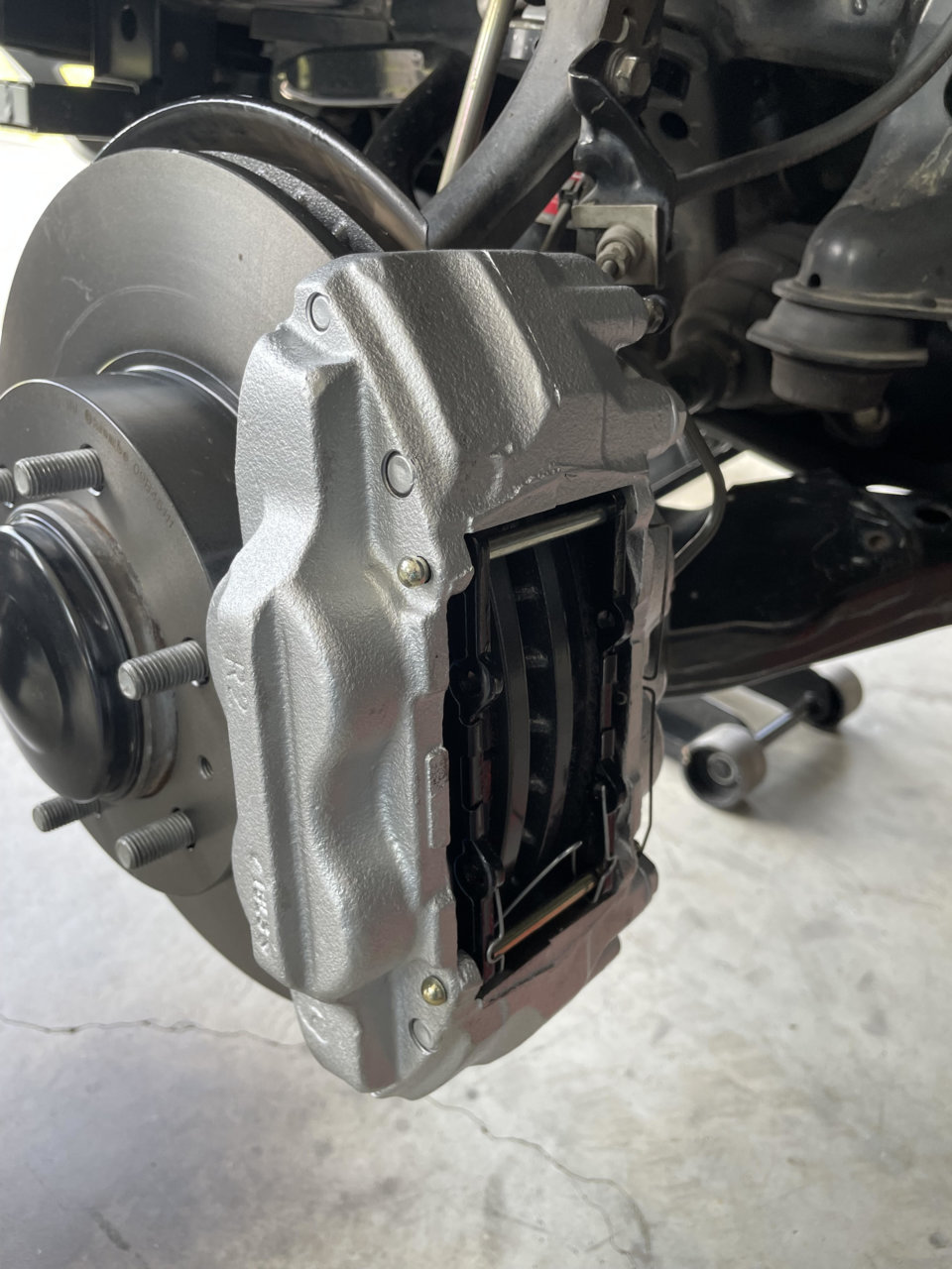

The silver finish you see on many OEM calipers is a zinc plating not a paint or powder coat that can be easily cleaned. I recently rebuilt the OEM calipers on my Tacoma & painted them with silver Duplicolor caliper paint to make cleaning easier in the future.
Oof! That looks like a lot of work, but the results look really good. Duplicolor sprays on, doesn't it? Why did you choose Duplicolor over G2?
Yes, it was the spray version. I wire brushed, lightly sanded (220 grit) & then cleaned the caliper with brake cleaner before applying the paint (3 coats). Also made sure to cover the piston area to avoid the paint getting on the new seals.
I went with Duplicolor since it was available locally whereas I needed to order G2.

Great result !
